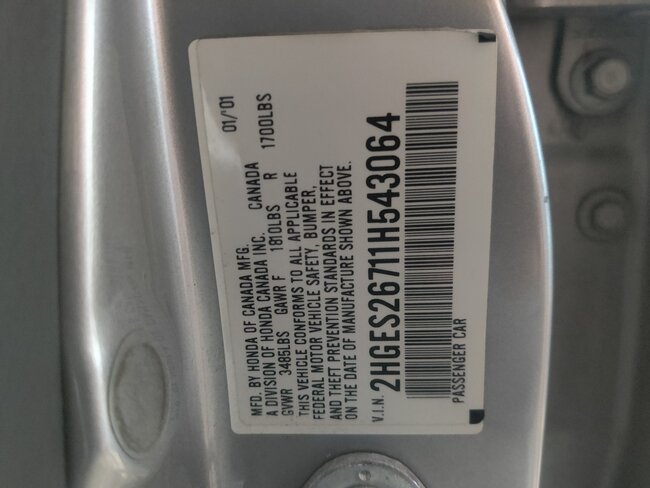

Someone says the transmission type could be on the driver's side door. Mine does not have the info:
Thursday, September 26th, 2024 AT 1:59 PM

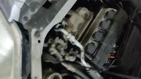

Pictures:
Thursday, September 26th, 2024 AT 2:11 PM

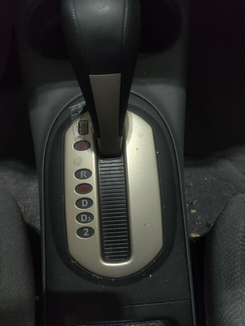

Gear Shifter
Thursday, September 26th, 2024 AT 2:25 PM

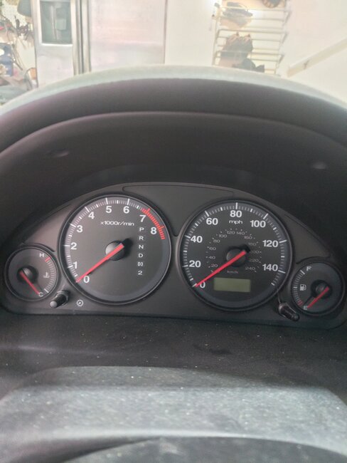

And front panel

You're not going to believe this. Your vin number takes me to a manual transmission vehicle. Ugh! Have you owned the vehicle since it was new?

I drove manual transmission car before. This one isn't manual.
I bought it from a close friend. He is not handy and cannot even change engine oil so he cannot modify the car. He is the original owner and if someone else made big changes to the car, he would have told me that.
I thought it over. The chance that two dealers checked it wrong is not big. They told me it is a non-cvt four speed automatic transmission car. So I think I can use either the Castrol or Valvoline fluid to flush the transmission.

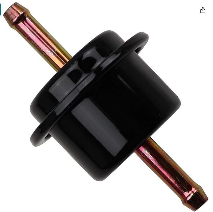

I also watched a YouTube video that showed an external transmission filter located under the air filter box (see picture), but it was for a 2006 Honda Civic. I plan to remove the air filter box to check if my car has one as well.

I checked and there is no external filter for the 2001 model.
