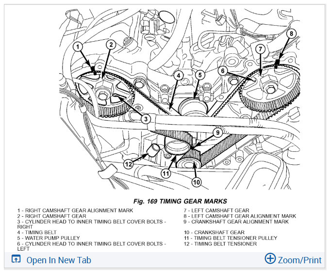

I pulled a good motor from 2007 pacifica to put in this car. Changed all sensors, changed timing belt prior to installation. Once installed the car will start and run but only if giving it gas. Hesitates on idle and dies. When driving no power won't get over 40mph, tranny shifts slow. I rechecked the timing, crank gear was about 3/4 turn forward, I repulled the belt reset time. I only moved the crank 1/4 turn verified TDC on #1 plug reset belt. Cranked it over a few times timing was still good. I've ran the car some since then timing is still dead on. The only cel I get is idle air temp sensor. I changed that still get code. Sometimes the CEL will flash for a minute then stop. Fuel pressure is 55psi. I've changed plugs which keep ending up black on 1 3 5 cylinders. Checked fire to all coils and checked all injectors are clean and firing fuel. Changed intake gasket as well. What else am I missing? Could me only turning the crank to complete that 1 revolution put it 180 out of time?

It can be the timing belt is off, so let's check that against the markings below. I just checked and the 07 engine has a chain. Is that what you meant? Here are the marks for the timing belt engine (05). I am wondering about the compression on 1, 3 and 5. Once you recheck the timing marks let's do a compression test on those cylinders, this guide can help:
Check out the images (below). Let us know what you find.

I did confirm the timing marks are correct. The 2007 I pulled motor out of was a belt. I was reading a forum this morning and someone had a similar issue turned out to be alternator. I had it tested and sure enough it's bad. In the process of putting motor back together. I have another alternator so having that checked this afternoon. Will update soon.
