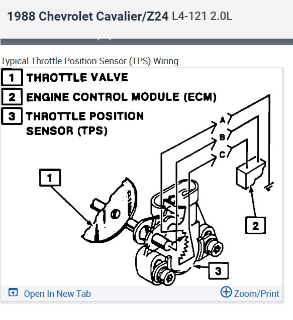

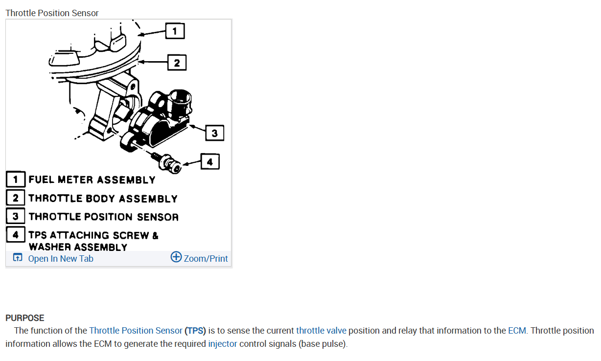

This sounds like the TPS is bad which was common on these cars, I would run the codes as well.
https://www.2carpros.com/articles/buick-cadillac-chevy-gmc-oldsmobile-pontiac-gm-1983-1995-obd1-code-definitions-and-retrieval-method
Here is the TSP location so you can check it out. Check out the images (below). Let us know what you find.

I just recently changed the TPS.

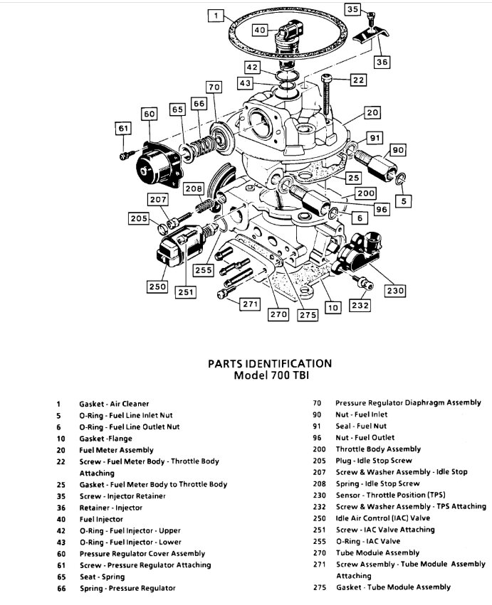

Bought new fuel injector from rockauto car still doesn't idle right. I observed while running new fuel injector isn't spraying but more like pouring fuel into intake.
Apr 23, 2025 at 6:57 PM
  • 54,511 POSTS
Sorry, I thought you got it fixed. I would make sure the ECM grounds on the engine or good, also did the old injector do the same thing? You might have a defective injector.

Fuel injector was broken so I replaced it from rock auto car idles rough has a miss at low RPMs runs good at higher RPMs observed while running fuel injector seems to be dumping fuel instead of spraying could this be weak fuel pump? How do I check fuel pressure?

Also throttle body is blacked up.

Yes clean the throttle body for sure. also, i'd check the fuel pressure, regulator, and pump if cleaning the throttle body first doesn't help.

Where is the fuel pressure regulator located on this car?
Apr 29, 2025 at 12:07 PM (Merged)
  • 54,511 POSTS
Here is a guide to help you check the fuel pressure. I have seen defective fuel injectors cause the is problem due to resistance issues.
Fuel Pressure .................... 62-90 kPa (9-13 PSI)
The fuel pressure regulator is in the injector throttle body. Check out the images (below). Please let us know what happens.
