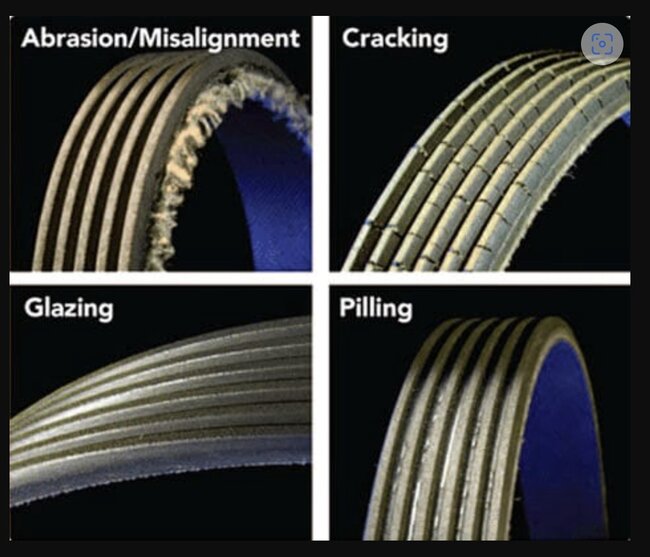

I would also check your belt. I am adding an image of some common belt problems.

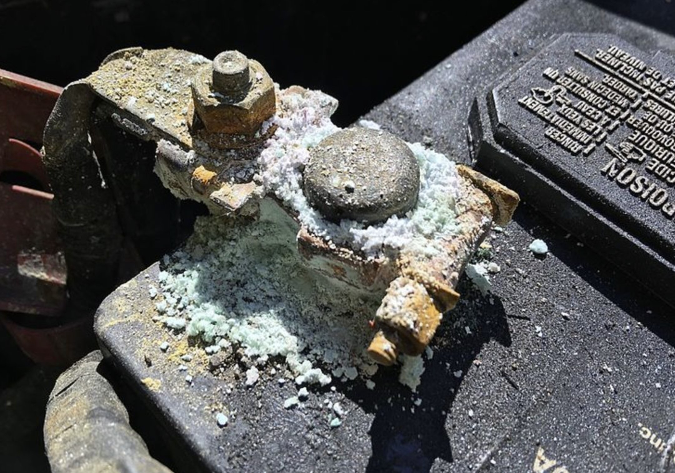

Also, check your battery terminals and make sure they are clean.
While once the car is started the vehicle runs off the alternator, corroded battery terminals can put more strain on the alternator and cause premature failure.

Please check your belt for wear using the attached chart and check your battery connections for corrosion. If there is any make sure to remove and clean.
