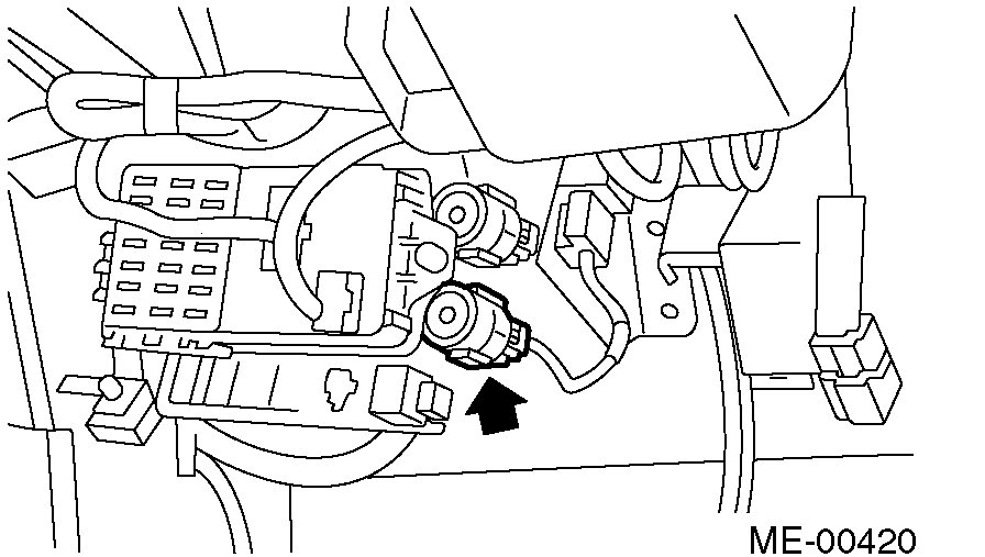

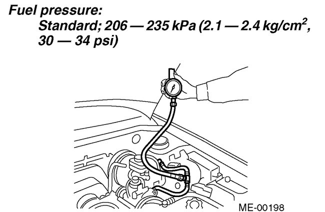

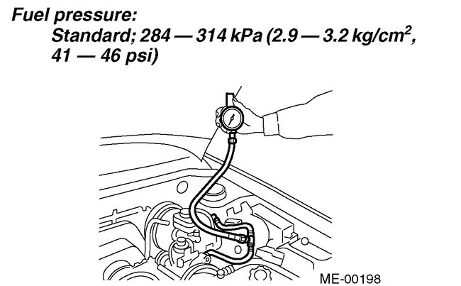

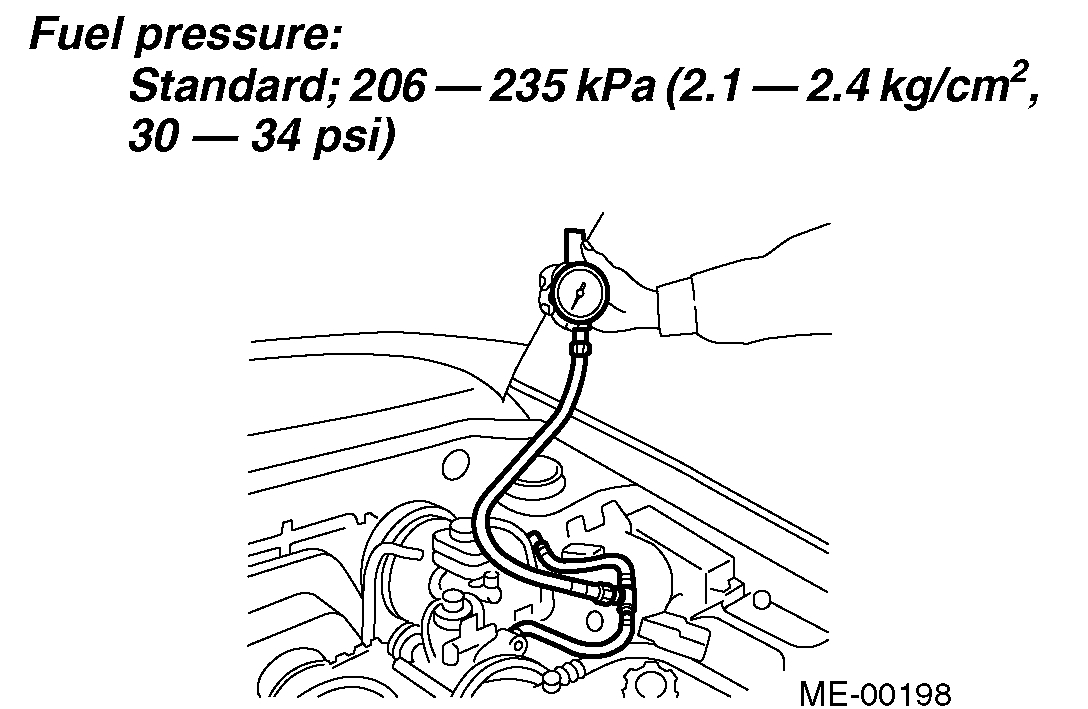

You aren't getting fuel to the engine. Although you hear the pump, it may not be producing pressure. The first thing I would do is check fuel pressure. Here is a link showing how in general it is done:
Here are the specific directions for your vehicle. The specs are included in the directions and the attached pics also correlate with these directions.
Now, if you find the pressure to be within spec, then we need to check for an injector pulse. Here is a link that shows how that is done:
https://www.2carpros.com/articles/how-to-test-a-fuel-injector
Since it starts on starting fluid, either the pressure is bad or there is no pulse to the injectors.
Let me know what you find.

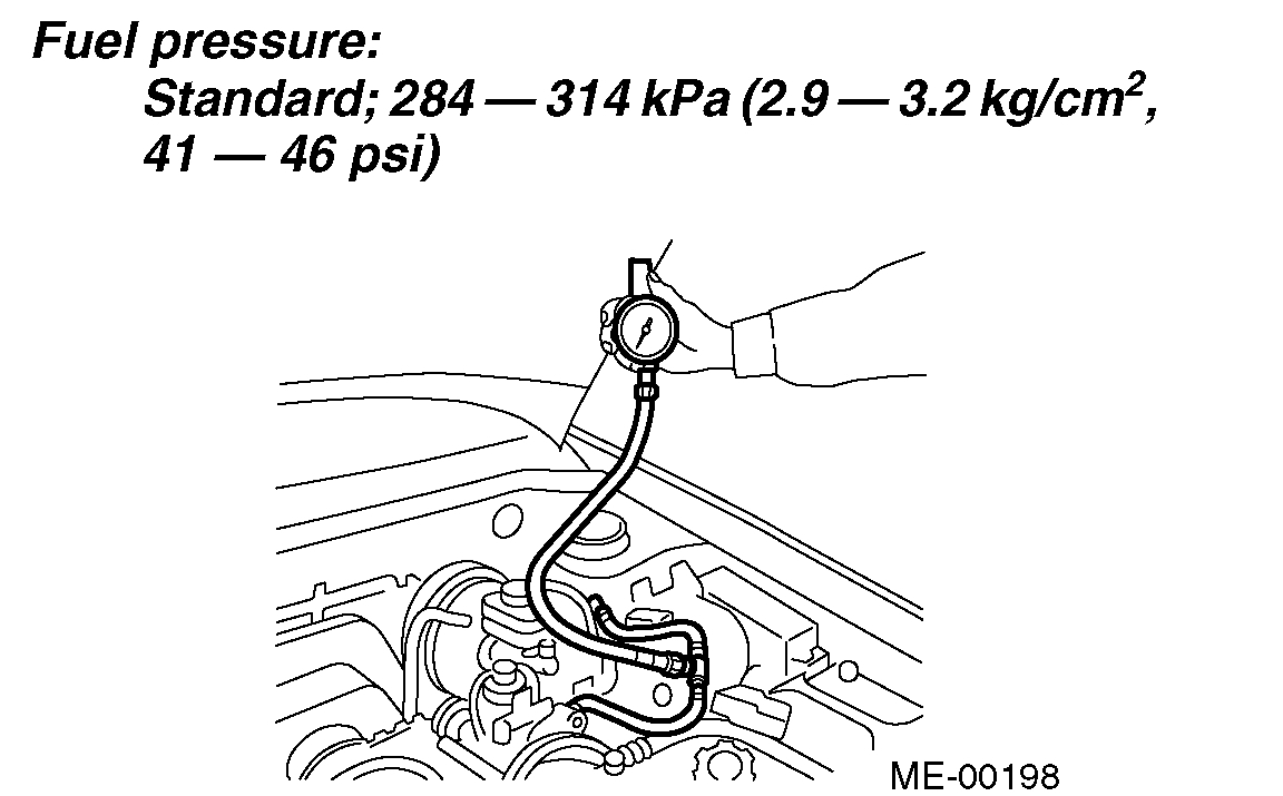

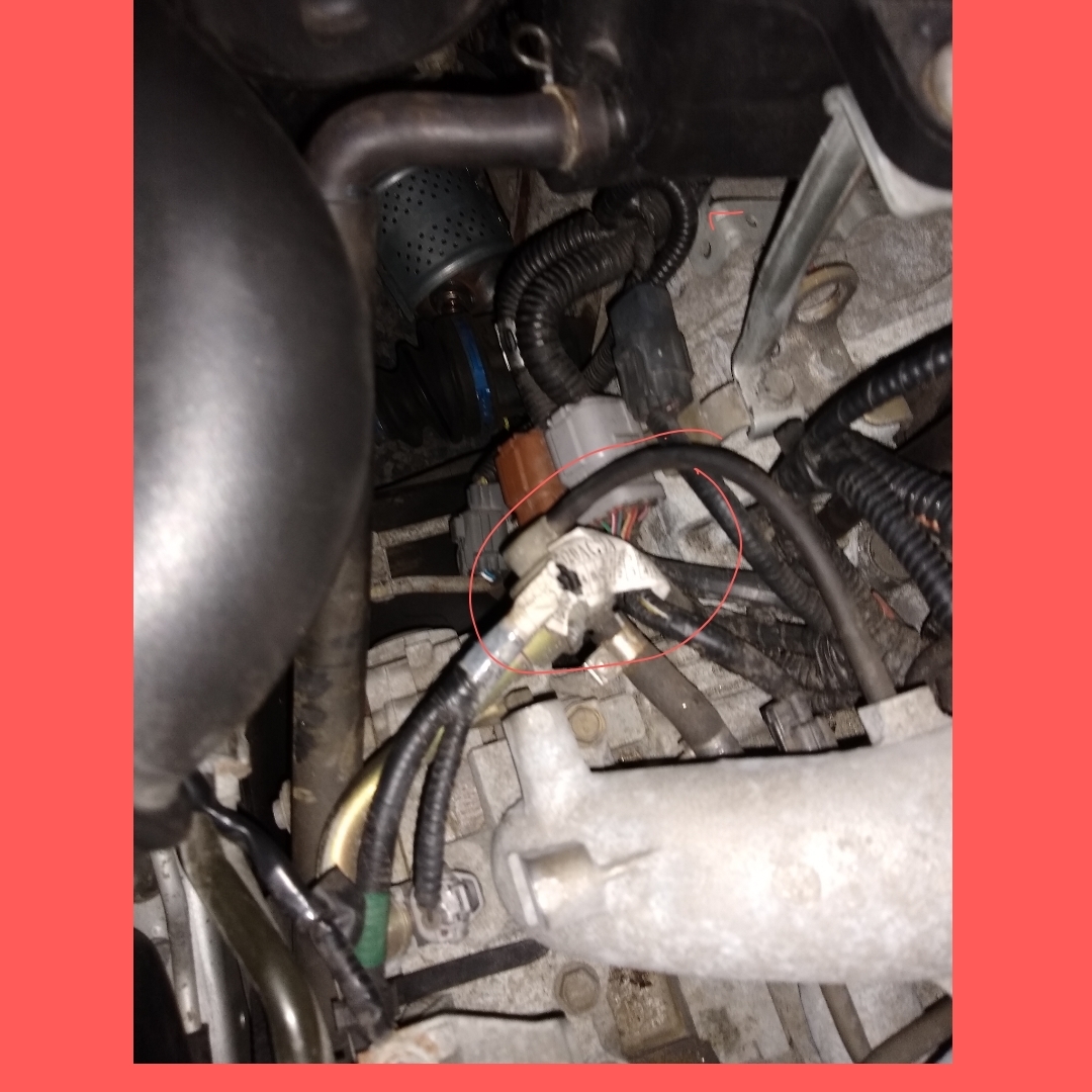

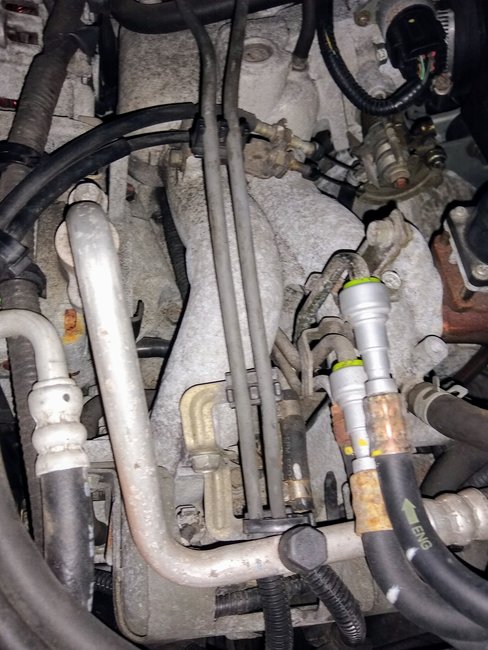

I do not have a "Test Port" on Fuel Line.
I understand I need to "Tee In" to Fuel Line, but I do not know where to put Tee.
Here are images of left and right fuel rail where do I Tee in for Pressure Test? Pressure Regulator is circled in Red.

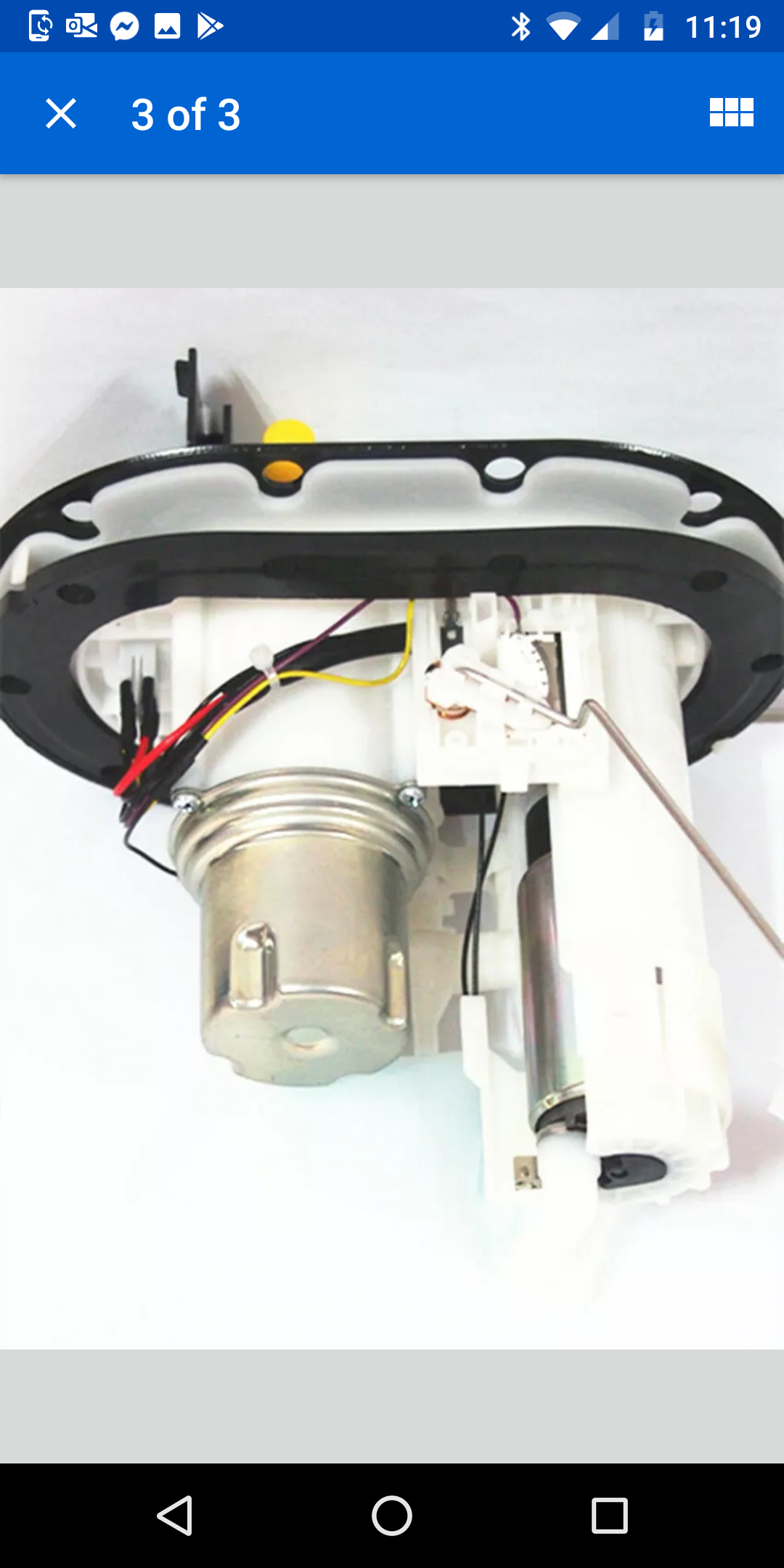

Fuel Pump Assembly.

You are correct about the T. There should be a quick connect between the fuel rail and the full supply line. That is where I normally do it. I disconnect the two and install the T at that point.

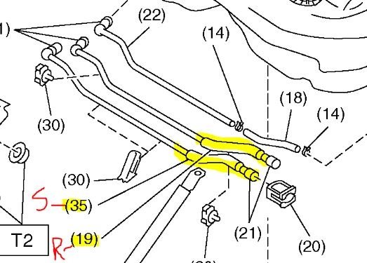

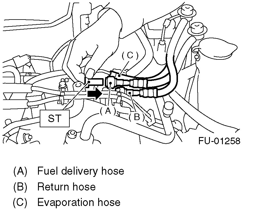

The filter could be totally plugged, but that usually isn't the issue. Also, air wouldn't cause this. It wouldn't cause a blockage. I thought the fuel filter was new. Is that correct? Also, are you sure you got everything connected properly as far as the supply and return lines? See the pic below. Also, some filters can be installed backwards.

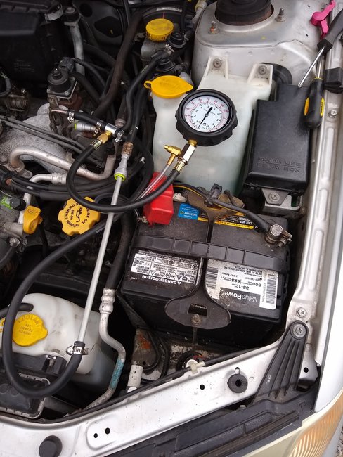

I removed fuel filter and retested.
0 PSI
Will get new pump and filter and strainer and retest.
Here is image of pressure test setup.
Monday, September 30th, 2019 AT 8:24 AM
  • 110,192 POSTS
It looks correct. If nothing is plugged, the pump is running, you have everything connected correctly, and you have no pressure, the pump must be bad.
