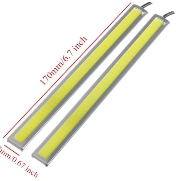

I connect one end of 12 v led cob light and other end to ground. Activated the turn signal circuit, surprisingly, the led does not come on at all, which is taking me to verify out that the voltage drops is only 9 V! Why?
The led cob light when connected to the battery directly is lighting up as it should be.

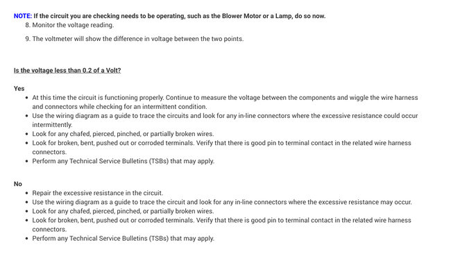

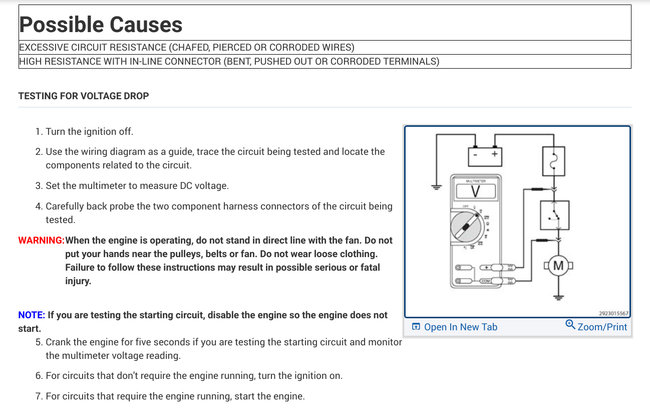

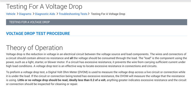

This is because you have unwanted resistance in the turn signal circuit somewhere. The best way to test the circuit and find out where the unwanted resistance is is by the voltage drop method. Unfortunately we do not have your vehicle in our reference material, so I can not get you an exterior lighting wiring diagram of your vehicle, but I can give you a guide explaining how to test the circuit with the voltage drop method. I have included this in the diagrams down below. Please go through this guide and get back to us with what you are able to find out.

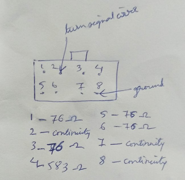

With key removed from ignition slot.
Some values of resistances of each wires of the coupler individually.
With one end of multi-meter connected to each wire individually and other end of multi-meter to ground. Here are the results:
Pin 1, 3, 5, 6 has same resistance of about 76 ohms.
Pin 4 has 583 ohms.
Pin 2, 7 and 8 show continuity with the buzzer sound coming on.
And, pin 2 is the turn signal wire.
Pin 8 is the ground wire.
Any more ideas where the 3 v is missing?

Hello again,
Testing for resistance using the Ohm's setting on your DMM is not the best way to find out where the problem is, voltage drop is the way to go here. With voltage drop you will be able to pinpoint the exact spot in the circuit that is consuming the 3V that isn't making it to the bulb. Please check out the guide that I sent previously. Basically what you are doing is powering the circuit, turning the turn signal on and then with the DMM in VDC setting, 20V range, put the positive lead on the front part of the piece of the circuit that you want to test and the negative lead on the back part of the piece of the circuit that you are testing and read the voltage that is being dropped across that piece of the circuit. Lets say you want to test the voltage drop across an electrical connector. Put one lead on either side of the connector. If the connector had a bunch of corrosion on the pins and wasn't making a good connection, the voltage drop might be around 2.5V. That means that the electrical current is having to use 2.5V to push the current through that corroded connector, leaving 9.5V to drop across the circuits load. Any piece of the circuit that you do a voltage drop test on shouldn't be above 0.1V. If it is then there is a problem in the piece of the circuit that you just tested and needs to be fixed. Pretty cool, huh. Let me sell you on voltage drop one more time. Let's say you have a piece of the circuit that you are testing has all of the strands of the wire frayed apart except for 1 strand that is intact. Now let's say you are using the DMM in Ohms mode to test for continuity. The DMM would register that there is continuity and everything would seem okay. You can't see the frayed strands of the wire because they are under the wires insulation. But, if you do a voltage drop test across the same piece of the circuit, you would probably get a voltage drop of 9V, or more. Obviously a major problem. Please go through the previously sent guide on how to do voltage drop testing and get back to us with what you find out.

It's aftermarket led strip, 12 v, 2 watt.

The three bulbs, turn signal bulb, side repeater bulb and the led strip are connected in parallel at the same time whose specs are 12v, 21w, 12v, 5w, and 12v, 2 w respectively.
