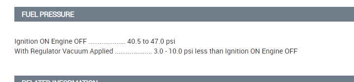

When I turn the key it turns but will not start or if it starts it will cut back off after a few minutes.
Monday, March 8th, 2021 AT 7:10 PM
MECHANIC
18,907 POSTS
Sounds like the fuel pump is failing. Here is a guide that will help get us started:
https://youtu.be/dCjmRL3p4Cs
I would suggest we start with checking the fuel pressure using the guide below.
I attached the spec below for you to compare your vehicle too.
Let us know what you find. Thanks
