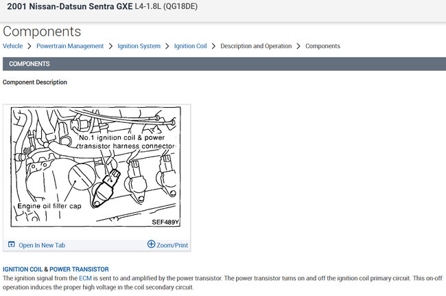

Car starts but the RPMs fluctuate and backfiring?
2001 NISSAN SUNNY
200 MILES • 1.3L • 4 CYL • 2WD • MANUAL
PARINSHAMEEL
Car starts but does not idle and sputtering.
Nov 12, 2024 at 7:39 AM
  • 54,520 POSTS

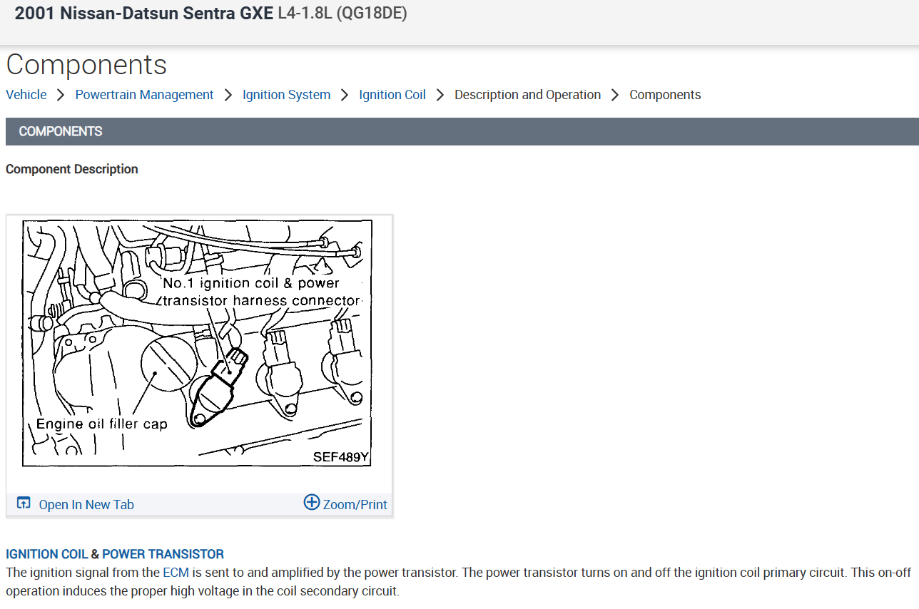

It sounds like the engine needs a tune up, I would also run the codes as well. Here are the instructions on how to swap the plugs out which I would replace the ignition coils as well. Here is a guide that will help:
NGK Double Platinum Tipped
Standard Type .................... PLFR5A-11
Cold Type .................... PLFR6A-11
Hot Type .................... PLFR4A-11
https://www.2carpros.com/articles/how-to-change-spark-plugs
