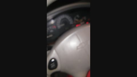

My car is starting up but it is not connecting to actual start up and drive it. I have got three opinions and they said from the sounds of it it could be the alternator or the fuel pump. I just want to get another opinion to know exactly what is going. It is not the battery, it is not drained. The lights still come on and it still cranks up just not actually starting to the point where the car can be put in drive.

Could you please watch the video then tell me what you think it might be?

Okay, I watched the video a couple of times and cannot tell for sure what the problem is. At the end of the video it does seem like the battery is draining. Try getting a jump start and see what it does. If it does not start (which it may or may not), then you will need to start checking things. One question though, is the security light coming on? If so it could be as simple as a bad chip in your car.
