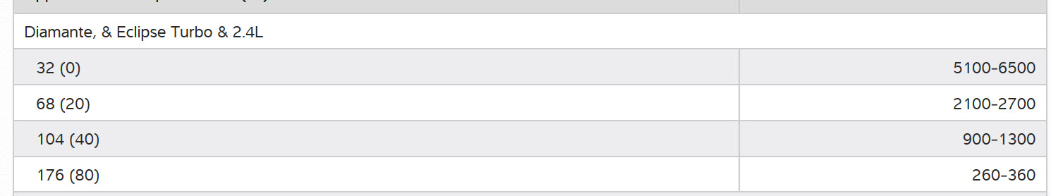

How about the engine coolant temperature sensor?
Tuesday, May 16th, 2017 AT 7:14 AM
HMAC300
  • 48,601 POSTS
I kind of doubt the cooant sensor but here is achart to check it. You'll need an ohm meter. Also one thing I forgot you can do a wiggle test on crank sensor and that is when it quits running wiggle harness by it and if it starts the harness may be bad and in need of replacement.
