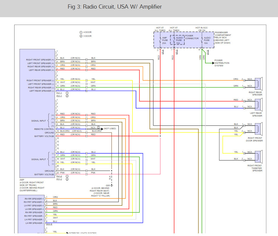

I am currently having some car radio issues. When I turn on the car (Hyundai Getz 2009) the radio lights up but nothing happens. Usually the radio will start and there will be the station text on the screen however, nothing happens just lit up.
Any hints to what the problem maybe?

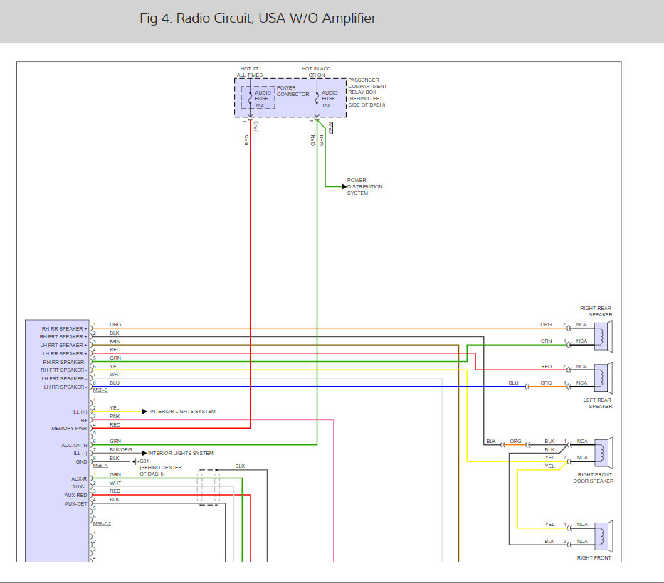

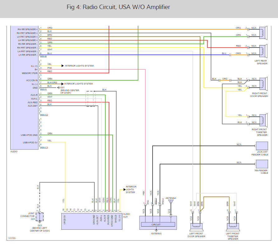

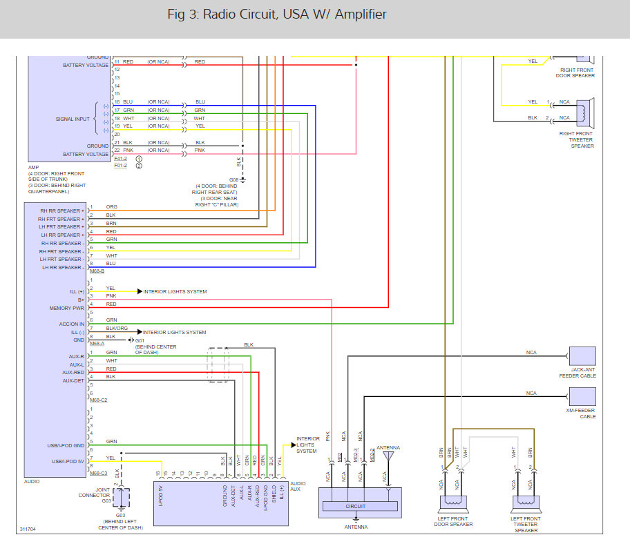

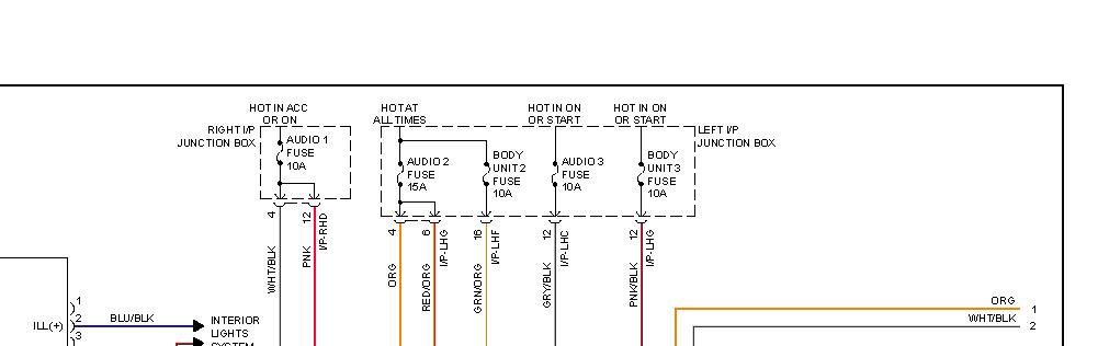

There are three fuses that run the system if you have an amp if not only two fuses here is the wiring diagrams so you can see how the system works and a guide to check for power at the fuses.
Check out the diagrams (Below). Please let us know what you find. Cheers

I did check the radio fuse and it doesn't look blown. Is that the only one I should check?

check underhood as well

Check for power and ground at the radio.

In the end, I purchased a used radio unit fixed it!
