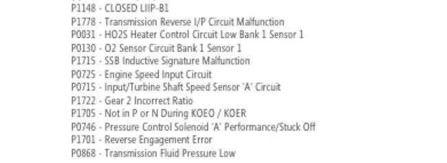

My car RPMs are going up when I press the gas and the car speed needle stay on 0 MPH when it’s in drive. I have to put the car in park again for it to catch speed.

Bummer, it sounds like the CVT transmission has gone out. Do you have a check engine light on? If so, we should run the codes to see if any point to a bad transmission. I would remove the transmission dip stick to see if the fluid is burnt up, if so, I would not mess with it and have a new or rebuilt unit installed. But let's run the codes first.

Yes I have the check engine light on.
May 9, 2025 at 1:22 PM
  • 54,494 POSTS
Yep, these are the codes you get when the belt goes out inside the CVT unit. Did you check the fluid condition?

Yes, I checked the transmission fluid and it barely any fluid on the stick and it is brown.
May 15, 2025 at 9:36 AM
  • 54,494 POSTS
Oopps, that is no good, I would fill the fluid and see if anything has changed, if not it sounds like the transmission has gone bad. Sorry.

i had fill the fluid.
Jun 3, 2025 at 6:58 AM
  • 54,494 POSTS
Yep, bummer, it looks like the transmission will need to be rebuilt, the belt is burned up and not holding like it should, this is a super common problem with these cars. Thanks for the video, it helped.
