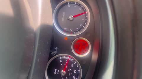

RPMs are going up when I press the gas and speedometer needle stay on 0 MPH?
CHYNAS27
  • 2010 NISSAN SENTRA
  • 2.0L
  • 4 CYL
  • 2WD
  • 225,000 MILES
My car RPMs are going up when I press the gas and the car speed needle stay on 0 MPH when it’s in drive. I have to put the car in park again for it to catch speed.

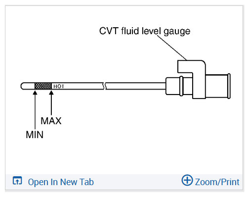

Bummer, it sounds like the CVT transmission has gone out. Do you have a check engine light on? If so, we should run the codes to see if any point to a bad transmission. I would remove the transmission dip stick to see if the fluid is burnt up, if so, I would not mess with it and have a new or rebuilt unit installed. But let's run the codes first.
Check out the images (below). Please upload pictures or videos in your response.

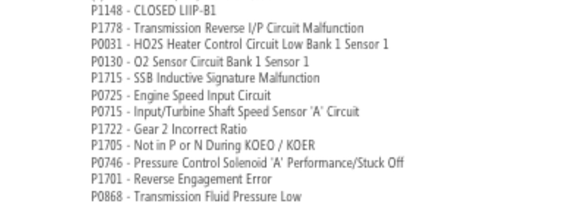

Yes I have the check engine light on.
Friday, May 9th, 2025 AT 1:22 PM
KEN L
  • MASTER CERTIFIED MECHANIC
  • 55,322 POSTS
Yep, these are the codes you get when the belt goes out inside the CVT unit. Did you check the fluid condition?

You might just need fluid, have you checked it?
Sunday, May 11th, 2025 AT 11:38 AM
CHYNAS27
  • 8 POSTS
Yes, I checked the transmission fluid and it barely any fluid on the stick and it is brown.
Thursday, May 15th, 2025 AT 9:36 AM
KEN L
  • 55,322 POSTS
Oopps, that is no good, I would fill the fluid and see if anything has changed, if not it sounds like the transmission has gone bad. Sorry.

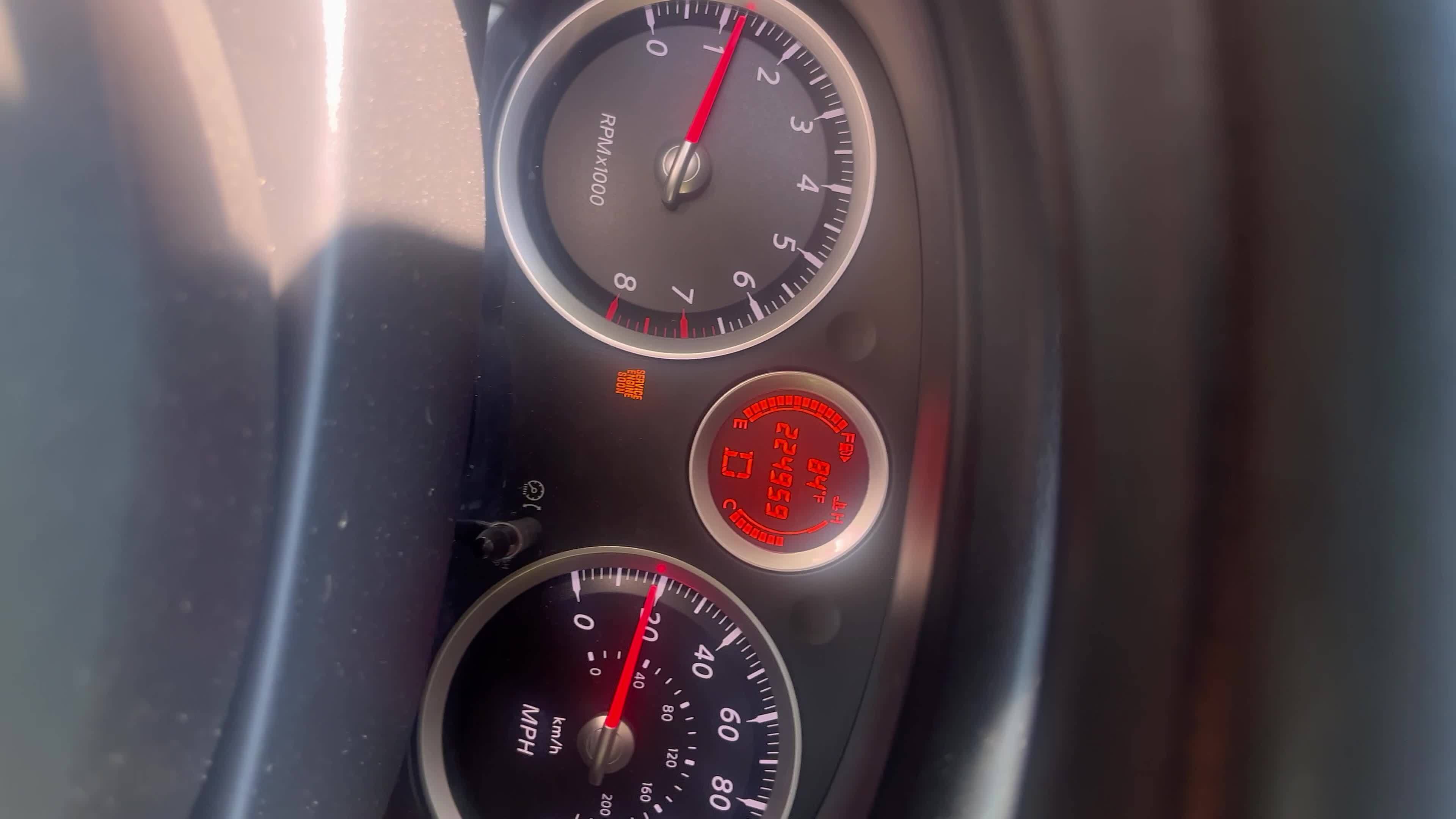

I had fill the fluid.
Tuesday, June 3rd, 2025 AT 6:58 AM
KEN L
  • 55,322 POSTS
Yep, bummer, it looks like the transmission will need to be rebuilt, the belt is burned up and not holding like it should, this is a super common problem with these cars. Thanks for the video, it helped.
