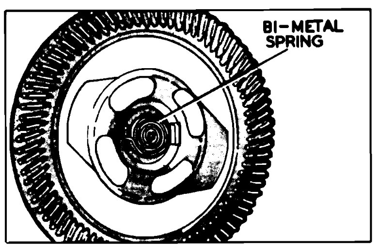

The clutch fan should change speed based on under-hood temperatures. The fan drive clutch uses a heat-sensitive, coiled bimetallic spring connected to an opening plate that regulates the flow of silicone oil into a coupling from a reserve chamber. (See pic below) The silicone oil is returned to the reserve chamber through a bleed hole when the valve is closed. This unit causes the fan speed to increase with a rise in temperature and to decrease as the temperature decreases.

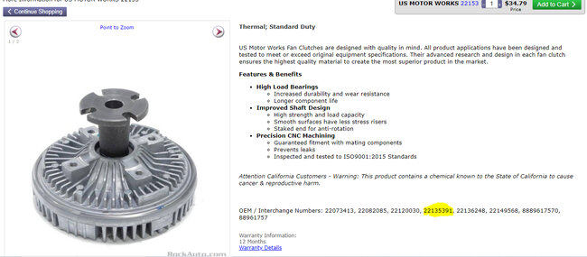

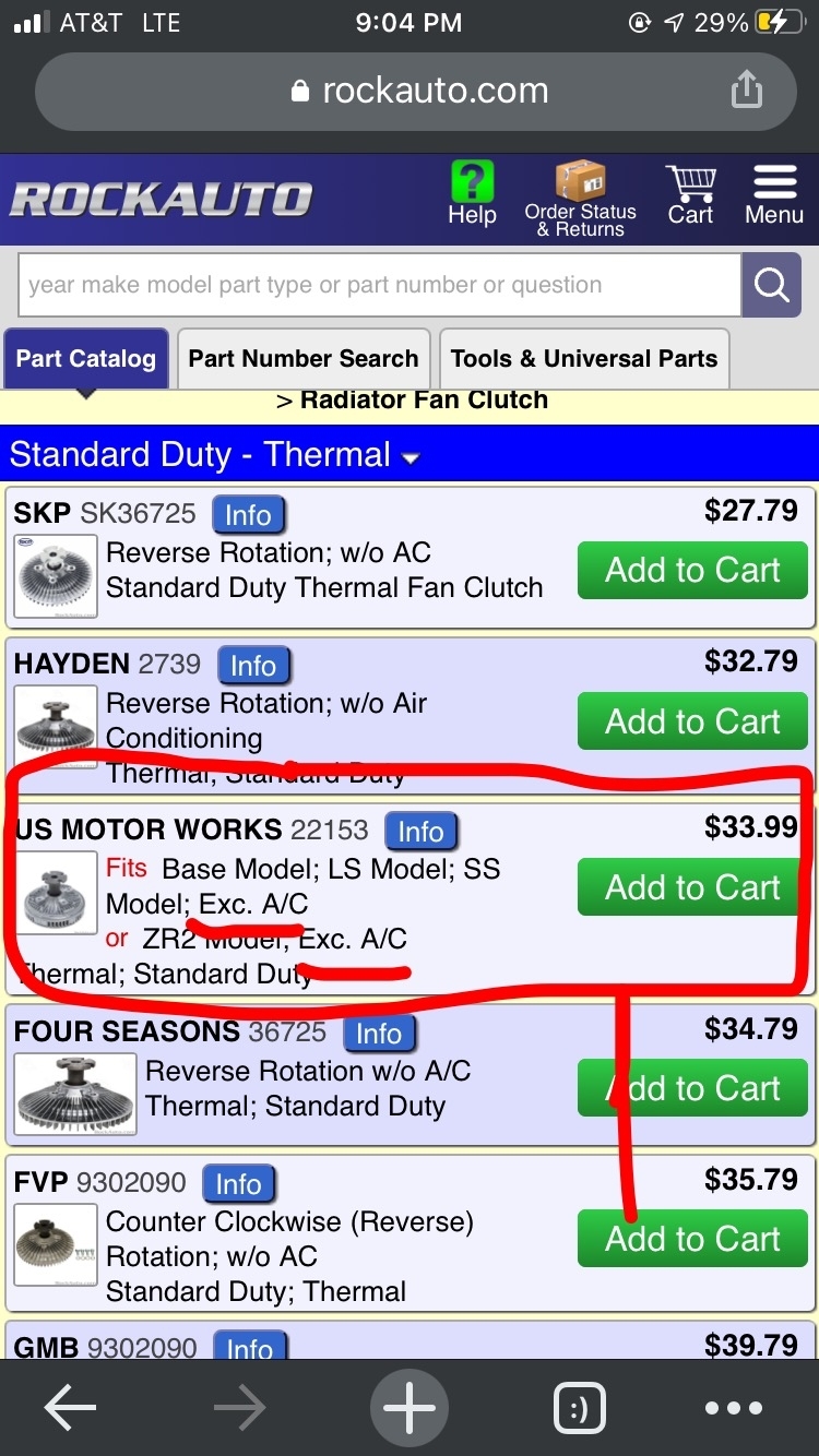

I bought the us motor works fan clutch. I am looking at it now and it says exc A/C. I have A/C in my car did I choose the wrong one? What does exc mean?
Monday, February 13th, 2023 AT 7:07 PM
  • 110,194 POSTS

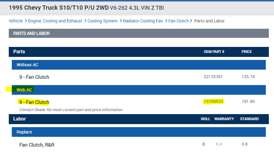

Yep, that is the wrong one. I looked it up on Rockauto. They don't have one for a truck with A/C. It may be spinning in the wrong direction based on belt routing.

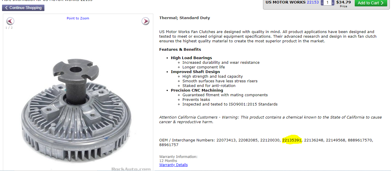

Take a look at pic 1 below. That is from my manual. It indicates two different clutch fans based on A/C. Note The OEM part number for the one without AC is indicated on the rockauto fan you purchased. (See pic 2)
If you page down to the Heavy-Duty Thermal on rockauto, they indicate with A/C.
Back to pic 1, find a fan clutch that replaces the highlighted OEM part number, 15709933.

Thanks a lot that makes sense of why it would be running a little warmer. Do you know what exc mean? I will follow up after I get my new parts.
Tuesday, February 14th, 2023 AT 1:33 PM
  • 110,194 POSTS
Interestingly, all the other fan clutches indicate without AC. Exc must mean except. When you look at the part numbers, they show that it replaces the non-AC OEM part number. Chances are it is a different brand and they referred to it differently. Anything to make it more confusing. LOL
