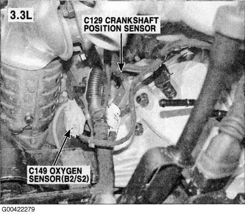

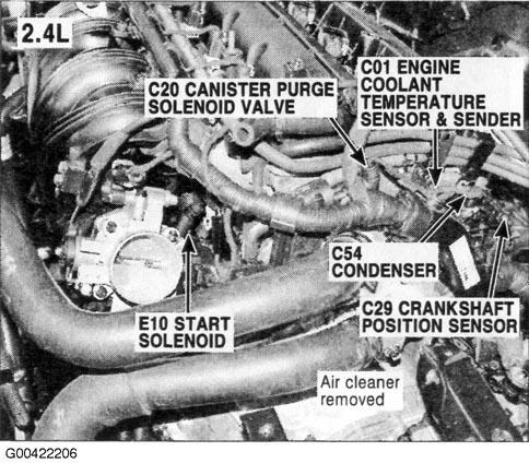

Car not firing
PURPLEDRAGON2626
  • 2005 HYUNDAI SONATA
  • 2.7L
  • 6 CYL
  • 2WD
  • 74,000 MILES
My car has no fire on all three coils. I hooked it up to my diagnostics machine and it gives me no errors.
Saturday, June 30th, 2018 AT 7:52 PM
  • 110,194 POSTS
If you are getting no spark, the first thing I would check is the crankshaft position sensor. The sensor may have failed and set no code. Take a look through this link:
The engine size you indicated above does not exist. However, there is a 3.3L V6. If that is the correct engine size, the sensor is located on the left rear of the engine. See picture 1. If the engine is the 2.4L 4 Cyl, the sensor is located on the top rear of the engine. See picture 2.
If you have a scanner which can read live data, check to see if there is a crankshaft position sensor signal. If there is not chances are the sensor is bad or there is a wiring issue.
Let me know if this helps.
