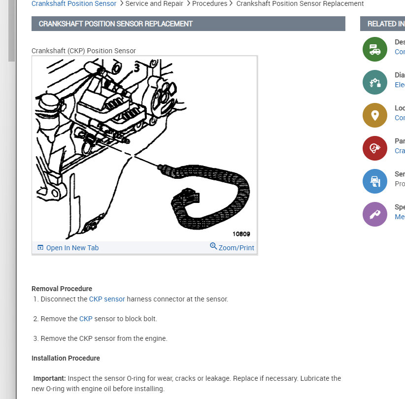

Put new gas lines, newgas tank and new fuel pump and 2 new fuel filters 6 months ago, car ran great. Just went start it one day and motor will turn over, But I am not receiving any fuel or spark. Car dous have a factory alarm system. But never used it. I have checked fuses, any cracked or broken wires. So I have no idea what's up with this car!
Wednesday, September 30th, 2015 AT 11:14 PM
If you are not getting fuel or spark, then that is likely a crank sensor issue.
However, here is a guide that will get us started with this issue:

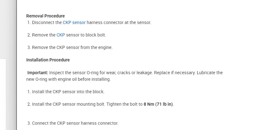

I am attaching the process below on how to replace this and if it were me on this vehicle, I would replace the sensor and then retest this operation.
Please let us know what you find with this, and we can go from there.
Thanks
