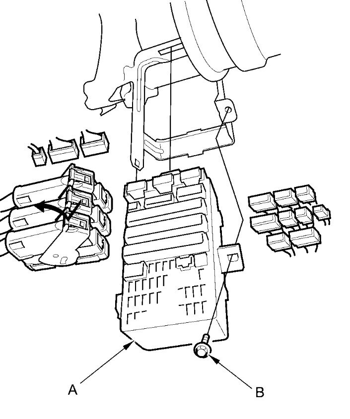

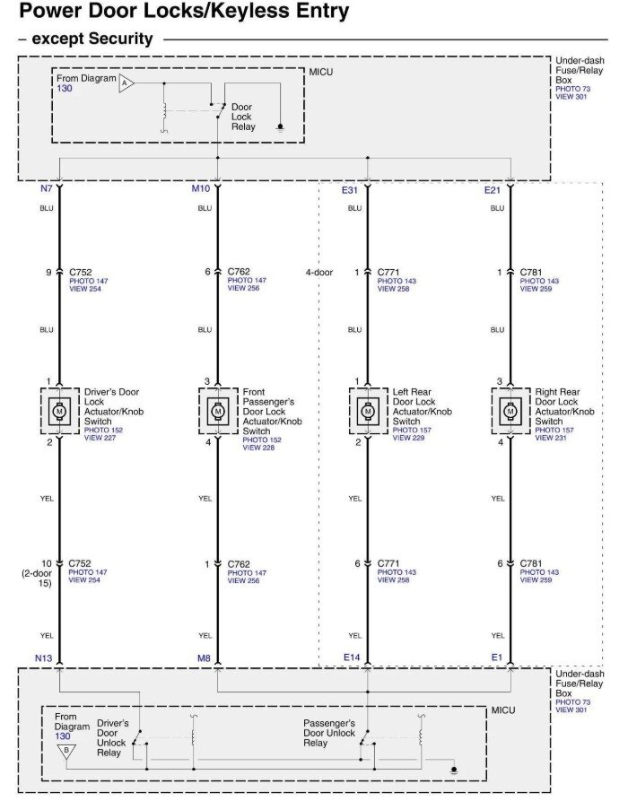

Hi, i have a fn2 type R, i bought the car with this problem where the door lock switch wont unlock the car but only locks. The remote only locks the car also but do not unlock, pressing the unlock button only disarms the factory alarm system. I ordered new door lock actuators for both doors (coupe) but still the same problem. Checked the fuses also.

As it is working one way and responds to the remote with disabling the alarm we know it has power and the wiring is okay because all of the same parts are used for lock or unlock. In operation it simply reverses the polarity in the wires to move the actuator. That is done inside the Multiplex Integrated Control Unit (basically a smart fuse box with body control functions) using the internal relays. The internal parts are not replaceable, you replace the complete MICU then you use a scan tool to register the replacement in the vehicle so the immobilizer doesn't stop the engine from running. The problem will likely be sourcing a replacement part.
