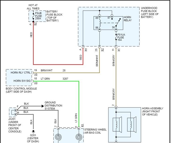

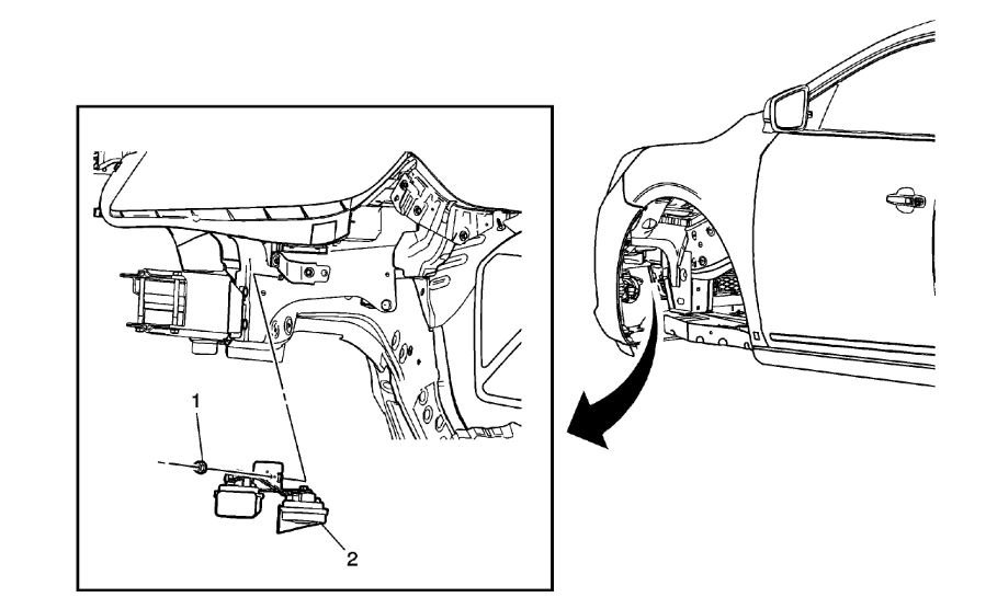

I've replaced the fuse. I want to replace the horn but I don't know where it's located.

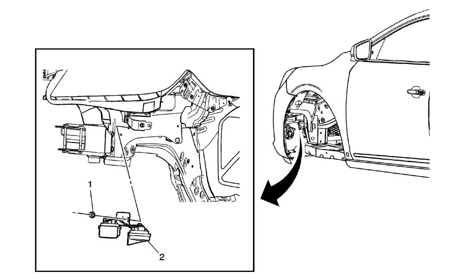

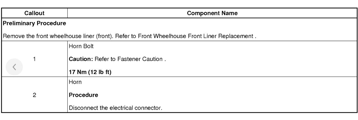

Good evening,
I attached the location, picture and a wire diagram for you to view for the horn.
Do you have a voltmeter to do some tests if the horns do not work?
