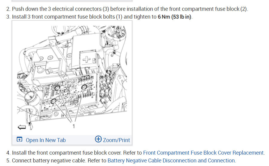

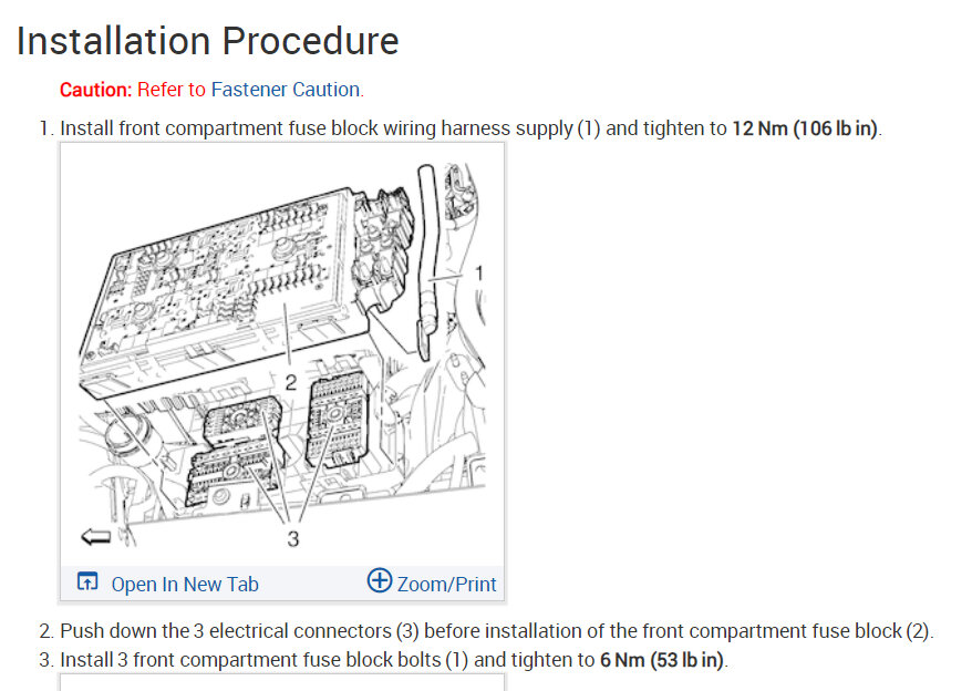

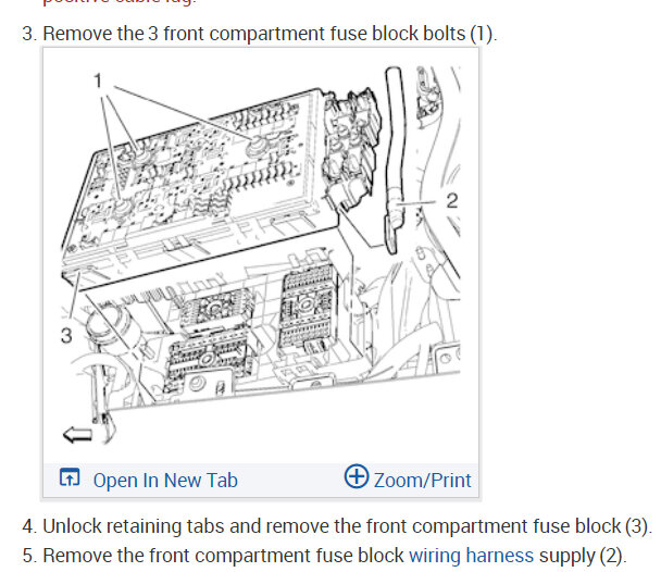

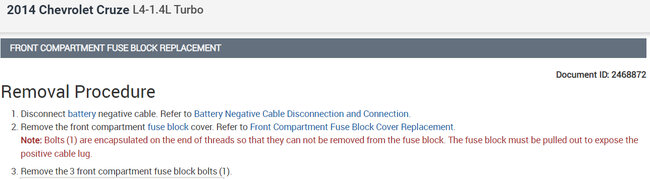

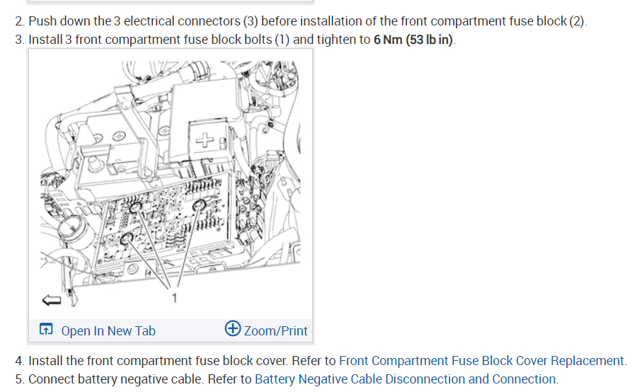

Wow thats hot, I have seen the junction box go bad and cause this problem, but it would be good to run a scan as well and check the alternator output. Here is how to replace it which is easy because it self learns. Check out the images (below). Please let us know what happens.

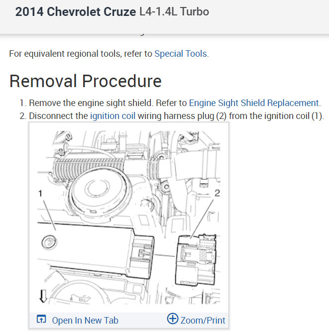

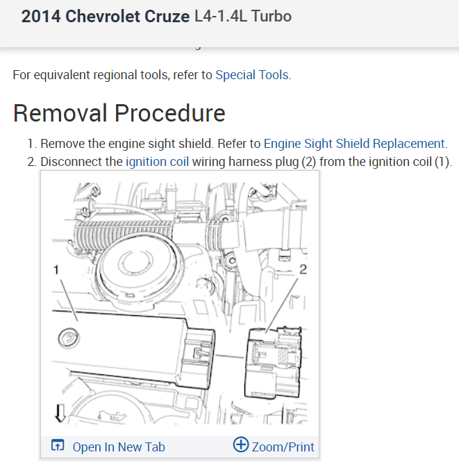

Currently waiting on an Ignition Coil Pack Connector to come in, I was incorrect in it isn't the junction box. Will update if this fixes the problem. Car cranks and runs okay, but still shutting off. If you "wiggle" the wires where the clip is it cranks right back up.

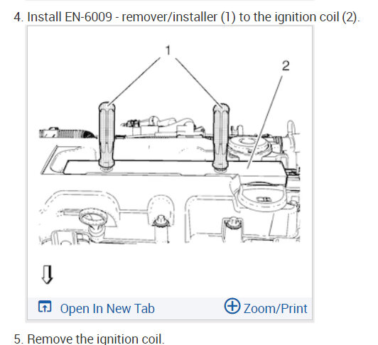

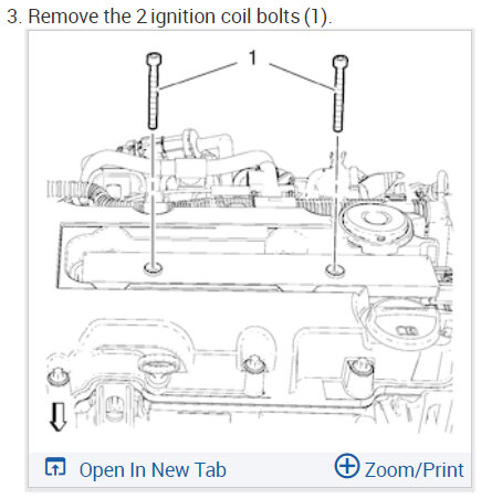

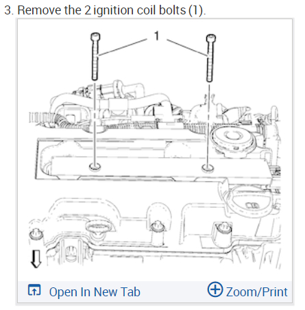

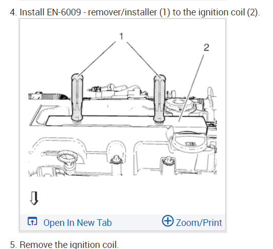

I would replace the coil pack as well, it sound have an internal connection problem. I have heard of the coil packs having issues as well. Check out the images (below). Let us know what you find.
