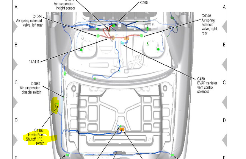

When the key is turned to on position, the fuel pump doesn't kick in. When FPDM is bypassed using jumper wires, the fuel pump engages and runs 100%. Grounds are looking good, used multi meter, FPDM is getting 12v. FPDM was replaced and no result. Please help!

For power to reach the FPDM, it has to come from the fuel pump relay and through the inertia switch. Have you checked the switch? Also, the FPDM is what controls the voltage to the pump. However, power must go through the inertia fuel shut off switch first.
I you haven't already, try resetting it. It is located in the trunk, driver's side behind a panel.
See pic below.

We worked it back to a broken fuse. New FPDM on the way. Maybe a bad new product???

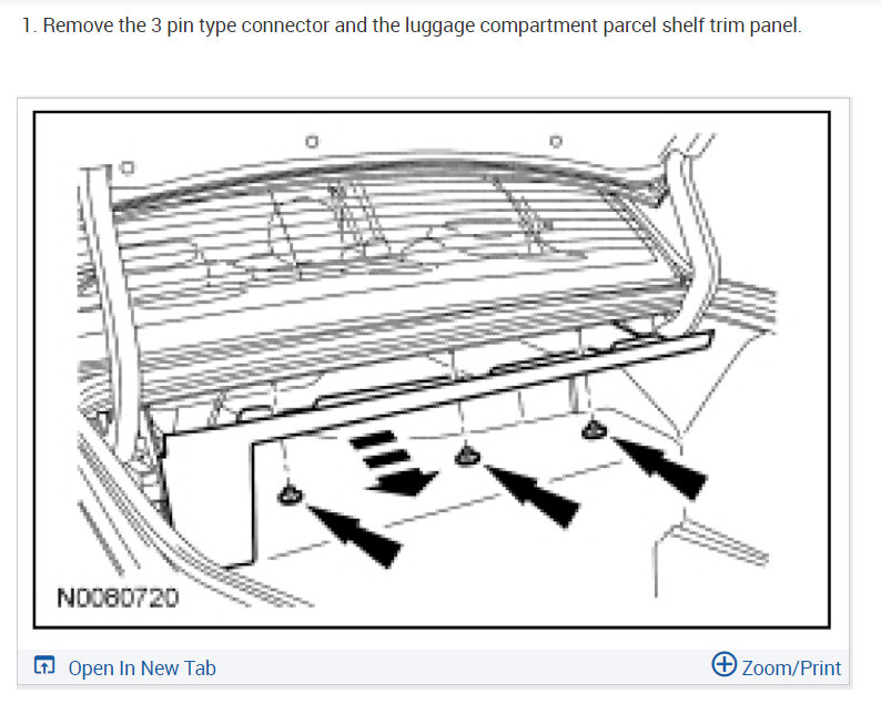

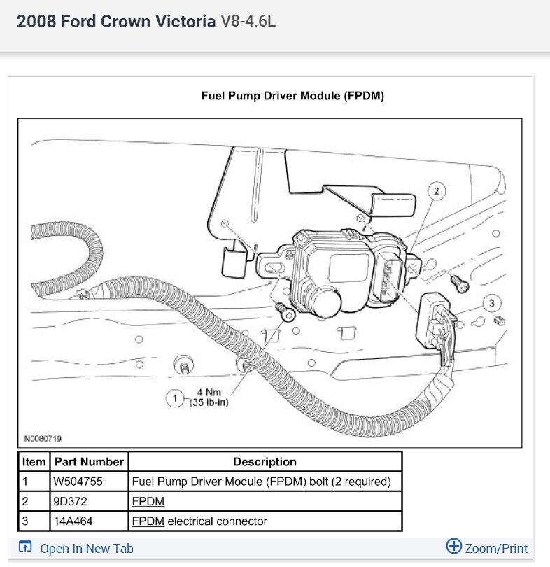

Here is a new guide that can help but is sounds like you found the problem.
Here is the location of the FPDM which is in the truck and how to change it out. Check out the images (below). Please let us know what happens.
