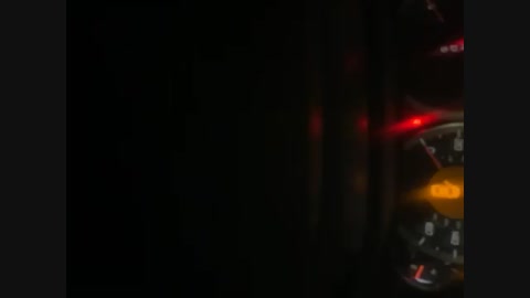

The car crank but will not start, makes a wining noise every time I try to start it…I was told it was the starter, so I replace that with a new one, still same issue, then I was told it was the timing chain, had that replaced and still same problem. what is causing this?

Could you record it cranking and upload it for me to hear? Also, was the timing broken or out of time when they first took it apart? I ask because it is an interference engine. If the timing was off far enough, it may have internal damage. I should be able to tell if I could hear it cranking.

Hey Joe, thanks for replying. I was told that the timing chain guide was broken, and that I will need a new timing chain also. So, basically, I replaced the battery, starter, timing chain and I’m still here with the same issues from the start. Hopefully, you can hear it clearly enough to point me in the right direction. thanks in advance.

I listened to the video. The engine has no compression. Did the chain fail while the engine was running or is it something you checked because it wasn't running correctly?
If it was running, this is an interference engine. I suspect you have several bent valves. Do a compression test to confirm it for me. You will need a compression gauge, but most parts stores will lend one to you. I feel you will find little to no compression present.
Here is a link that explains how it's done:
The engine is turning faster than normal. That is why it sounds odd.
