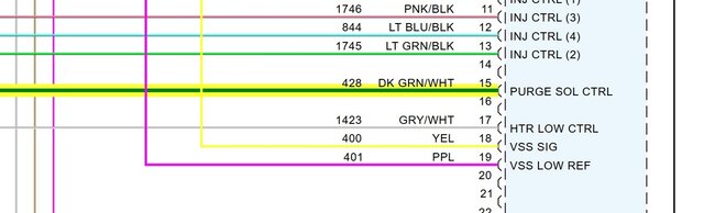

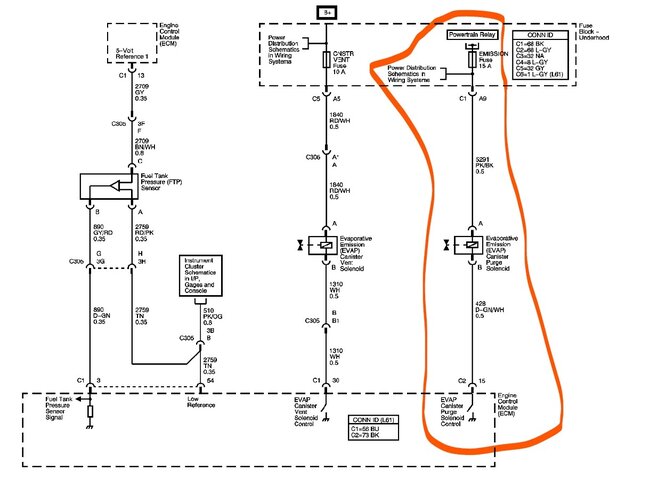

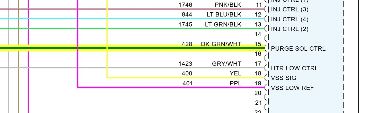

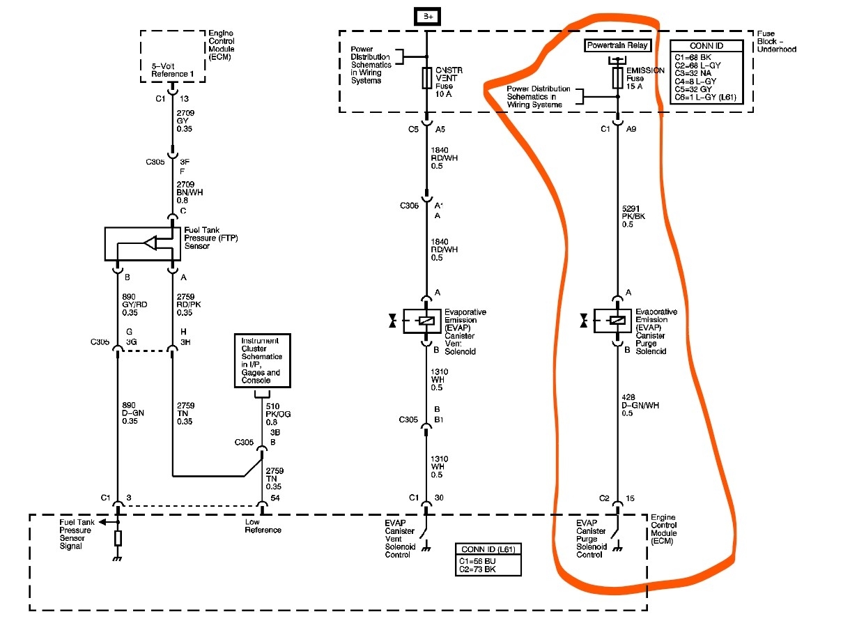

Well, code P0433 is related to the purge valve control circuit. From the description of it being broken off I would suspect the wiring connector, or the wiring itself is the problem.
If you have a scan tool that has bidirectional controls the testing is easy. Without one it's a bit harder. However, the basics are to use a test light connected to ground, unplug the connector and use the test light to verify that there are 12 volts on the pink wire with black stripe. Then to test the other wire (dark green with white stripe) without a scan tool you would need to go to pin 15 on the PCM. Plug the purge valve connector back in, then apply a ground to pin 15 and see if the solenoid activates or connect a test light in place of the solenoid to see it visually. If you apply ground and the light or solenoid don't react you know the wiring is the issue which I suspect is the case. You just need to determine where the break is.
