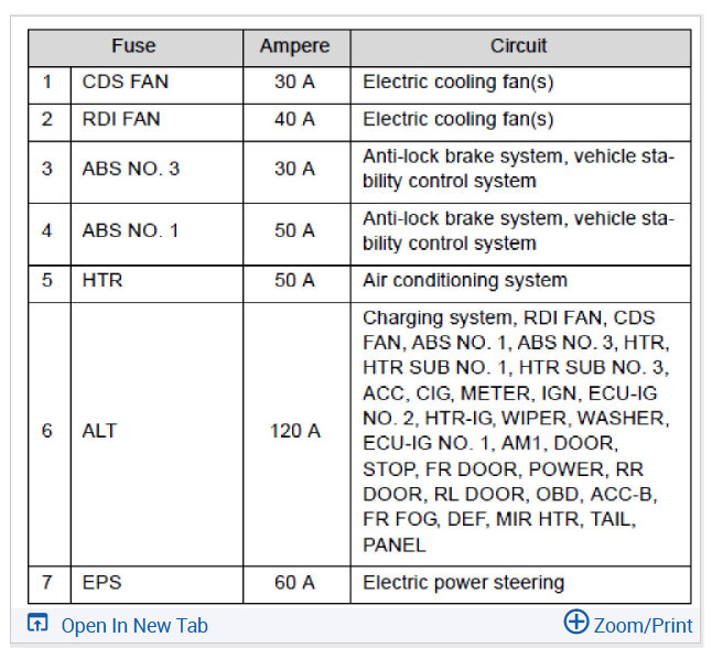

Hello, my partner got a jumpstart off a friend and hooked the terminals up the wrong way and now the car won’t start. What could be the problem?
Jan 29, 2025 at 3:13 AM
  • 54,503 POSTS

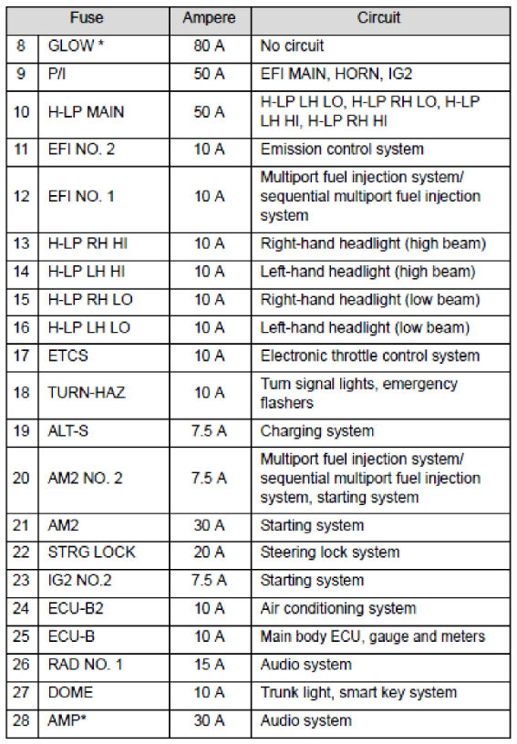

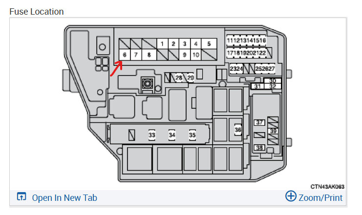

Most of the time when this happens it will blow the main maxi fuse in the fuse panel under the hood. Here is the location of the fuse so you can check it out. Also, this guide can help:
https://www.2carpros.com/articles/resolving-reverse-battery-connection-in-cars-a-step-by-step-repair-guide

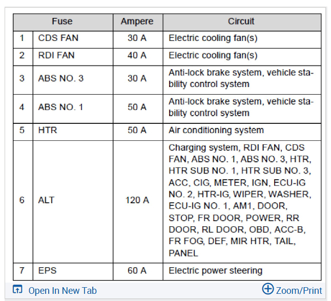

Please go over this guide as well:
Jan 29, 2025 at 10:32 AM
