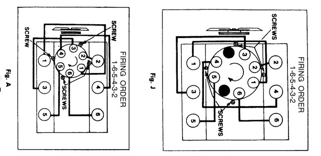

Wires missing and need to know what goes where on the cap.

These are the two possible wire layouts depending on which version of the HEI system you have. The firing order is the same on both 1-6-5-4-3-2. Normally the wire tower at the rear is 6. In most wire sets 2 is the shortest wire then 6 then 5 with 3,1,4 being the rest in wire length.
