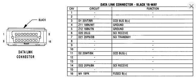

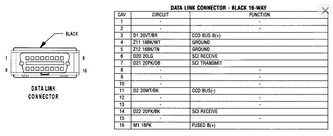

The last pic below is of the data link connector (DLC). It indicates each pin's function and will be needed for testing.
Let me know what you find.
