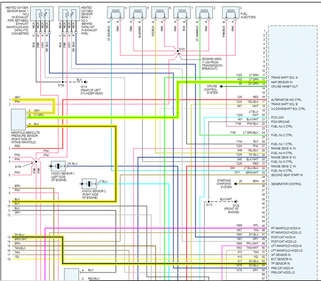

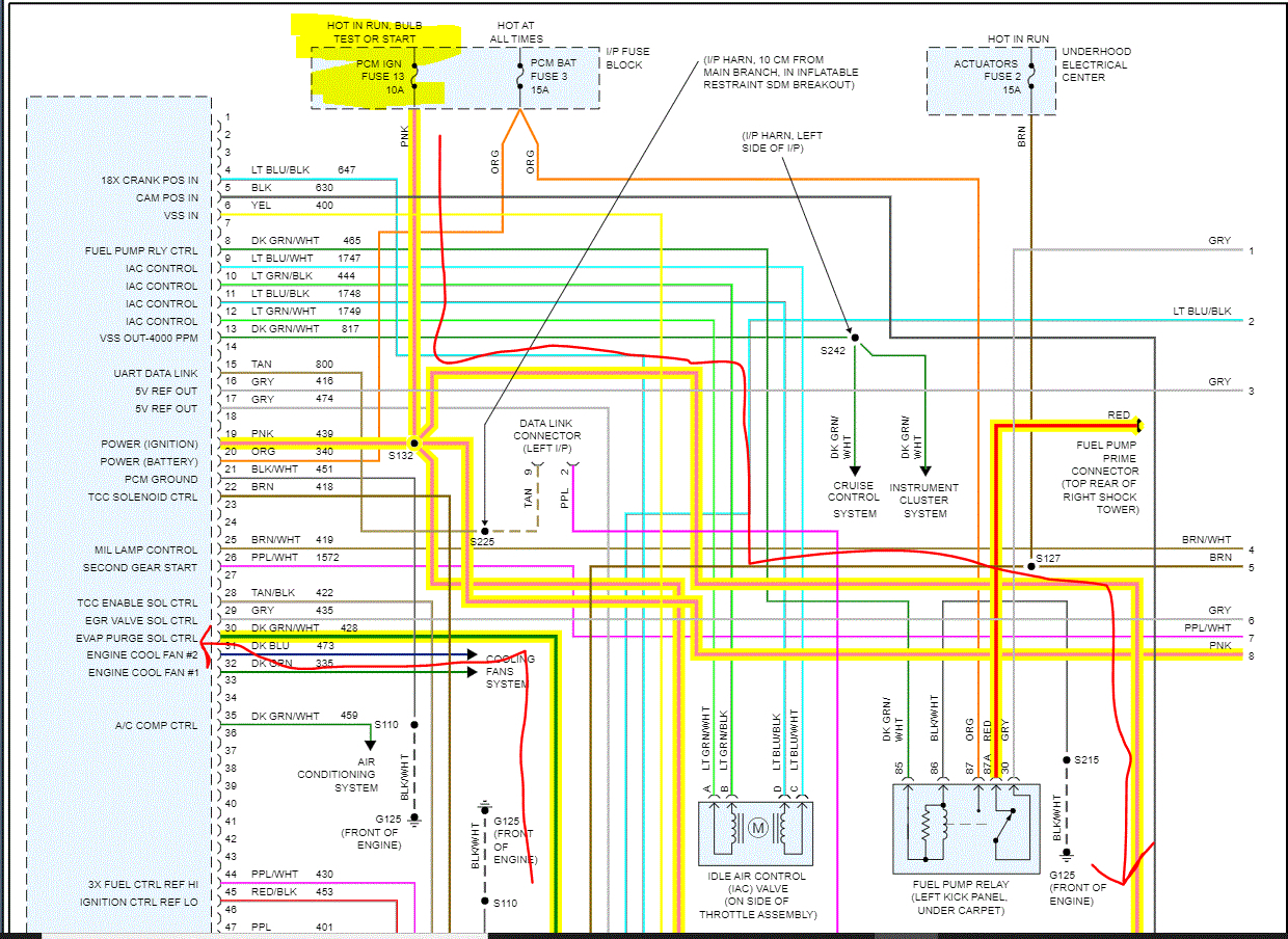

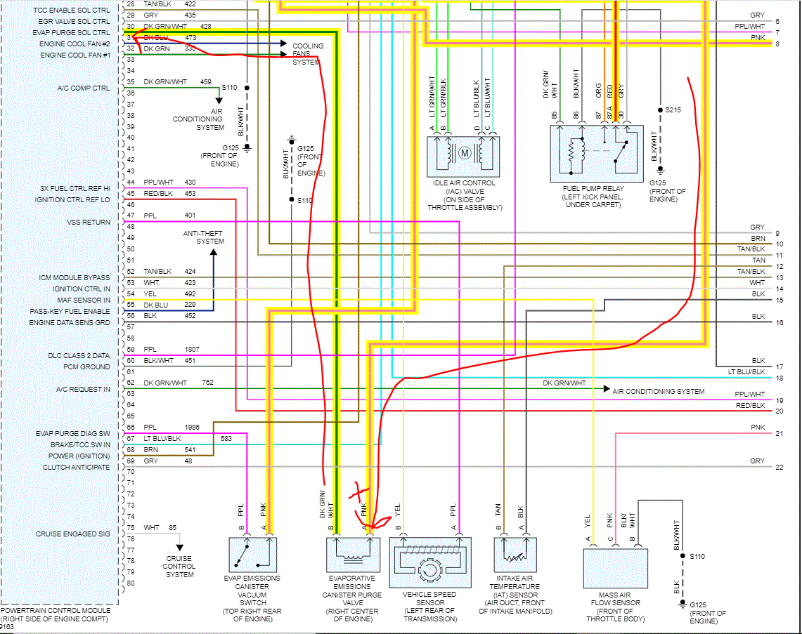

Hello, I have the car listed above with a 5 speed, and I was wondering if anyone has the schematics, diagrams etc, on where the canister purge valve should be hooked up to? I'm wondering if there is a wire missing or something because the code came up.

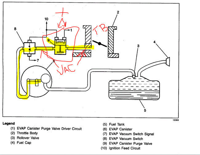

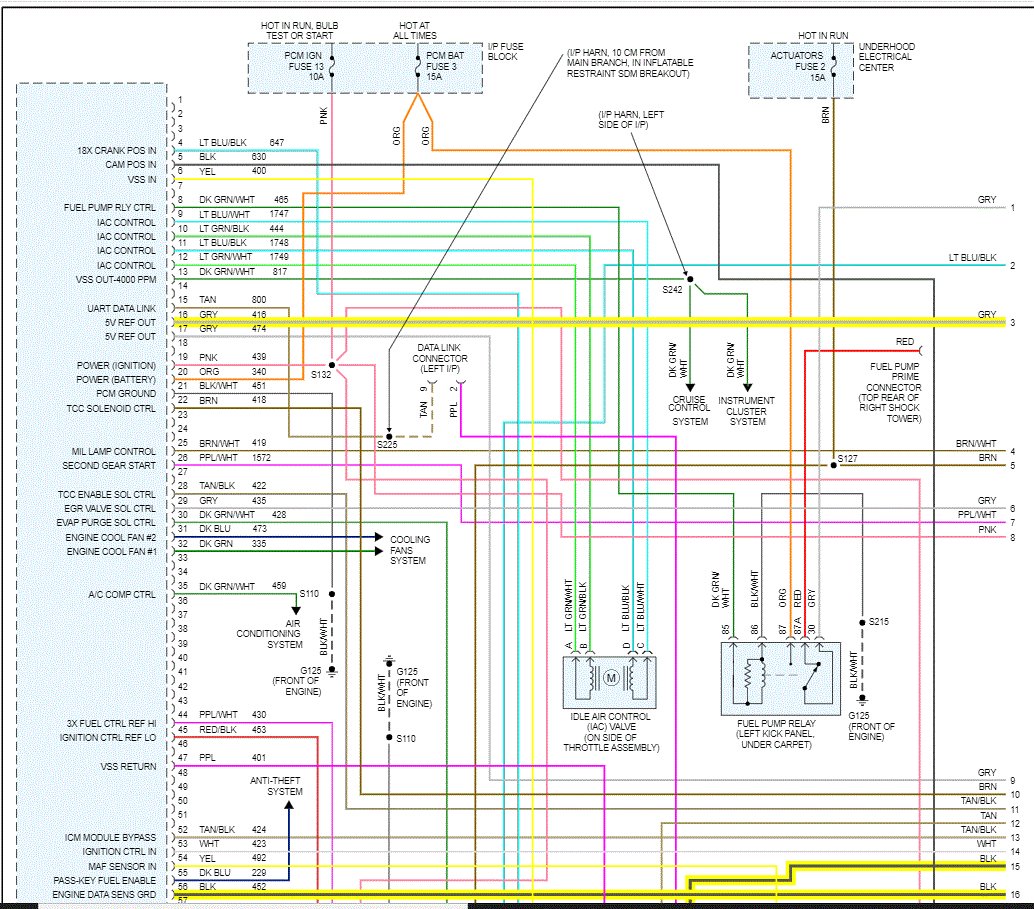

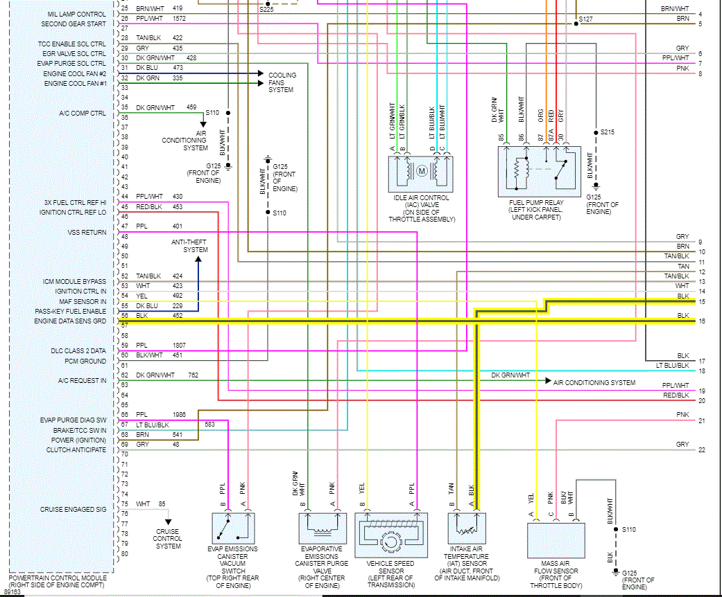

The purge valve is part of the EVAP emissions system (EVAP). It is triggered to allow gas fumes to enter the engine from the EVAP canister (charcoal canister).
It functions on both electric and vacuum, either of which can cause a code. Also, the purge valve itself can fail.
If you look below, the first two pics are the electrical portion of the purge valve circuit. I highlighted and placed red arrows to where power comes from and goes to. (Power from fuse/ground provided by PCM).
The last pic shows the vacuum portion of the system. Gas fumes from the fuel tank are stored in the charcoal canister. At a specific time, the PCM provides ground to actuate the purge valve. At that point, a vacuum from the throttle body draws the fumes through the valve from the canister to be burned in the combustion chamber.
If you have the code that was set, let me know what it is so I can point you in the right direction, vacuum or electrical.
I hope this helps. Let me know if you have other questions. If you have the chance, let me know what the fix was. I'm interested in knowing.
See pics below. Note: Pics 1 and 2 came from a one-page schematic. I had to cut it in half the make it readable. I did overlap them so you can follow from one to the next. Also, sorry for the sloppy printing in pic 3. I can't do it neatly with a mouse. LOL

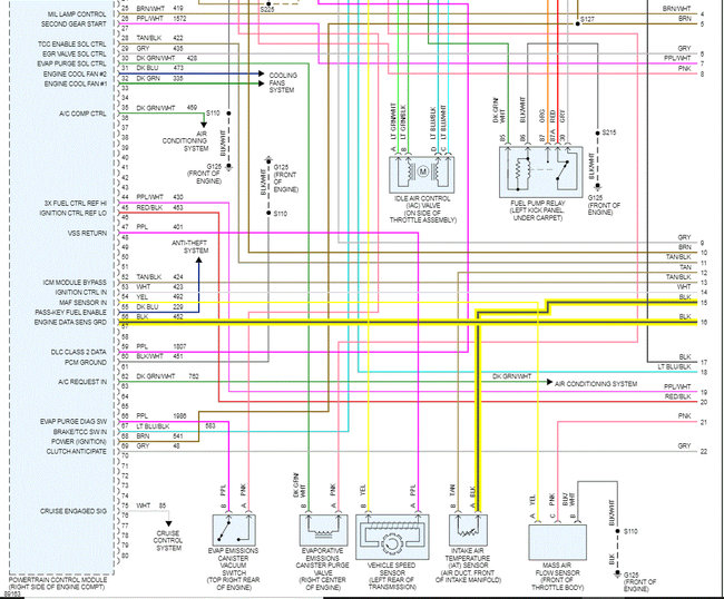

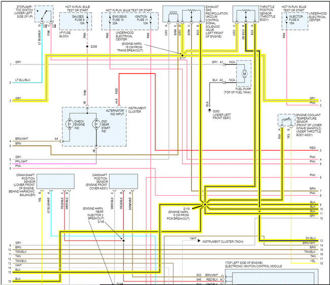

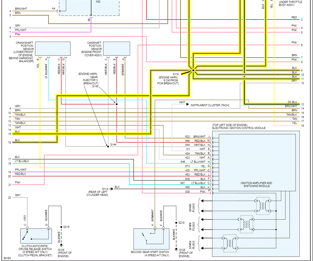

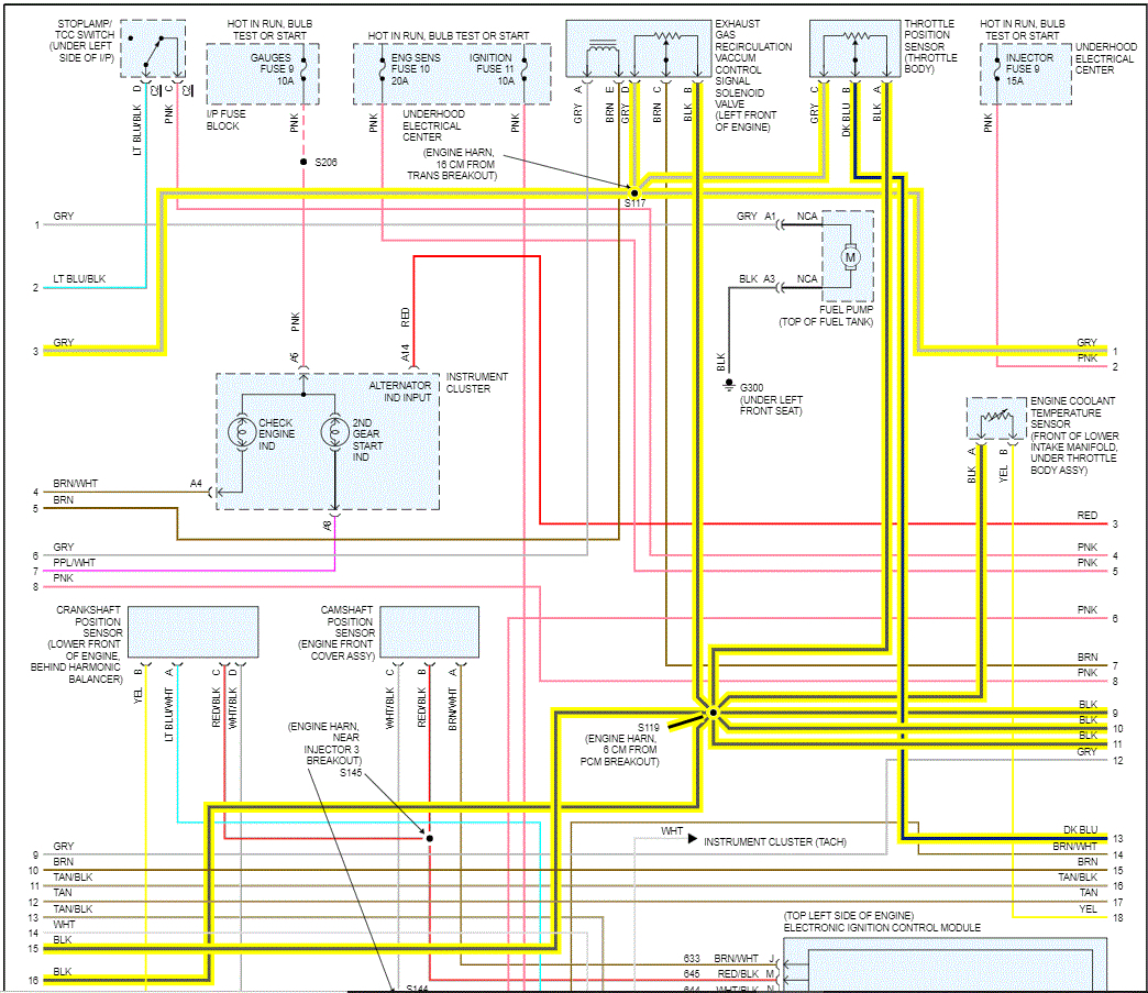

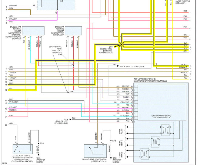

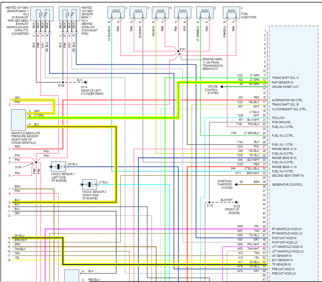

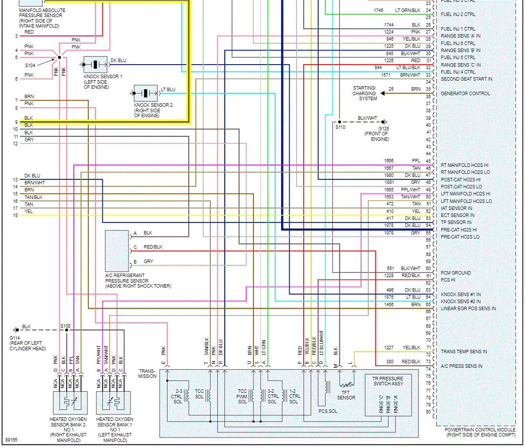

Hey, you know that might be on the money. I replaced my MAP sensor with an after market one from AutoZone, and I remember when I replaced my MAF with one from autosome, it wouldn't stay started unless I kept my foot on the gas, once I got the original OEM, idled just fine. So, I know some of those sensors are sensitive, and I may have to have that MAP sensor OEM, can you give me a schematic or diagram of the MAP sensor, and TPA sensor location? Because I changed them both, but forgot which one is which.
Monday, November 29th, 2021 AT 10:05 PM
  • 110,194 POSTS
I attached the entire powertrain management system schematic below. There were a total of three pages. I had to cut each page in half to make them readable for you, however, I did overlap them so you can follow from one to the next.
Additionally, I highlighted all wiring related to the MAP and TPS.
I hope this helps. Let me know what you find, or if you have other questions.

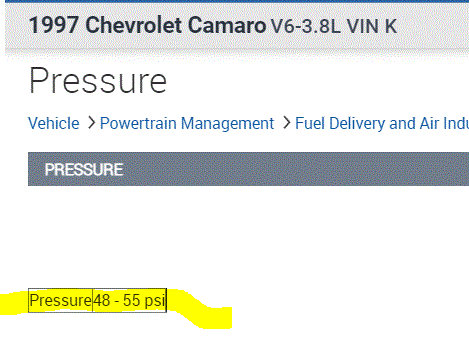

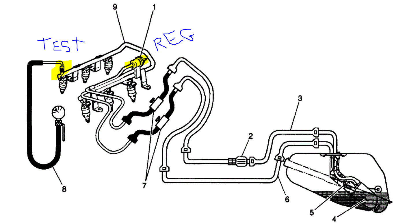

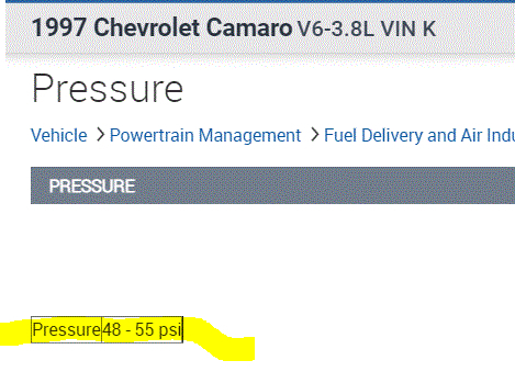

I was thinking the same thing with my injectors. Does this vehicle have a fuel pressure regulator, and fuel pressure test port? If so, are there pictures of the locations?
Saturday, December 4th, 2021 AT 12:44 PM
  • 110,194 POSTS
Yes, it has both. They are on the fuel rail. The regulator is vacuum operated. Before doing anything, remove the vacuum hose and inspect for evidence of fuel in it. The line should be dry.
Then proceed with the test. Remember, the system is always pressurized, so be careful I attached a pic below showing locations (sorry for the sloppy handwriting) and the manufacturer's specs for pressure.
Let me know what you find.
