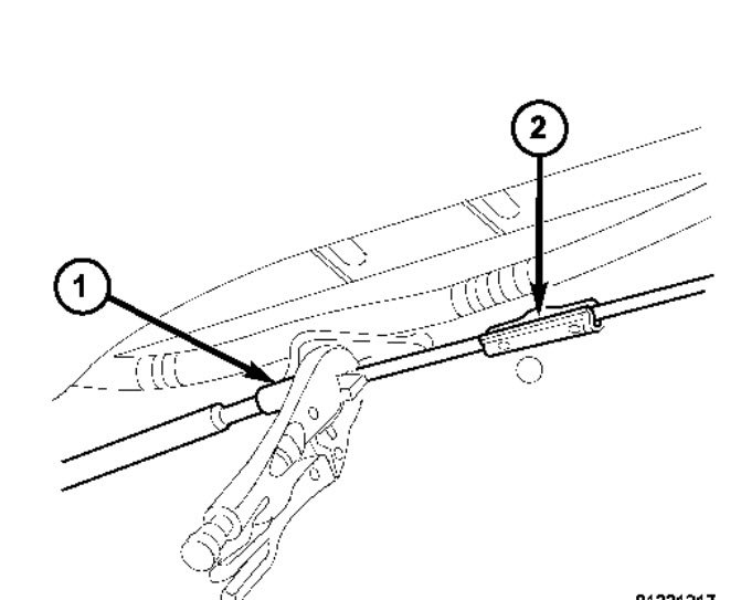

I have the limited 4wd Hemi. I have tried and tried but I can not get the rear rotor off.
All I can seem to find online is use a hammer. Hammer does not work. I want to do it correctly. I need to adjust or loosen the parking brake inside the rotor I am, assuming, but I do not see or can find the adjusting screw to release the tension for that.
Can someone, anyone help me please?

I am assuming you have removed the clips on studs holding rotor if not do so then try hammer. If you need to adjust parking brake see picture you will need vice grips and a wrench.

Are you located in a state that gets snow and uses salt on the roads? If so the rotor is likely rusted to the hub. They can rust enough that they act like they are welded on. I have used fpour pound hammers to break the rust free and had some that were so bad I have cut them with a torch to free them. I usually just order replacement parts and plan on replacing everything because of the problems the rust causes.

I cant seem to get the rear rotors off. I sprayed and tapped on the rotors they wont budge, their is no screw to remove and no bering nut, they should just pull off? I think maybe I need to remove the E-brake cable? And if I do HOW? Thanks Don

Sometimes if this is the first pad change there will be two flat spring washers(tinnerman) that hold the rotor on, but it does just pull off, use a bigger hammer!

Yes I got those little washers off. Still did not come off. Im getting the bigger HAMMER out now. I hope I dont knock off the rear axel Im pretty strong. HeHe! Thanks Don.

Thanks for your site! I love it.I had do do a few things before I got the bigger hammer out. And when I got back my son had came home 2 help me and he knew of my plight. So he grab a big rubber mallet and hit the rotor into the or toward the center axel. On one side then on the other side, this is a trick he learned from doing his earlier this month, and he said it came off pretty quick? Maybe the penatrating lube I sprayed earlyer helped? But if this question come up again I would say Hit the rotor on the flat outside with a rubber mallet on one side then the other if u are saving the rotors and if u are buying new ones as I was, just hit them hard with any big hammer from behind-out toward you. Because if you are getting new ones you dont care if u hurt the rotors. Well thanks for your quick responce I will be sharing this site with my friends! Very cool site. Don
