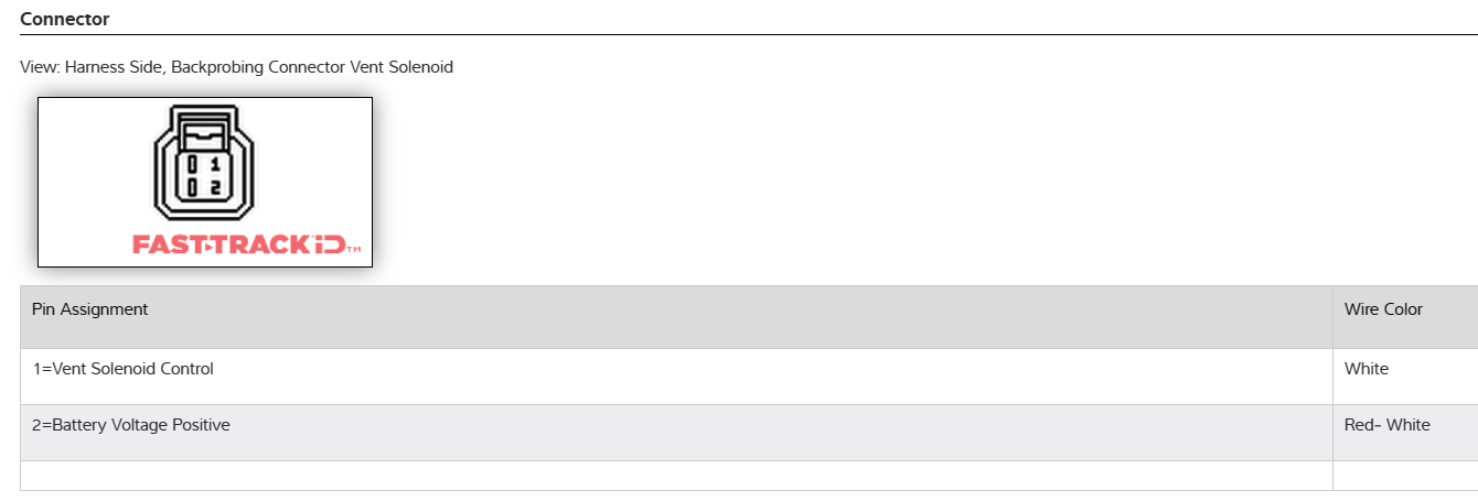

Here is the first test:
So, on the connector for the vent valve there should be a WHITE wire and a RED wire with a WHITE stripe or tracer.
WHITE-Solenoid Control- This is a ground wire that is switched in the PCM using something called a driver. A driver is simply an internal switch in the PCM. When the valve needs to be energized, the PCM simply just completes the ground also called the control.
RED/WHITE Stripe-Battery Positive-Should have 12 volts with key on engine off.
Place meter on second up from lowest setting on DC voltage. Should say 30 or 40. The symbol for DC is a straight line above a dashed or dotted line.
So, we will do this first. Let's make sure we are getting battery voltage at the valve:
1) Unplug the connector at the vent valve:
-Turn ignition key on with engine off
-Take BLACK lead and touch to ground, the frame is fine. You might have to scrape it to get a good connection.
-Then touch RED lead to the terminal the RED wire with the WHITE stripe on it.
You shou see 12 volts or close to it.
Note results.

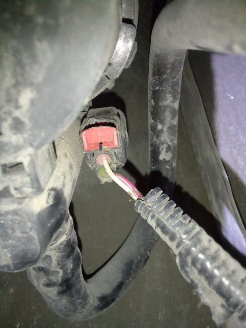

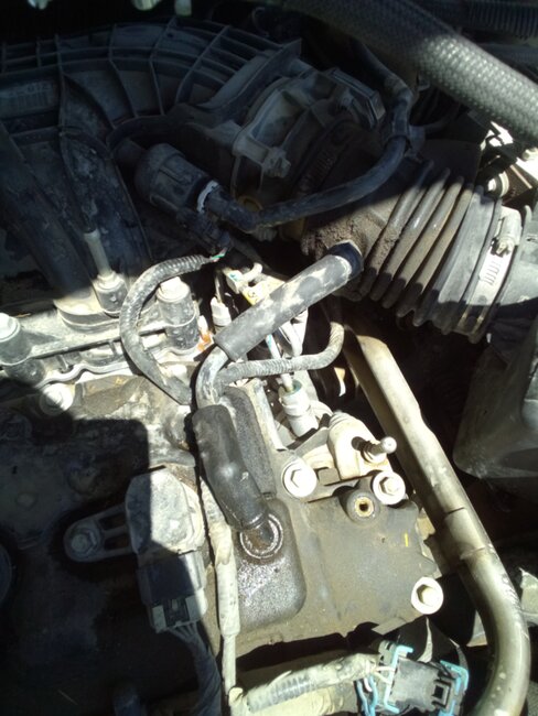

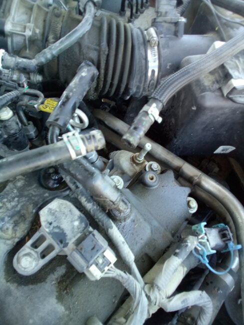

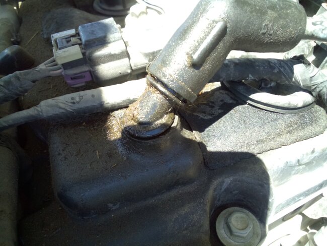

I know I knew the switch wasn't in the right spot I should have put to where I thought it was supposed to be sorry. So videos so lift and pull harness how do I get this use a screwdriver to slide the red lever up?
Saturday, August 26th, 2023 AT 1:45 PM
BRENDON S
  • 653 POSTS

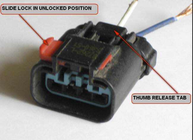

Hello DAVENOOB,
No problem. Don't worry about it. When you say red lever do you mean for the connector?
Like this? (See image)
If you can, take a picture for me.
Thank you,
Brendon
Saturday, August 26th, 2023 AT 1:49 PM

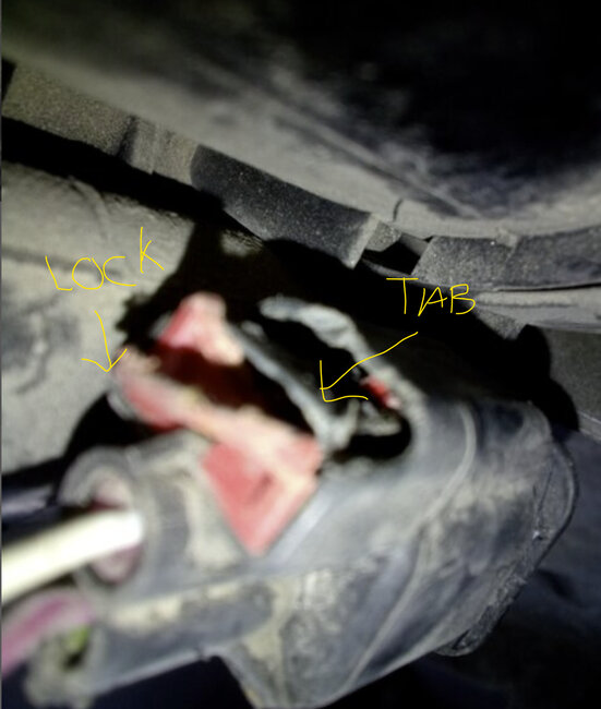

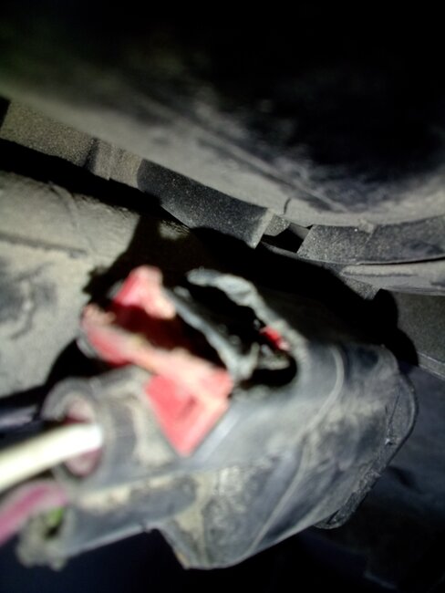

DAVENOOB
  • 312 POSTS
No thumb release and red tab won't go in or out.
Saturday, August 26th, 2023 AT 1:51 PM
BRENDON S
  • 653 POSTS
Hello DAVENOOB,
Try some WD40 or PB Blaster if you have it. Brake clean will work too. Dirt is probably lodged in the keeping you from pulling it out. It might only come out a little and then from what I can see you can push on this tab to see image.
A pic or small flat head screwdriver will help as well.
Because of its location, it collects a lot of dirt so soaking it in some kind of oil will help a lot.
What do you have on hand for oils and cleaners?
If nothing, I know this sounds odd, but a couple drops of olive oil might help if you have nothing else. Put a drop at a time on your finger and let it soak into the connector.
Worst case sometimes the red lock will come out in pieces unfortunately. Not a big deal though the lock isn't necessary.
