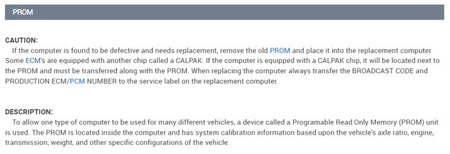

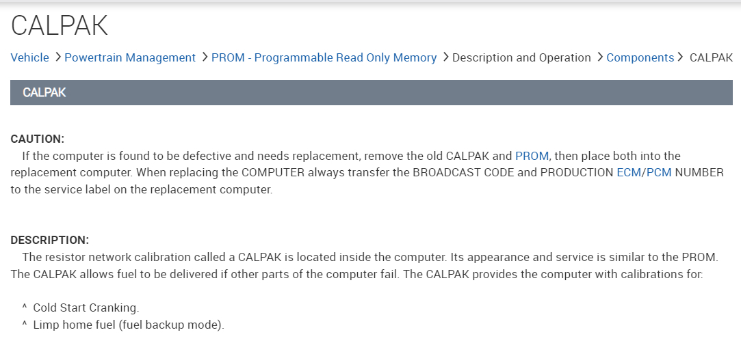

Well, the old eprom chips on these need to go into the new ECM from the old ECM. This is such an old design. So, are you losing injector pulse on just one injector or both, what's happening exactly?

I have no idea. With an older ECM like that, there wasn't much for having to reprogram ECMs back then. We would go through check the powers and grounds of a failing/failed ECM then change over the eprom chip inside. You can try Flagship One and see if they can help you out with something like that. They provide plug and play ECMs now that don't require any scan tool to program the VIN or anything. They don't have ECMs for every vehicle, but they do have one for a 96' Chev C/K series 5.7l. You can ask them if they can alter ECM coding, they might be able to. Or at least direct you to someone who can. I thought you were having issues with fuel injectors cutting out. But here is a link to their site and the ECM for that truck:

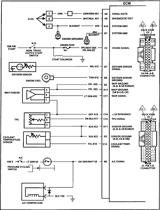

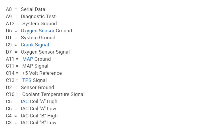

My 92g 30 bus has the 28 pin ECU, but I picked up the 32 pin ECU. can I get the pin out for the 28 pin ECU and the pin out for the 32 pin ECU? Please and thank you.
Jun 1, 2022 at 8:21 AM
AL514
  • 5,541 POSTS

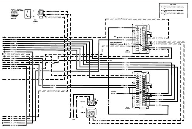

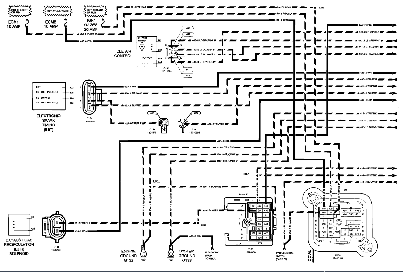

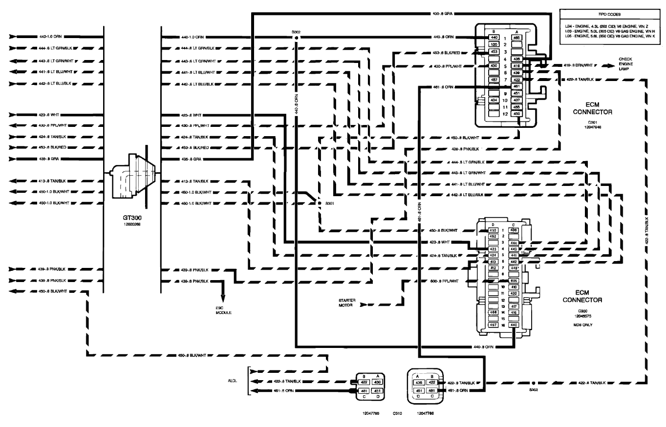

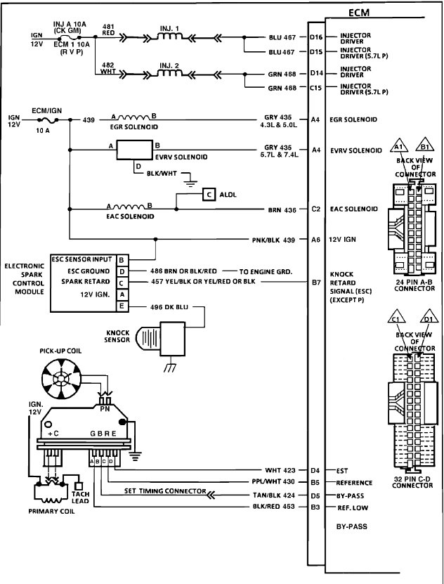

The only way I can get you any pinouts for ECMs is if you have a VIN number for the vehicle the ECM came out of. I understand you're saying it's a bus, but All Data and/or Pro Demand requires a year, make, and model. Or a VIN to get any wiring diagrams, under 1992 GMC Truck there are 22 models listed.

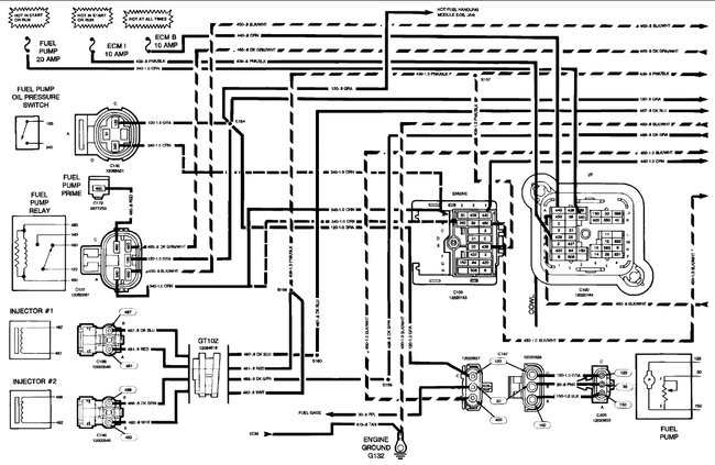

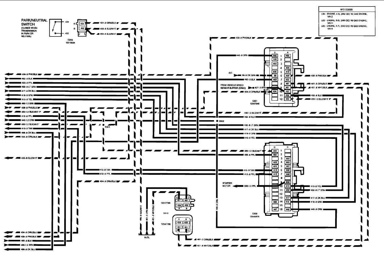

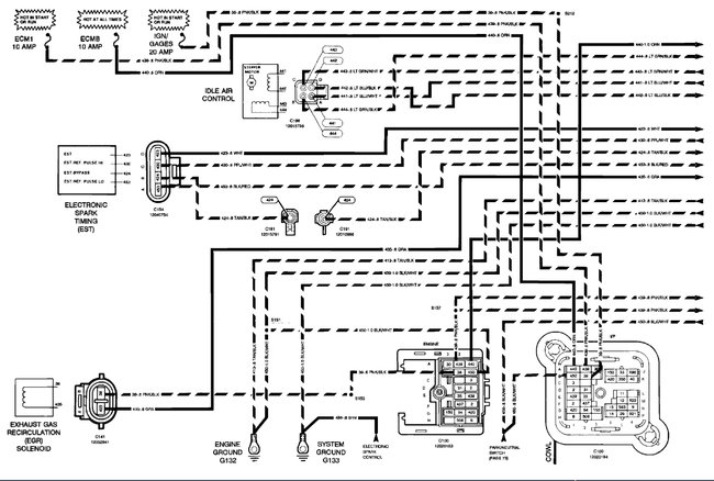

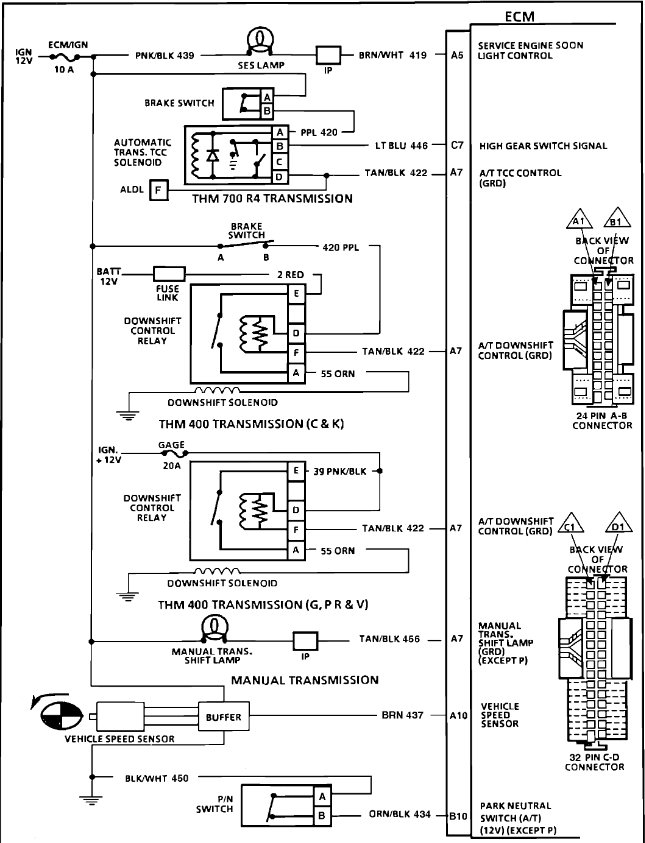

There is listed a 1992 G 1500 1/2 Ton Van, G 2500 3/4 Ton Van, and G 3500 1 Ton Van. Under these three models there is listed for v8's- 305 5.0L, 350 5.7L,
Listed under Chevrolet Truck, there is listed a G-10 Van, G-20 Van, G-30 Van. V8's- 305 5.0L, 350 5.7L, so if you want the G-30 Van, I can get that, but there's no Buses listed.
The ECM pinouts are the older style also, so it listed as ECM Inputs, then a different one for ECM outputs.

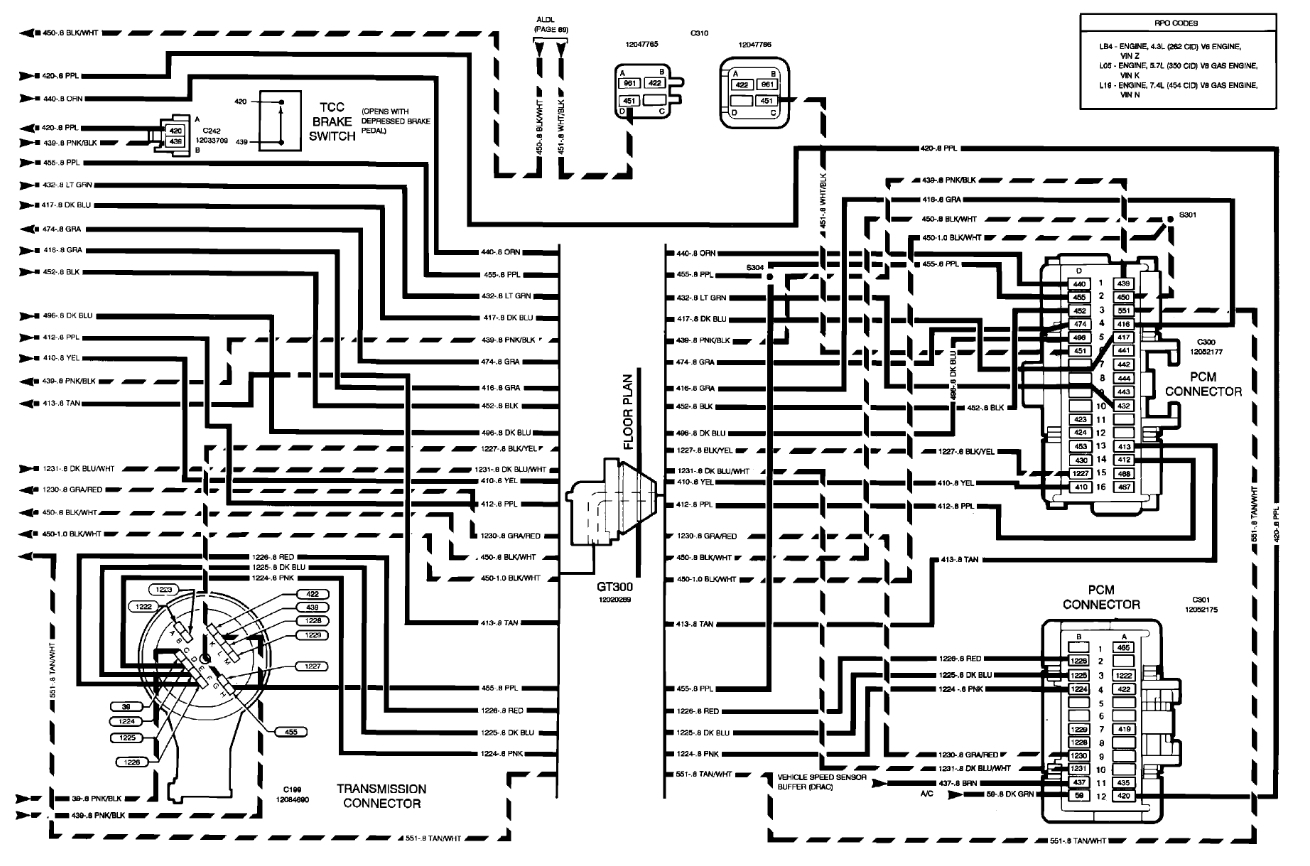

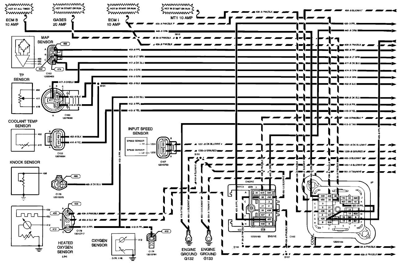

Here are the ECM wiring diagrams for a 1992 G-30 5.7 liter. the other V8's are 6.2 Liter and 7.4 Liter. The first 3 diagrams are ECM Inputs. The last 4 are ECM outputs. These are listed in order directly from All Data, so save the first 3 in a separate folder so they don't get mixed up. I don't know how many pins this ECM has.
Under Powertrain management there is also listed. Fuel Control, Hot Fuel Handling Module, Ignition Controls, Powertrain Controls, Torque Converter Clutch (TCC), Transmission Control Module (TCM), Vehicle Speed Sensor Buffer (DRAC).
So, for example, under Ignition Control, it shows the ignition coil setup, EST Module (Electronic Spark Timing), the pickup coil, etc,. Whereas in the ECM Outputs diagram it will only show the EST harness plug. So, these other diagrams break down each individual system. I'm assuming you will want the Fuel Control extra diagrams as well. Let me know.

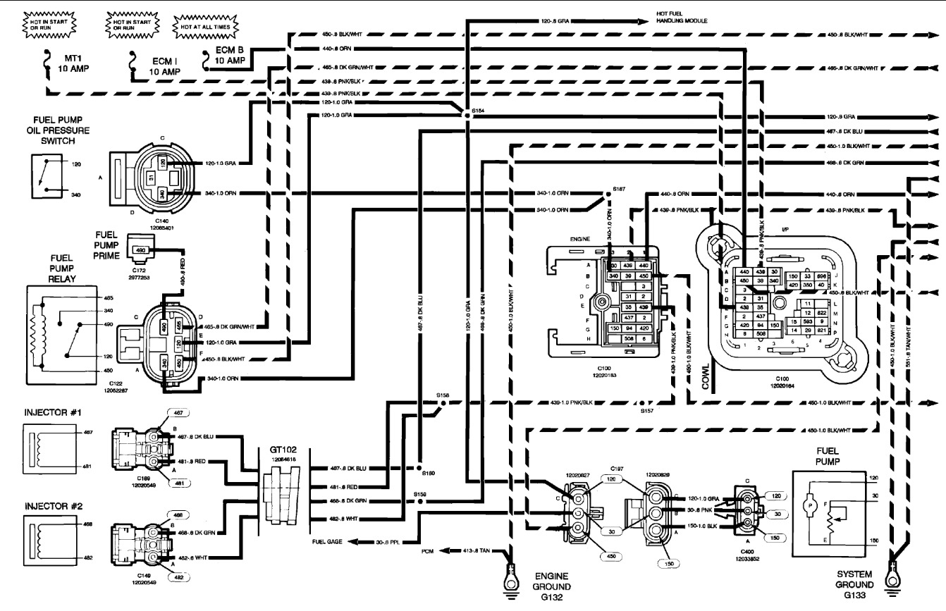

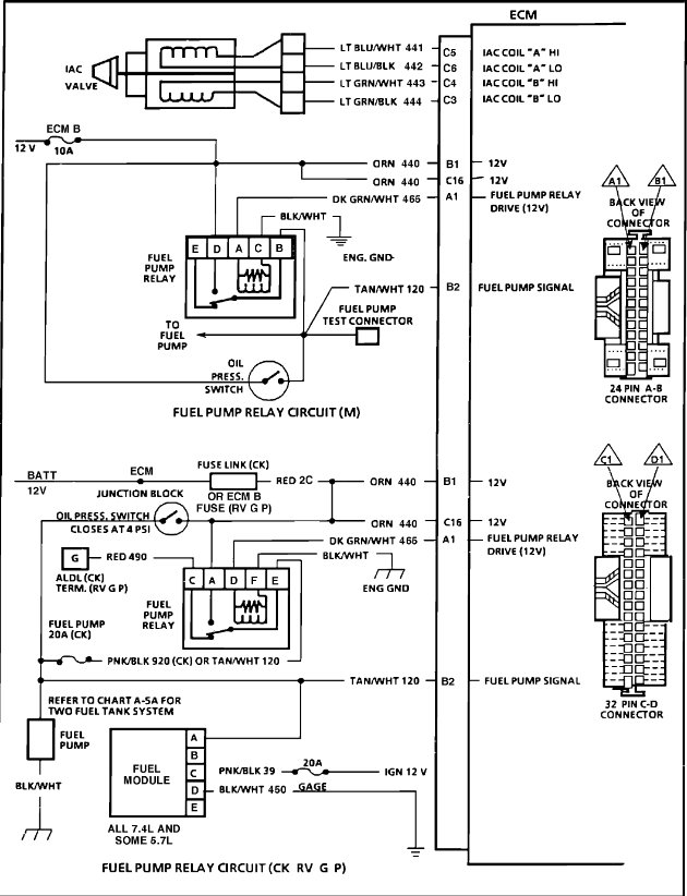

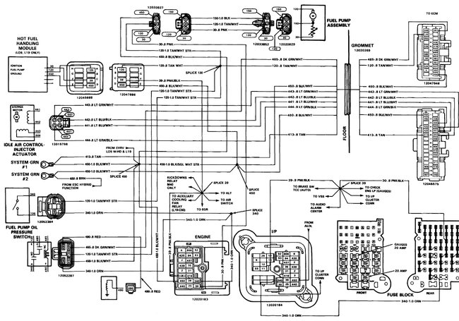

Yes, I need the wiring diagram for the fuel control as well.
Jun 3, 2022 at 6:12 PM
STEVEN GRIBBINS
  • 26 POSTS
Can I even get this bus going without taking it to a dealer to have ECU programmed?
Jun 3, 2022 at 6:14 PM
AL514
  • 5,541 POSTS

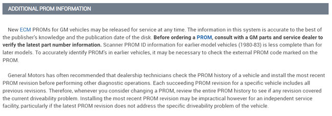

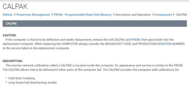

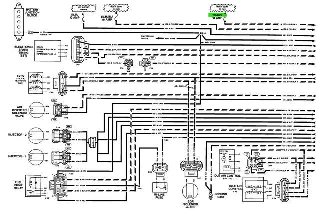

These are the fuel system diagrams, with systems this old, I remember having to change over the PROM chip inside the from the old ECM to the new. Whether it be the PROM, CALPAK, MEMCAL, those chips contain the information about the vehicle, ie engine, transmission, vehicle weight, etc., I'll post the PROM info below. Since you don't have an old ECM to switch any chips over, that's where you're going to have an issue. Unless you can find a company online that might be able to help with programming an older system like this. There seem to be companies doing all kinds of programming these days, but a 1992 is pretty far back. Or you may be able to call and try ordering a chip, give them the year, make and model, and any information off the new ECM, as well as the project you're working on.

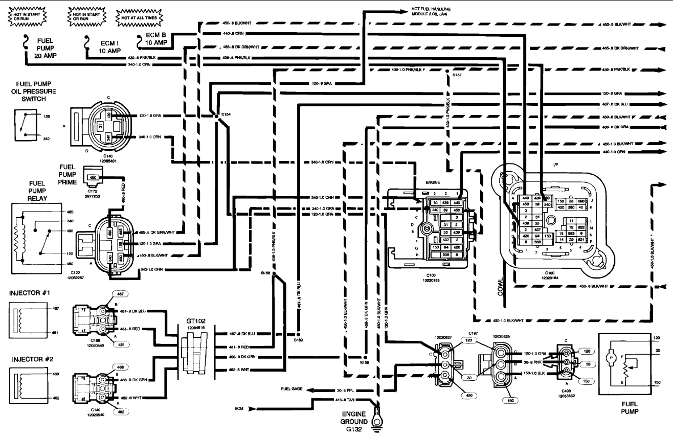

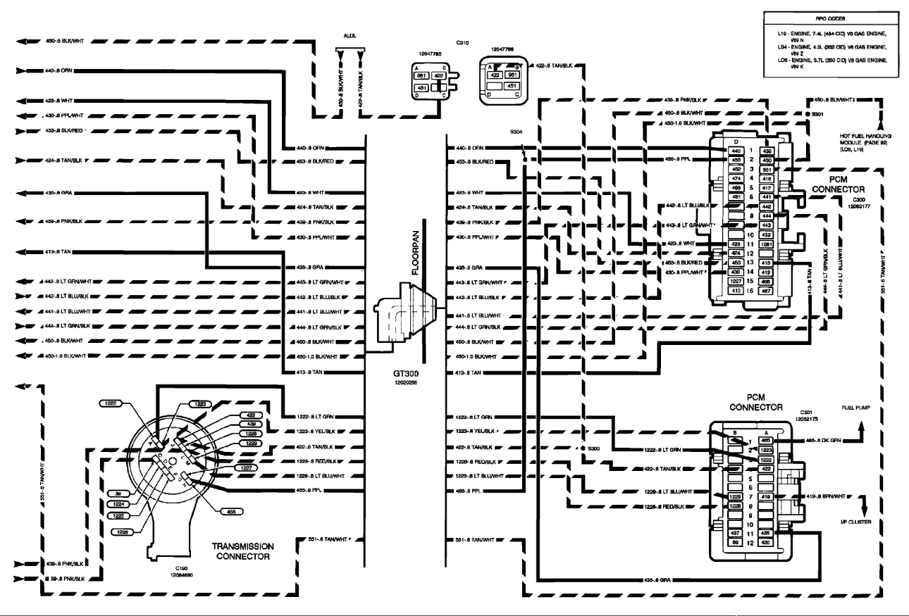

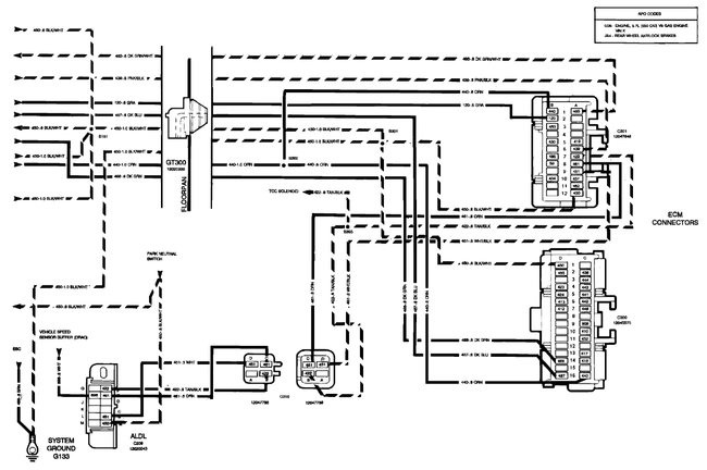

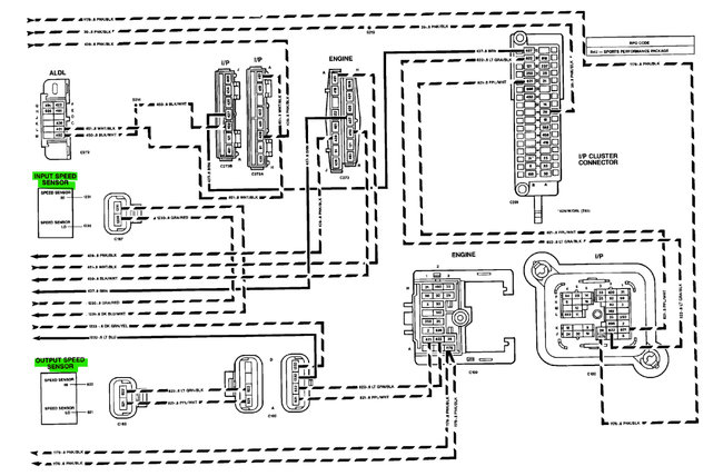

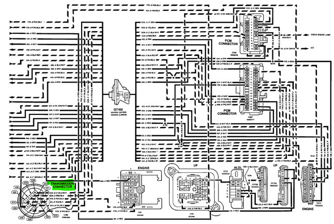

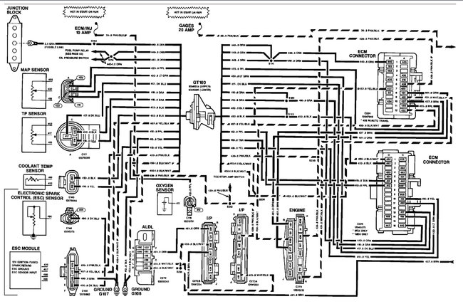

Okay, so, you're asking why the injectors are not getting pulsed? and what year ECM are you working with now? The 1992 or 1988'? and is the 1988 from a G-30 van as well? From the diagrams for the 92' the pickup coil in the distributor is where the timing signal comes from, for example newer vehicles use a crankshaft position sensor to reference timing and then sometimes a cam sensor to reference the #1 cylinder's TDC. So, in a distributor sets up the pickup coil or coils do the same thing. That will be the reference for spark timing and injector pulse.
I did find wiring diagrams for a Chevy G-30 van, 5.0l and 5.7l and actually these diagrams are a lot better than the 1992' ones.
And to check for the timing reference you can put a test light attached to Battery Positive and while cranking the engine touch the test light to the negative side of the Ignition Coil. The ignition coil has 2 circuits built into it. The 2 wires attached to the coil are battery positive and ground. That is the ignition coil's Primary circuit, when the ECM pulses the Ground side (or Control side) of the coil, this induces high voltage into the coils Secondary circuit which the spark plug wire is connected to. So, with a test light attached to battery positive and touching the negative (Ground/Control) side of the coil, your test light will flash, because the ECM is continuously turning the control side off and on to induce the high voltage into the Secondary circuit.
You notice that older models have that wire running to the distributor that has a connector you unplug to set base timing with a timing light. That is the EST circuit. It's the ECMs control of spark timing to the Distributor. When it's unplugged the ECM no longer has control of ignition timing. The ignition control module has control of spark timing then.
These diagrams are the ECM from a 1988 Chev G-30 5.0 liter. Notice on diagram 4 the Pick-up coil and the Ignition Coil + and C(control). This has a separate Electronic Spark Control Module. A common GM setup back then. There are also break down wiring diagrams of each system, Fuel Control and Idle Air Control- Ignition System- Throttle Body Injection (TBI).
5th Diagram is the Fuel Control.

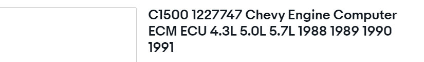

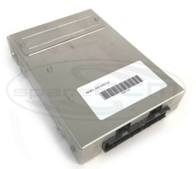

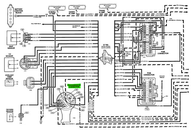

Okay, back to my bus. I've finally learned how to read these wiring diagrams. I needed to just slow down and focus. So, here's where I'm at: I'm trying to wire this ECU to bus the serve number is 1227747 that's the ECU I need to pinout for, or a wiring diagram should I say.
Jun 12, 2022 at 12:51 AM
STEVEN GRIBBINS
  • 26 POSTS
Whoever you are I sure appreciate your help, it's been a lot of help.
AL514
  • 5,541 POSTS

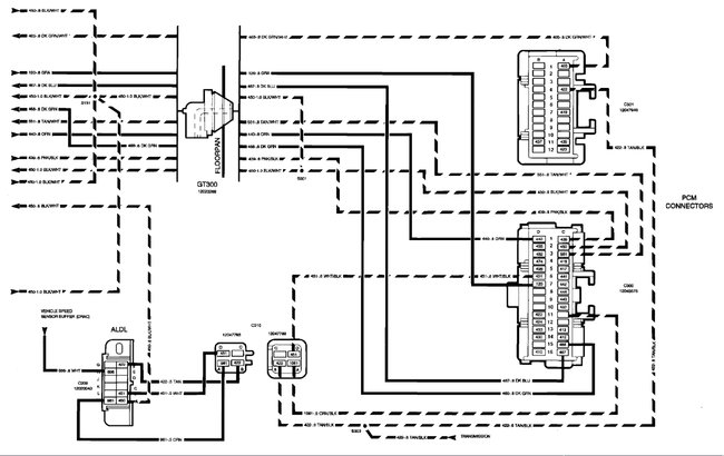

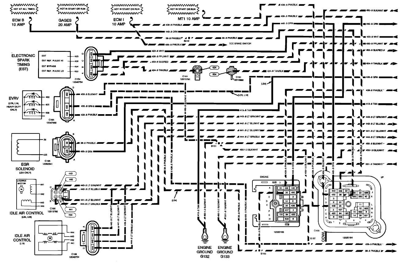

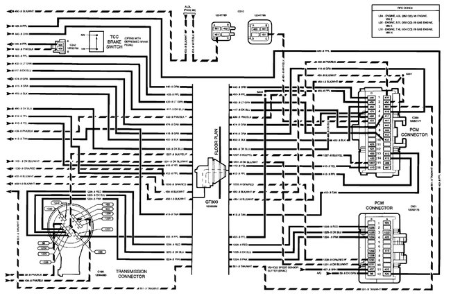

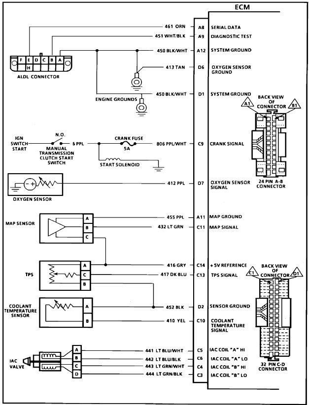

It's all good, that's why we're here. To help people out. As for the ECM, I can't really identify an ECM by is serial number. I'd need to know what the ECM is designed for. Is it for the 1992 G-30 5.7 liter? I did a search on that number for ECMs and came up with a C1500 Chevrolet ECM 4.3L, 5.0L, 5.7L, 1988, 89, 90, 91'.
But just so you know, the engine that will be going with this ECM, needs to have the correct number of teeth on the crankshaft reluctor wheel. Or the correct pick in the distributor if that's what it has for a setup. The ECM is expecting to count a certain number of pulses from the crankshaft position sensor, or it will not trigger the ignition and/or fuel injectors correctly.

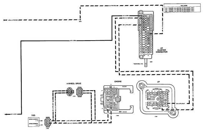

So, i looked up a 1991 Chevrolet C1500 5.0liter, and there are some different options, for example there are diagrams for just the ECM and sensors, then there are diagrams which are more like the whole harness type of diagram. Also, there is listed ECM 1 and ECM 2 but I don't see much difference in the two ECM diagrams. I'll give an example of each one below.
So, pages 1 and 2 are just the ECM by the number you gave. Pages 3 and 4 are just the computer and sensors. No bulk connectors or anything like that, Pages 5 and 6 are the Engine Harness type diagrams.
