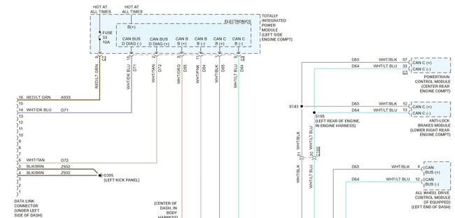

needing a wiring schematic showingh the route along with wire colors i hope you can help please 2013 jeep patriot 2.0
Jan 3, 2026 at 6:27 PM
STEVE W.
  • 15,171 POSTS

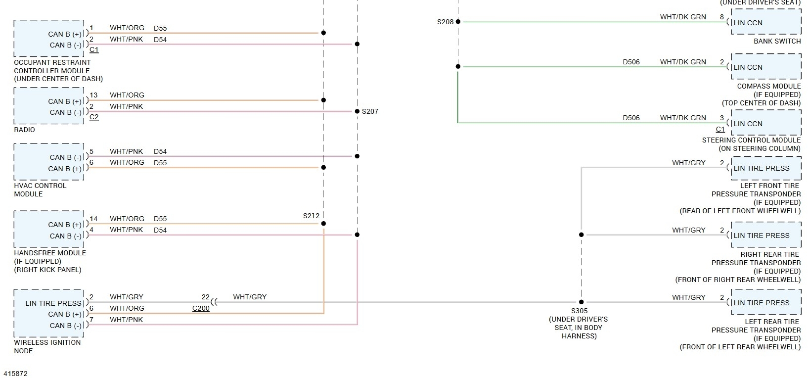

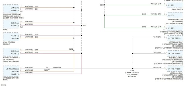

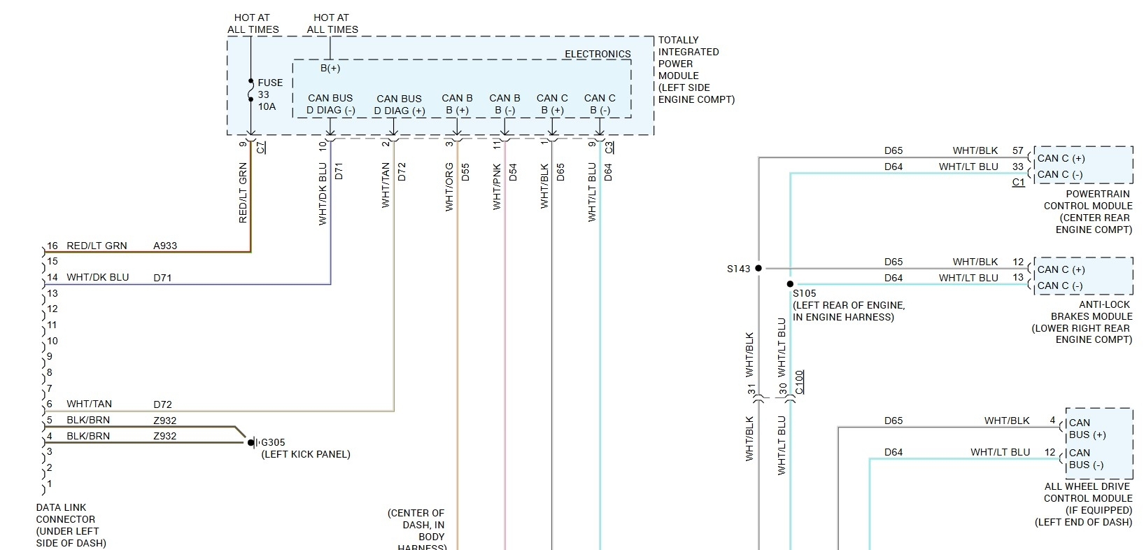

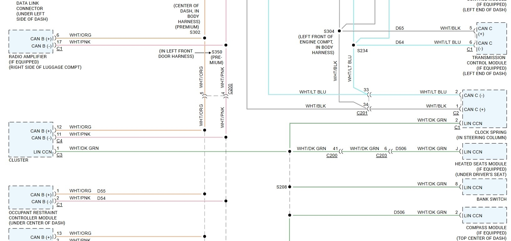

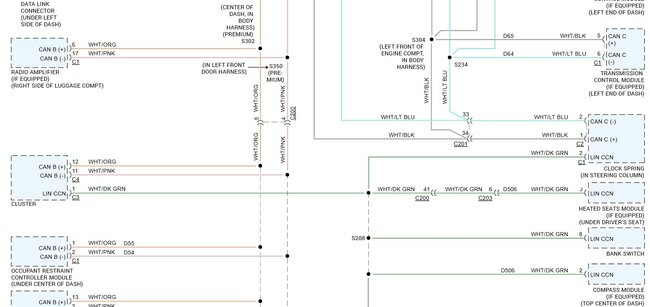

These are the CAN, CAN B, CAN C and the LIN networks in that vehicle. As far as routing, there are buss wires in pretty much every harness in the vehicle. To narrow it down you can determine which network is the issue by looking at the modules on it and what isn't working. Might I ask what the problem is at the moment?
