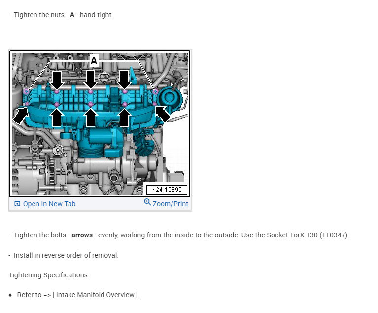

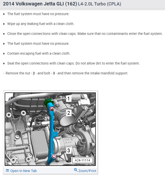

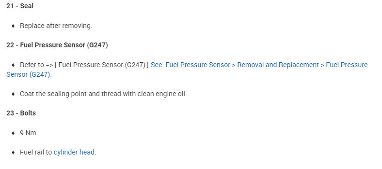

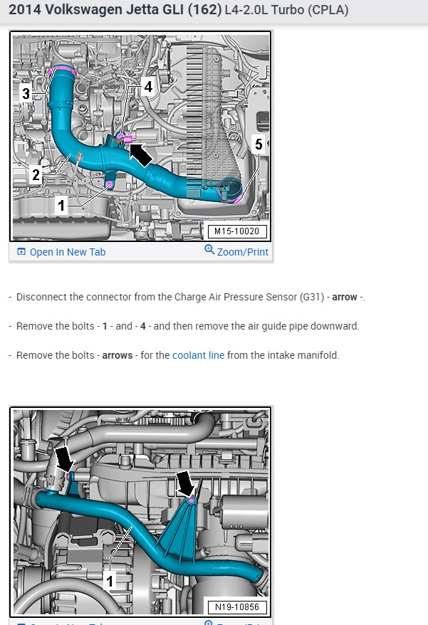

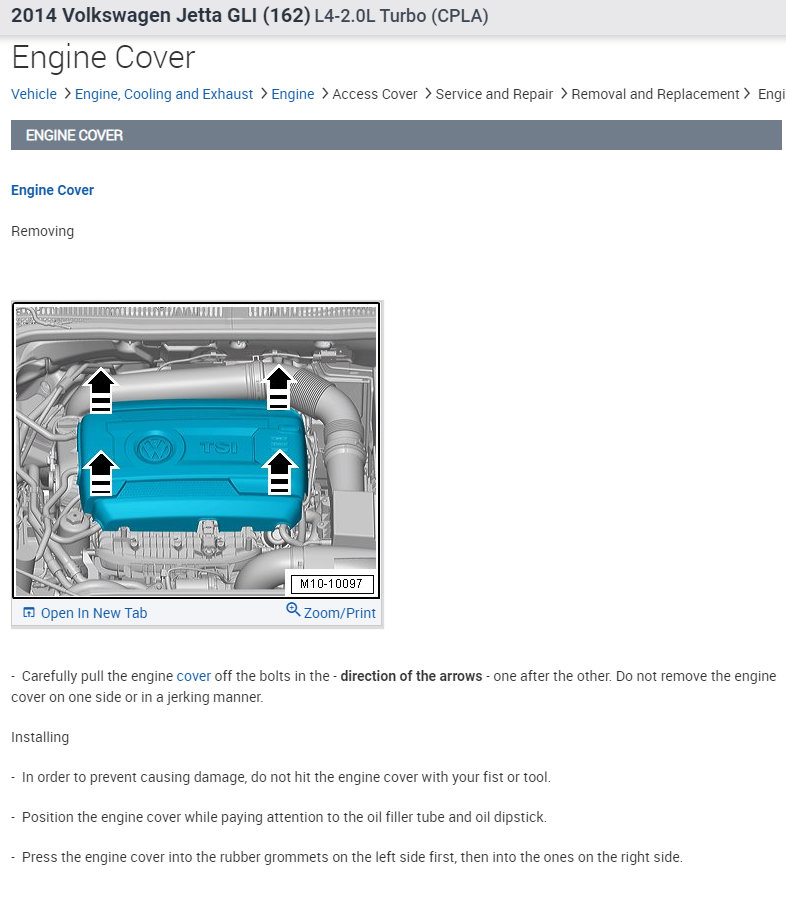

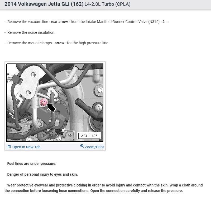

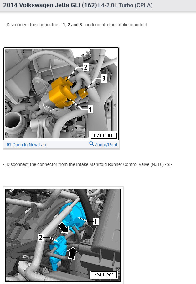

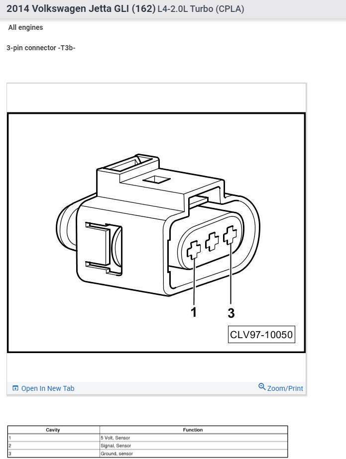

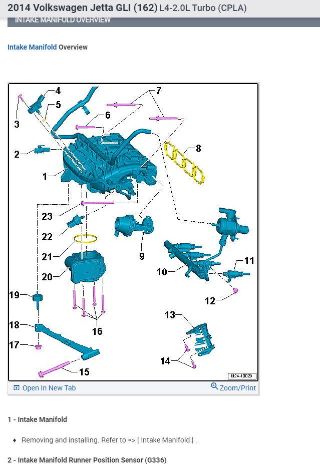

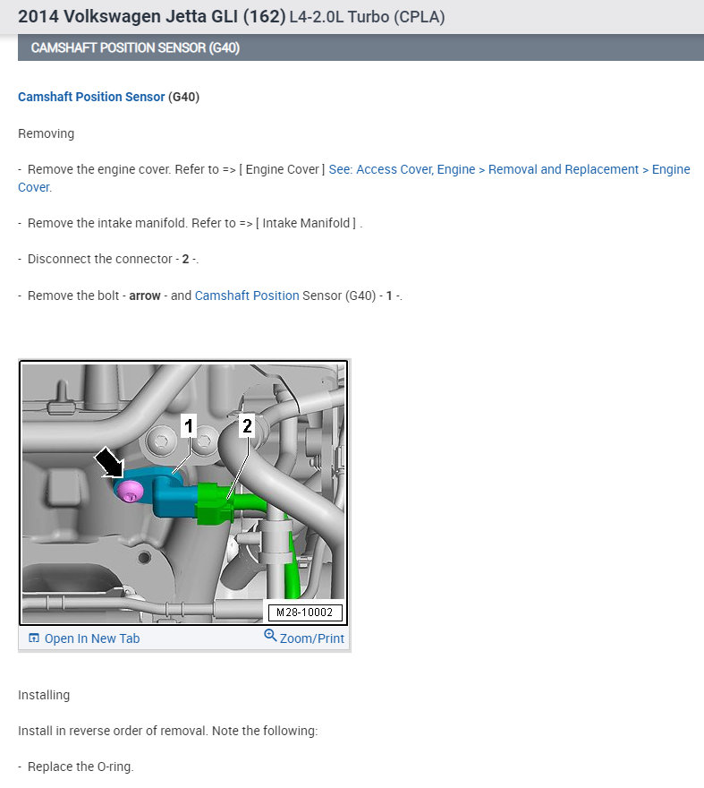

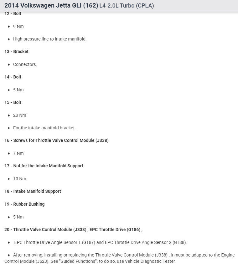

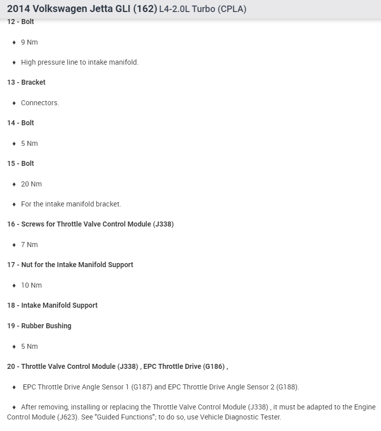

How to replace the camshaft position sensor?
Wednesday, December 29th, 2021 AT 1:10 AM
SQM
MECHANIC
6,383 POSTS

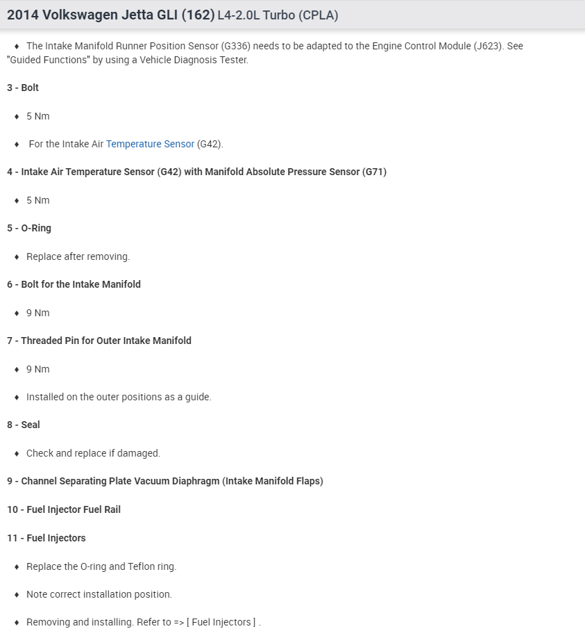

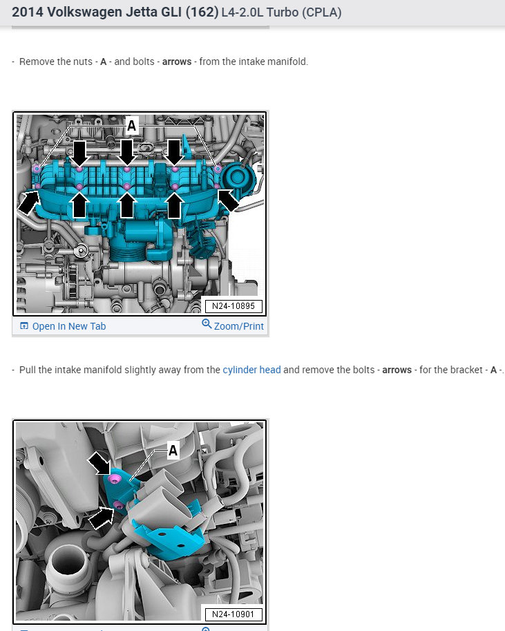

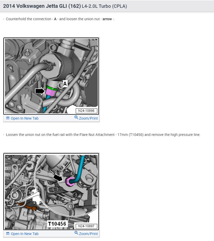

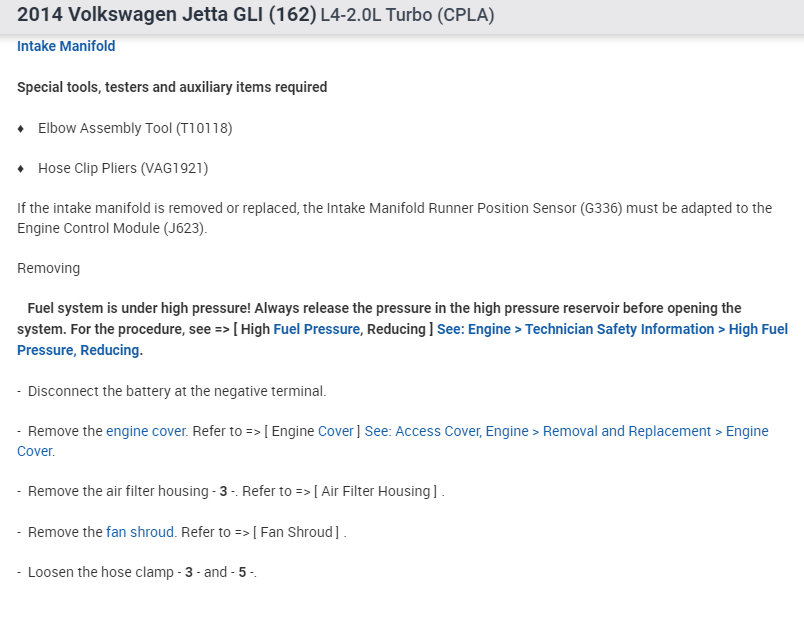

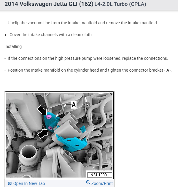

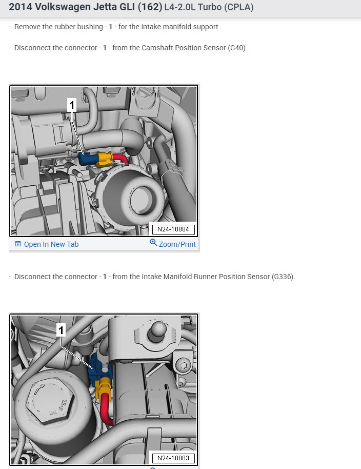

On this vehicle you will have to remove the intake manifold in order to replace the camshaft position sensor.
I have attached the complete procedure below.
https://www.2carpros.com/articles/camshaft-angle-sensor-replacement
