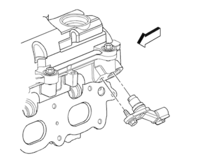

The car just shut off on me when I got to the gas station, and it would start but then shut off immediately. After researching on Google, I unplugged the camshaft position sensor located underneath the engine oil fill and the car started and ran but when I plugged the new sensor in the car started and then shut off immediately. so, I’m not sure where to check for the problem next?

There are two camshaft sensors. It sounds like you replaced the exhaust cam sensor.
Normally, this sensor won't prevent the engine from running. Have you scanned the computer to see if there are diagnostic trouble codes? If not, I recommend doing that first.

Okay, no check engine light but ran it and came up with codes P0014 and P0340. I will disconnect the other sensor and let you know what happens. thank you

Both of the codes are related to the intake camshaft sensor. I have a question, low or dirty engine oil can set these codes. Is the oil clean and full?
Also, the intake cam sensor is on the same side as the spark plugs. Is that the one you replaced?
See pic below.

Yes, I believe so it’s the sensor below the oil fill , and the oil was just changed, would the codes have anything to do with the car starting and running when the sensor is unplugged and not running when plugged in?

The real question I have is if there is something else besides the camshaft position sensor that would allow the car to run when the camshaft position sensor is unplugged but not run when the sensor is plugged in? Because the car runs fine when the sensor is unplugged and won’t run when it’s plugged in.

It could be a timing issue. When it's disconnected, the vehicle will run in a predetermined setting. If the signal from the sensor is off, it could cause it. This can happen from a stretched timing chain.
