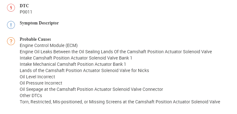

Camshaft Position "A" Timing Over Advanced or System Performance Bank 1. I'm having trouble finding where the sensor is located. I already changed the oil and nothing happened. It cranks but wont turn on.

I found a TSB for this code for re program of the ECM.
I also attached the possible issues. The leading one being dirty oil passages.
