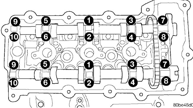

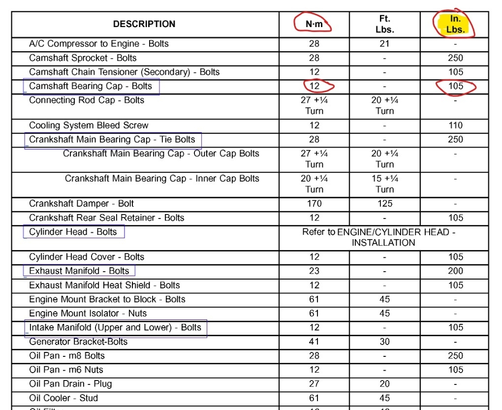

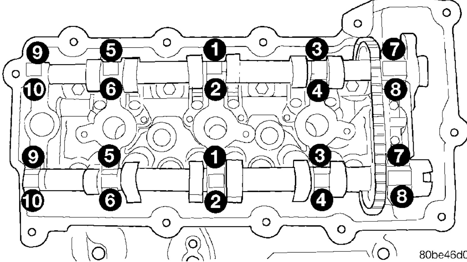

I’m trying to find the torque specs for 2006 Chrysler 300 2.7 v6 DOHC engine
Friday, August 15th, 2025 AT 8:41 AM
STEVE W.
MECHANIC
15,686 POSTS
Those get torqued to 105 inch pounds following the sequence shown.
