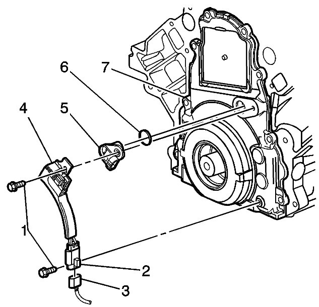

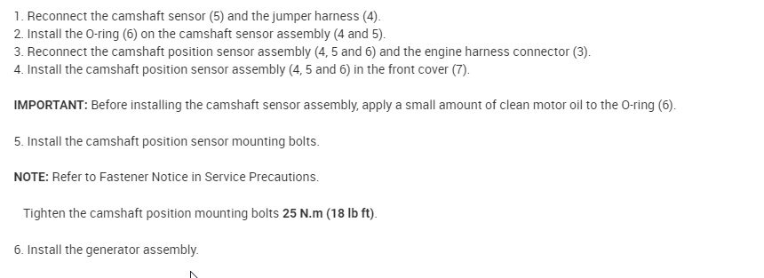

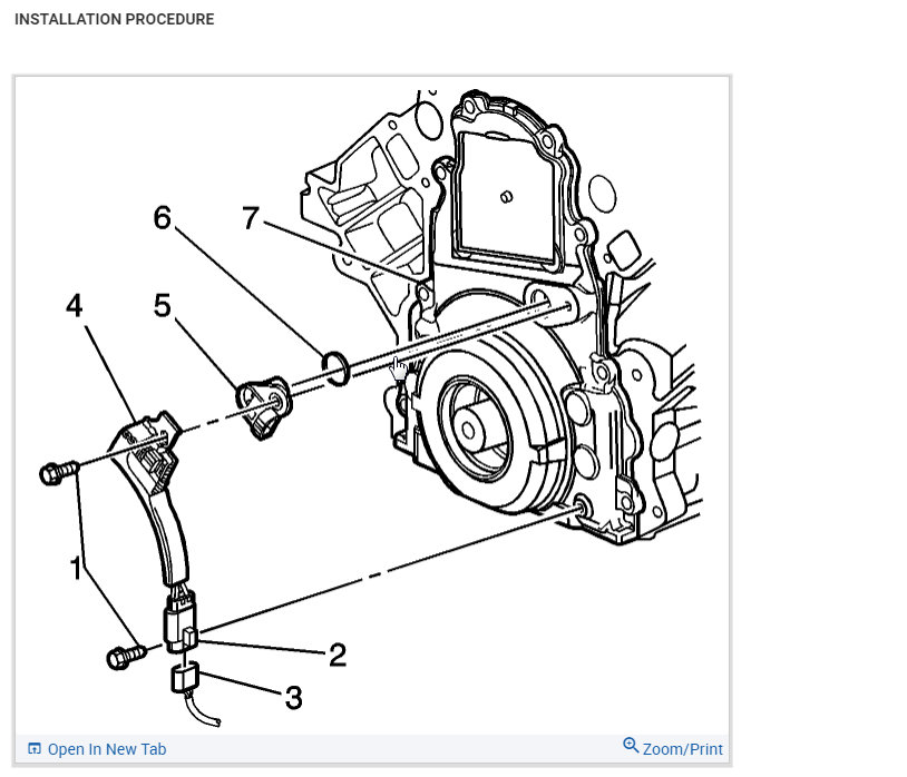

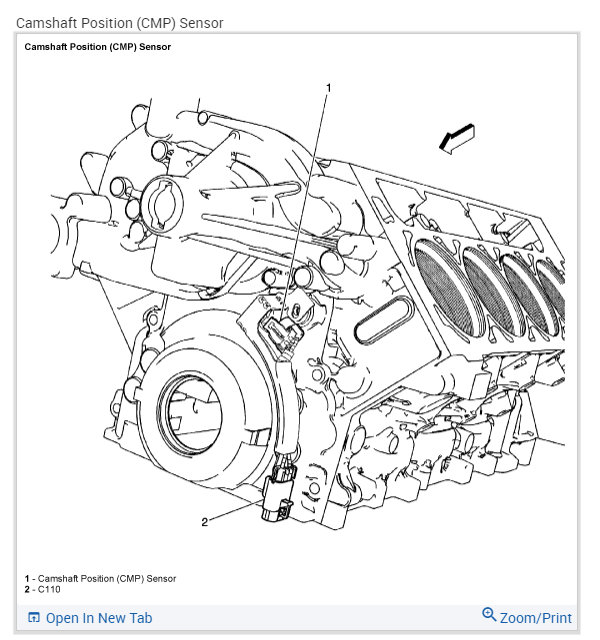

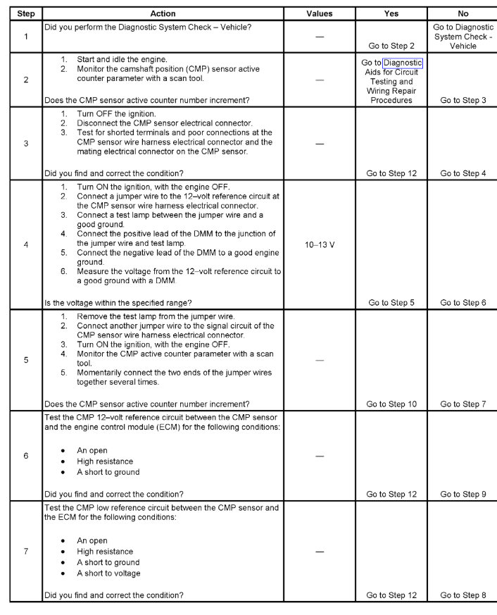

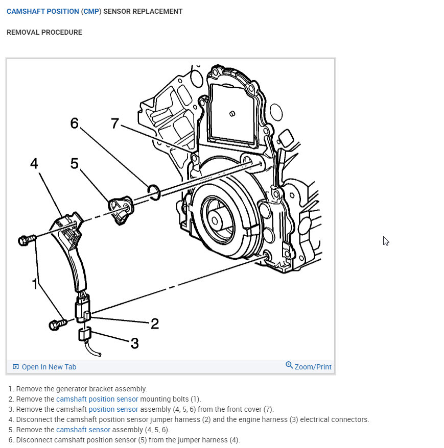

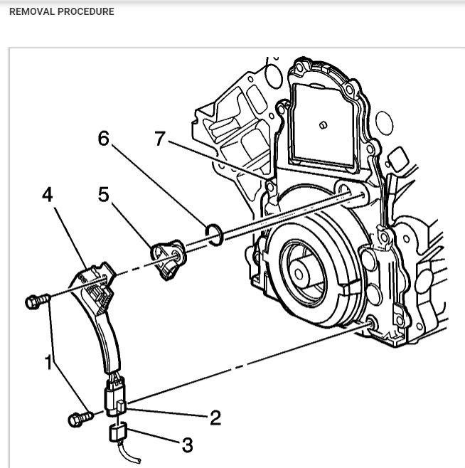

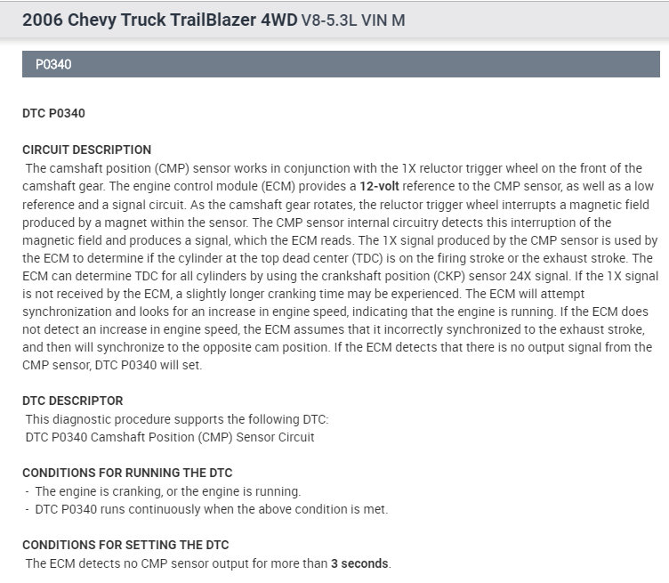

I need to replace the can sensor because I received the P0340 code. I am wondering where the sensor is located and how much trouble is it to replace?
Oct 26, 2019 at 2:22 PM
  • CAR REPAIR CONTRIBUTOR

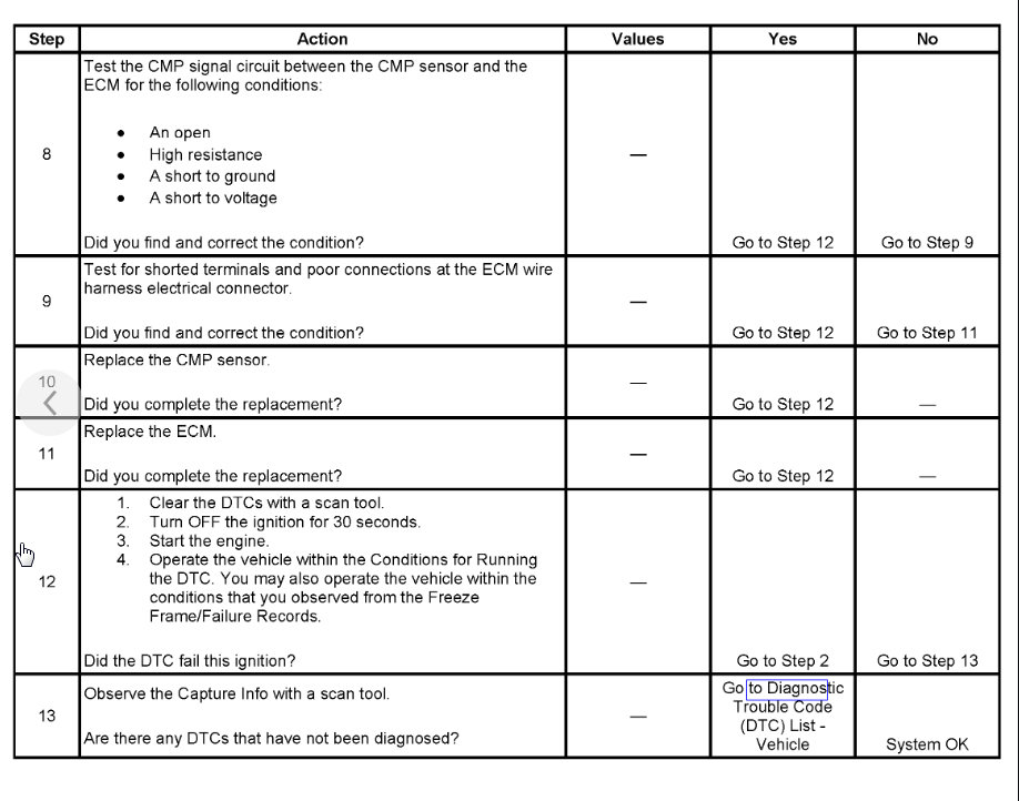

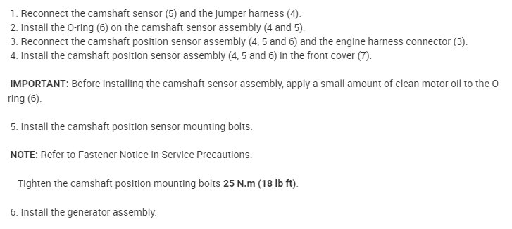

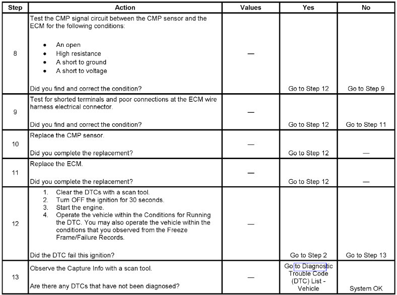

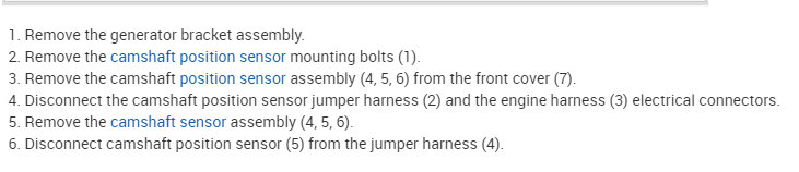

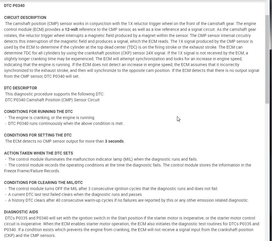

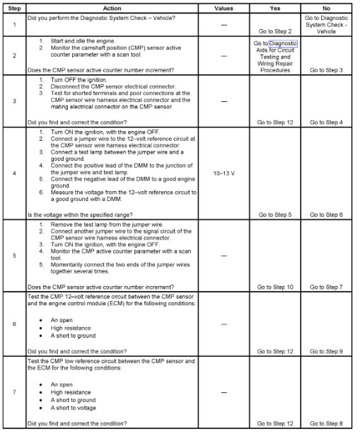

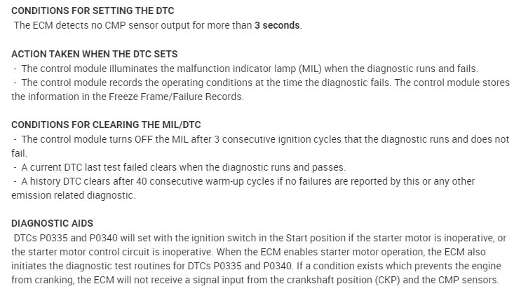

I attached the procedure on how to replace the CMP sensor. I also attached the procedure for this code because there are other causes then just the sensor. If you want to be sure then run through the test and then you can replace it if you confirm it.
Please let me know if you need anything else. Thanks
Oct 26, 2019 at 6:47 PM
DANNY L
  • 5,648 POSTS
Hello, I'm Danny.

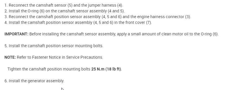

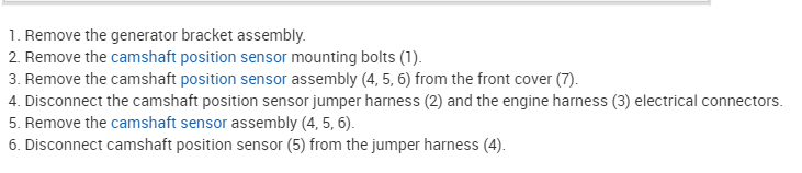

Here is a tutorial for you to view for the replacement on a camshaft position sensor:
https://www.2carpros.com/articles/camshaft-angle-sensor-replacement
For your particular vehicle I've attached step-by-step picture instructions below including the sensor location. I've also attached diagnostic instructions for said sensor.Hope this helps and thanks for using 2CarPros.
