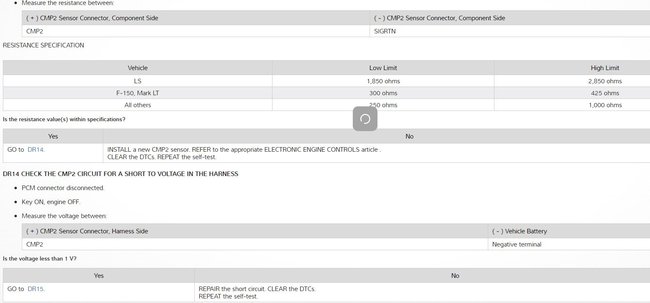

Okay, can you disconnect the plug and check the resistance of the sensor?
+1
Friday, June 8th, 2018 AT 9:09 AM
JIMM1080
  • 21 POSTS
I have to take the sensor out to unplug it. They only give me an inch of wire.
Friday, June 8th, 2018 AT 9:14 AM
PATENTED_REPAIR_PRO
  • 1,853 POSTS
Okay, let me know the resistance before you put it back in too.
+1
Friday, June 8th, 2018 AT 9:16 AM
JIMM1080
  • 21 POSTS
What do you mean by resistance?
Friday, June 8th, 2018 AT 9:17 AM
PATENTED_REPAIR_PRO
  • 1,853 POSTS
The ohm reading using an ohmmeter.

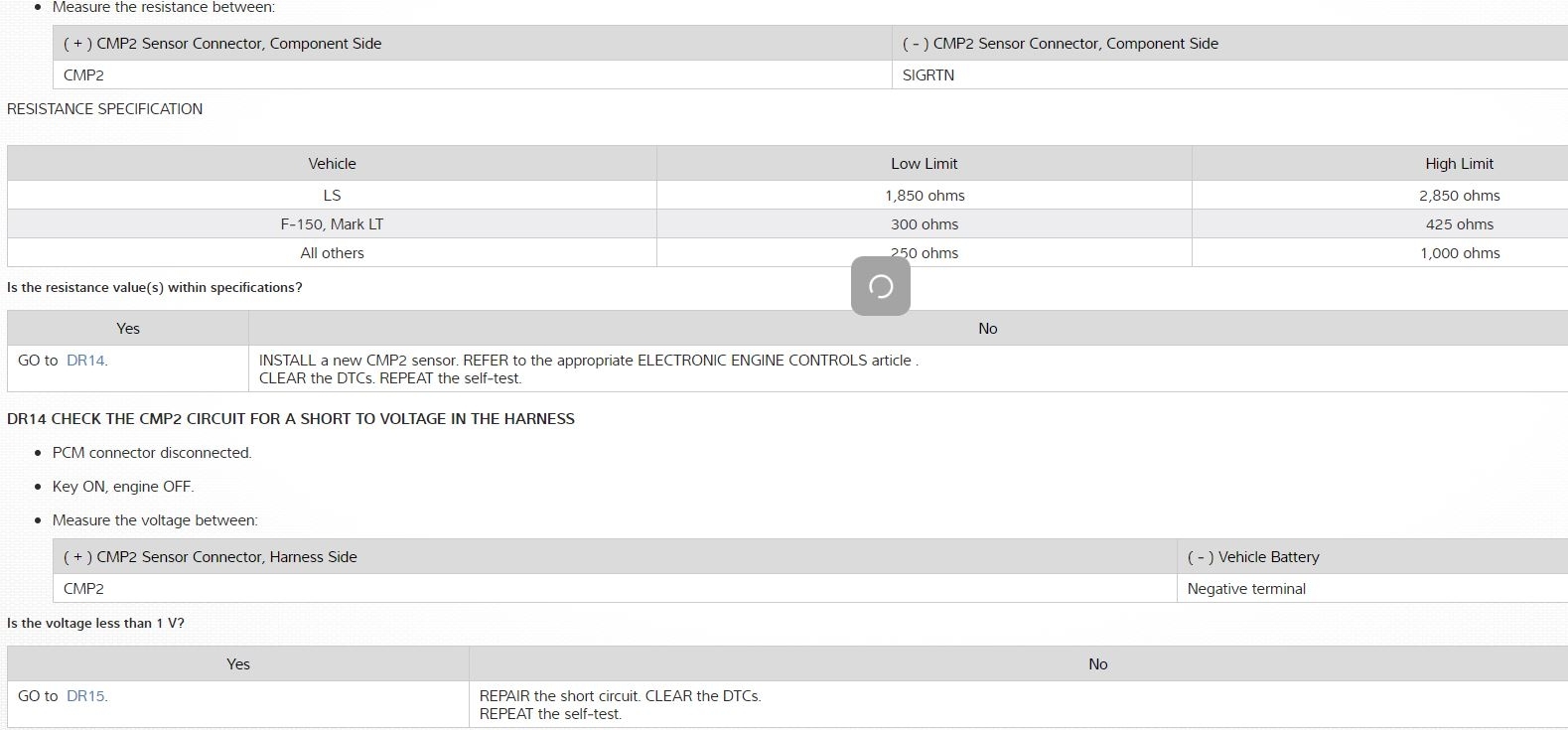

347 ohms. Sorry so late my brother in-law just got home.
Friday, June 8th, 2018 AT 3:04 PM
PATENTED_REPAIR_PRO
  • 1,853 POSTS
That is good, it should have been 250-1,000 ohms, so that 347 is within that.
Next step:
Disconnect the hardness connector at the PCM, so the crank sensor as no connection to it all.
Then using the DV voltmeter check short circuit to voltage on the harness side of the disconnected crank sensor dark blue/orange wire. If this wire is hot when the key is on run, engine off that find and repair the short, where the hot voltage from a positively charged wire is short circuited to this wire.
If there is no voltage present on this wire, like it should be then move onto step 10.
Let me know your answer and I will post step 10.

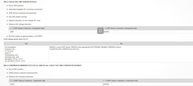

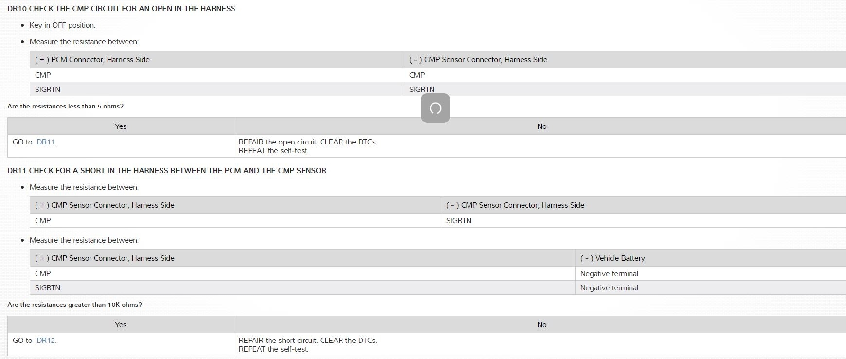

Here are 10 and 11. If you feel okay just having all the steps now then let me know which step you have a problem with or any, I can do that and most likely will anyhow.

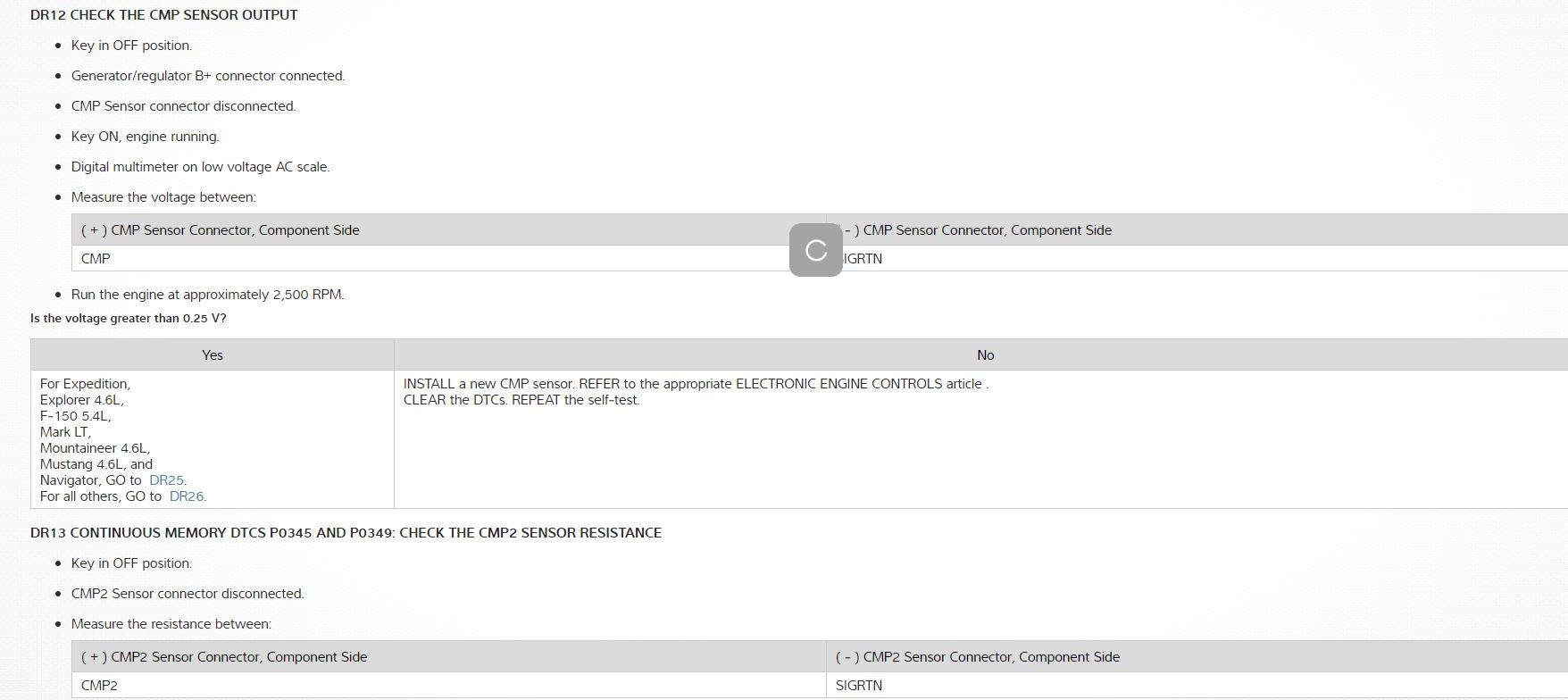

12 and 13
+1
Saturday, June 9th, 2018 AT 2:16 AM
JIMM1080
  • 21 POSTS
Yeah. You can post the steps. If you would like. The more I am reading, I am wondering if the cam syncronizer did not go bad. It would explain a lot of the issues I am having but I am not sure if it would throw a separate code.
Saturday, June 9th, 2018 AT 3:36 AM
PATENTED_REPAIR_PRO
  • 1,853 POSTS
We both know that too much noise could cause that code, remember me asking you if the alternator was too loud. I assume they are close to eachother.
If you wan to just skip these steps and replace the cam synchronizer, go ahead. Is it making noise or anything thing else that you know to convince you is it bad?
Just in case he is 13-14.
