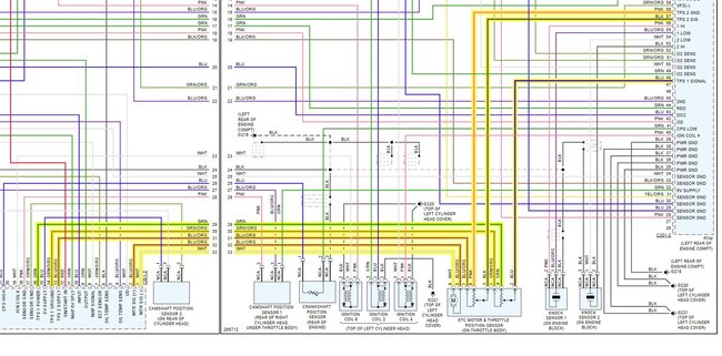

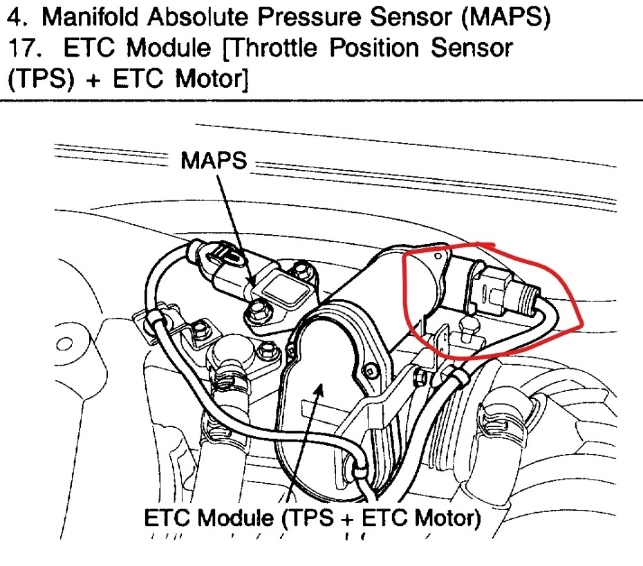

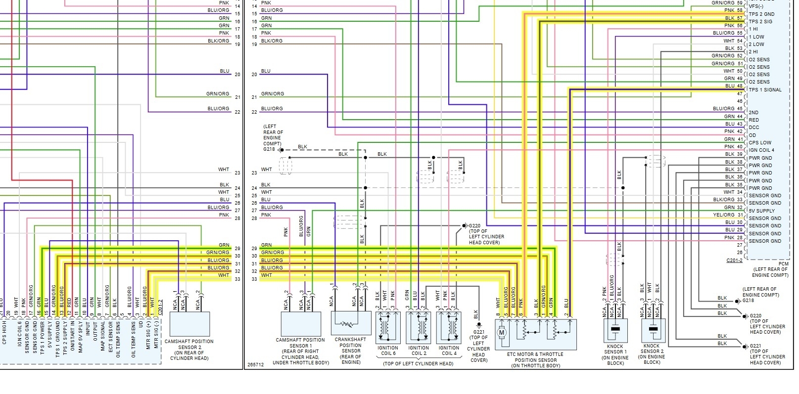

Well looking at the codes in this case all of them point to the throttle position sensor on the throttle body. I would unplug it and check the condition of the pins and connector. With the key on does the throttle work?
P0123 - TPS 1 output high (over 4.75v) for more than .1 sec
P0222 - TPS 2 output low (below .25v) for more than .1 sec
P1295 - Power Throttle Actuator Control System - Power Management Mode (Turn on the MIL if the ECU activates limp mode)
P2106 - Throttle Actuator Control System - Forced Limited Power (Turn on the MIL and activate limp mode)
This is from the service info as well - If P1295 and P2106 occur at the same time, first check ETC items (TPS or ETC motor).
There is also a TSB ( ENG 044 ) about the TPS sensor failing, it's replacement and a software update for it.

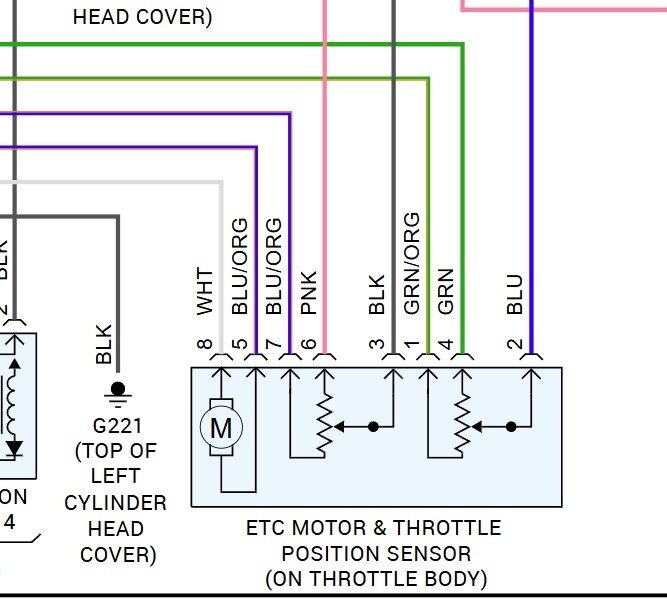

You can but they are a continuous code test. IE- as soon as the relay turns on and sends voltage to the ETC it starts running the code tests. I would check the connection to see if there is any corrosion and that it is seated. While you have it unplugged you could check for powers and grounds. The first image is the wires in the connector. Pins 1,2 and 4 are TPS 1 Pins 3.6 and 7 are TPS 2 With the key on there should be 5 volts at pins 4 and 7. Then you should have a ground at pins 1 and 6.
