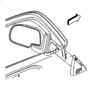

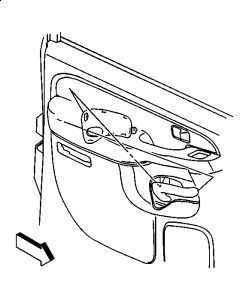

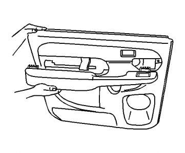

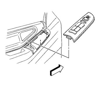

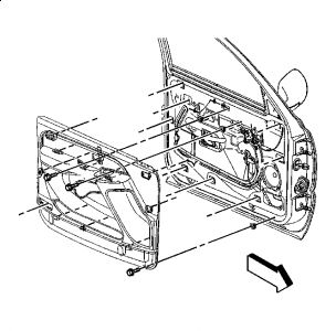

The door lock on the driver's side door fell into the door when I removed the key. All that is left is the hole in the exterior door handle cover.
I cannot put the window down as it hits the lock that is now dangling somewhere inside the door.
I would like to know how to remove the inside door panels to access the lock and assess the situation.
Monday, September 14th, 2009 AT 12:24 PM
DOCFIXIT
MECHANIC
18,828 POSTS
Hi
Follow the diagrams
Handle, switches, arm rest, upper trim then three screws and the rest are plastic clips. Door panel tool would be Very helpful. Thanks for donate
