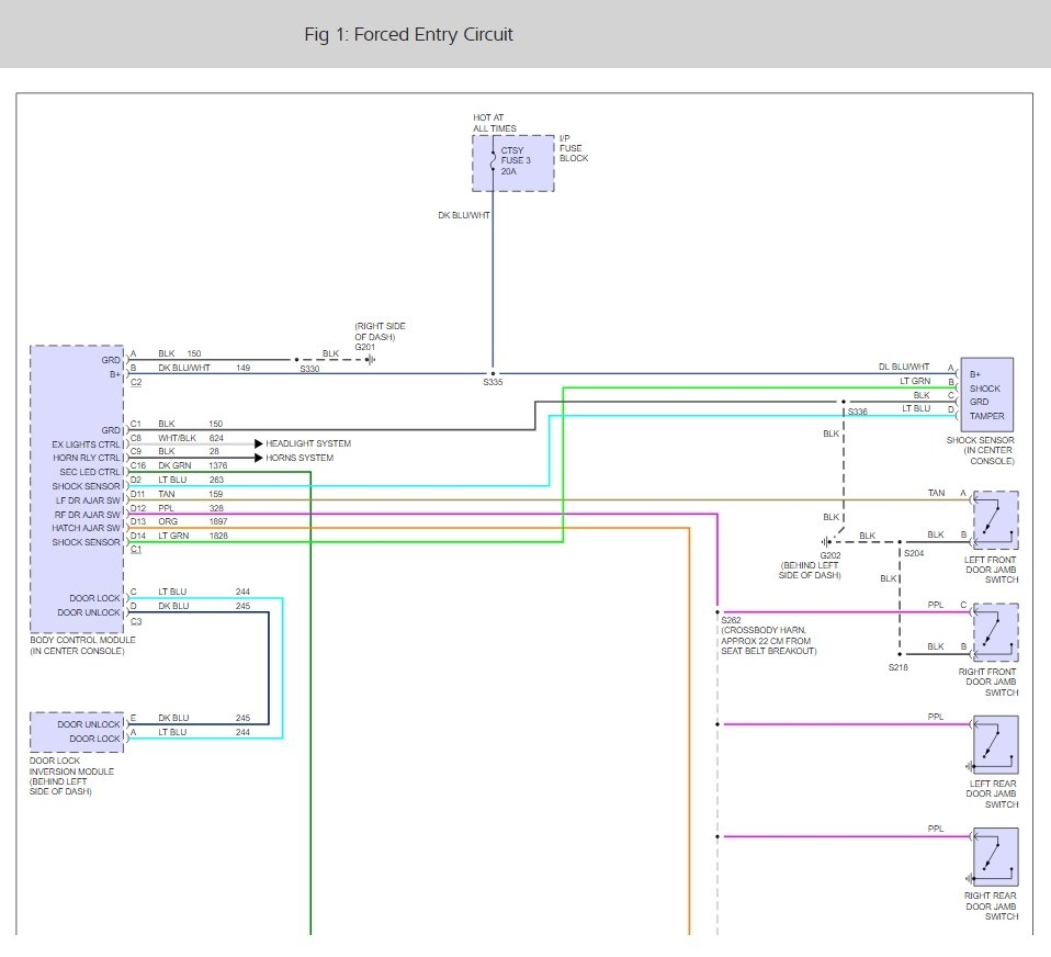

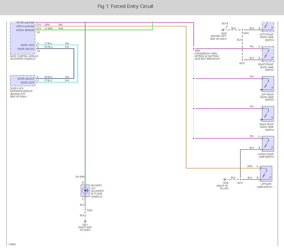

Engine will start when it is cold and runs fine. Seems to burn more fuel, After the engine is shut off, it cranks, but will not start. Security light is illuminated and a ratcheting noise is coming from the throttle body.
Monday, January 6th, 2020 AT 3:54 PM (Merged)
KEN L
  • MASTER CERTIFIED MECHANIC
  • 42,959 POSTS
It sounds like the security module is having a problem, is the light flashing? If so exit the car and roll up all of the windows, then lock the doors using the remote. Let the car sit for 30 minutes and unlock the door and try to start the car.
https://www.2carpros.com/articles/how-to-reset-a-security-system
+1
BYRON KENERLY
Thanks for your response. Are security and ignition modules the same?
KEN L
  • 42,959 POSTS
The security module in integrated into the BCM. Here is a wiring diagram (below)
-1
