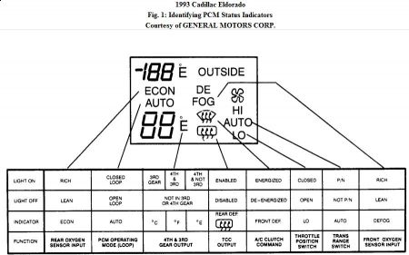

STATUS LIGHTS DISPLAY
Upon entering PCM system level of self -diagnostic mode, indicator lights on DIC automatically
indicate operational status of TCC, certain emission control components and A/C compressor
operation. Operational status of these components is indicated by corresponding status light being
on or off.
https://www.2carpros.com/forum/automotive_pictures/192750_PCM_status93EldoradoFig01_1.jpg
