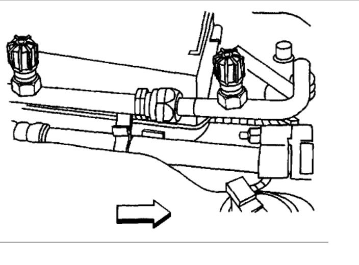

Ok, sorry about the advance.
Can you hook it back up and give us the high and low side pressures while running? Pressures never are a sign of freon level but it will help us in determining other operations

The two service ports are near each other on the refrigerant line headed from the condenser to the evaporator. Here is a diagram and a couple of guides to help you get the problem fixed.

Thanks so much I had the pressure checked an it was very low it took 1 &1/2 cans it blows cold but not as cold as I exspected it was profetionally put in an checked so it was filled with freon to the t I now thats important, at one point I thought there air cut off an back on, on the drivers side, also I still hadnt got the ambient air temp sensor yet its on order, any help would b appretieated.
Tuesday, July 21st, 2020 AT 10:59 AM (Merged)
Ok, what were the pressures?

Lol I dont no the tec did all that I remember below 200 an 42 or something like that.

268 liquid 48sucktion thats what the tech told me I didnt think it was that exact but thats what he said!
Low side is too high. He may have overcharged it or the orfice tube may be clogged with dirt

Ok low side is sucktion or liquid an can u tell me what it should be?

In most cases, it should be 30-35 lbs. The high side should be 2 times the outside temp plus 15%
