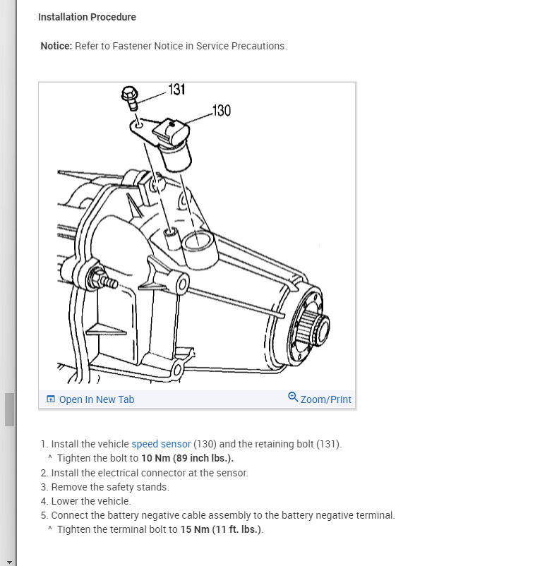

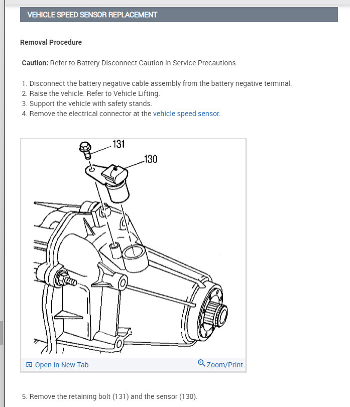

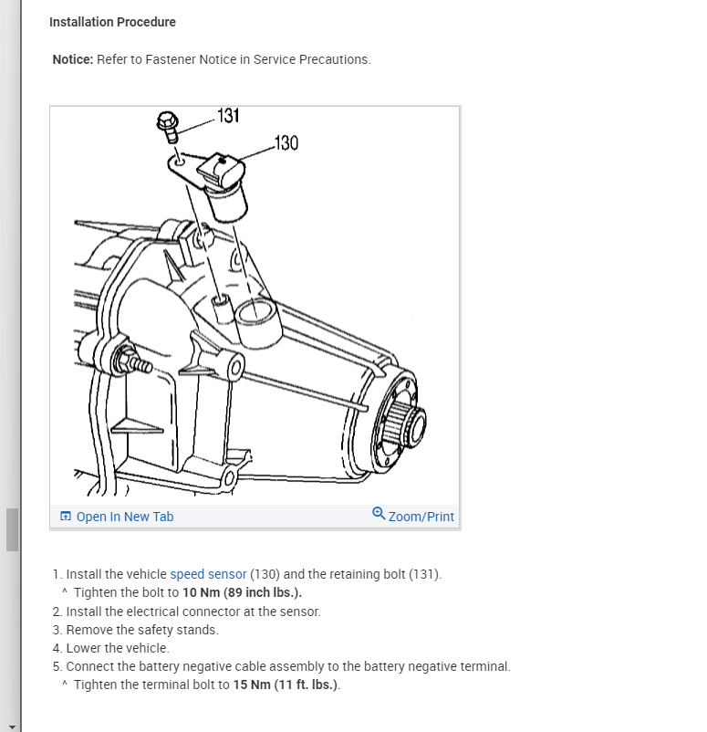

We need to start with this issue by scanning for any codes, but we need to be sure to use a scan tool that can communicate with the ABS system.
Here is a video that will help with this:
https://www.youtube.com/watch?v=rTtAnsOlZU4
Once we know if there are any codes then we will be able to make better decisions however, more than likely there is an issue with a speed sensor on the transmission.
I am attaching the info below on this so let's start with codes and go from there.
Thanks
Friday, November 26th, 2021 AT 3:08 PM
