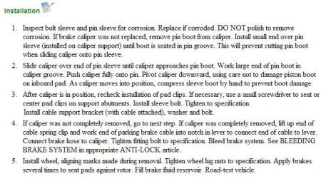

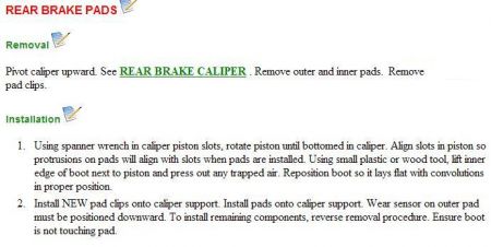

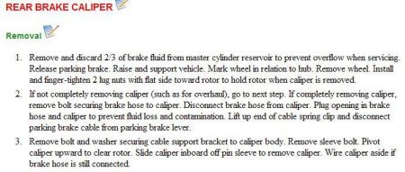

How do I change my rear brakes
Monday, June 22nd, 2009 AT 9:33 PM
BLUELIGHTNIN6
MECHANIC
16,542 POSTS
+2
Monday, June 22nd, 2009 AT 9:47 PM
