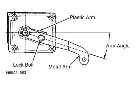

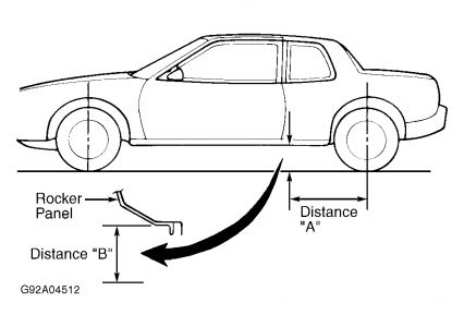

The vehicle bottoms out frequently, more so as passengers are added. I am not convinced it is the shocks (which are extremely expensive to repair). I have checked the fuses and they seem okay. What else can it be other than shocks? I know these car's have some type of controllable air shocks. Thanks in advance.

HEIGHT SENSOR
Park vehicle on level surface. Ensure fuel tank is full and vehicle is unloaded. If necessary, simulate full tank by adding appropriate amount of weight to vehicle (about 7 lbs. for every gallon less than full). Ensure tire inflation pressure is correct. Move front seat rearward. Turn ignition on to activate ELC system. Bounce rear of vehicle 3 times to normalize suspension.
Measure rear ride height. See REAR RIDE HEIGHT . If rear ride height varies by more than 1/2" (12 mm) from side to side, or is lower than specified, repair suspension problem before continuing procedure. If ride height is as specified, height sensor is adjusted.
NOTE:Height sensor arm assembly can be moved a total of 5 degrees. One degree of change at height sensor arm assembly results in a 1/4" (6 mm) change in height at rear bumper.
If rear ride height is not within specification, loosen lock bolt on sensor arm. See Fig. 1 . To increase ride height, move plastic arm upward. To decrease ride height, move plastic arm downward. Tighten lock nut.
Fig. 1: Adjusting Height Sensor
https://www.2carpros.com/forum/automotive_pictures/266999_cad_1.jpg
REAR RIDE HEIGHT
Mark a spot on bottom of rocker panel, 22 3/16" (563 mm) forward of rear axle center line (distance "A"). See Fig. 2 . Measure distance between marked spot and ground (distance "B"). If vehicle is on hoist, consider ground line to be horizontal line between bottom of front and rear tires. Distance "B" should be 7 9/16 - 8 11/32" (192-212 mm).
https://www.2carpros.com/forum/automotive_pictures/266999_cad1_1.jpg
