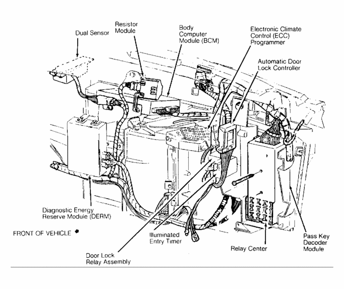

My devilles digital information lights, fuel center data, climate control center, speedometer and mileages, etc, all of a sudden quit working. We have checked all the fuses, and they are all good. However we have not checked and of the fuses or relays that are found behind the right sound insulator. According to the fuse panel, it should have been fuse 7, which also controls the AC, but even though the climate control center digital lights are not working, the AC will still turn on. Is there something else we can check or do to locate and fix this problem? Without the fuel center data digital readout lights working, I have no idea of how much gas is in my car.

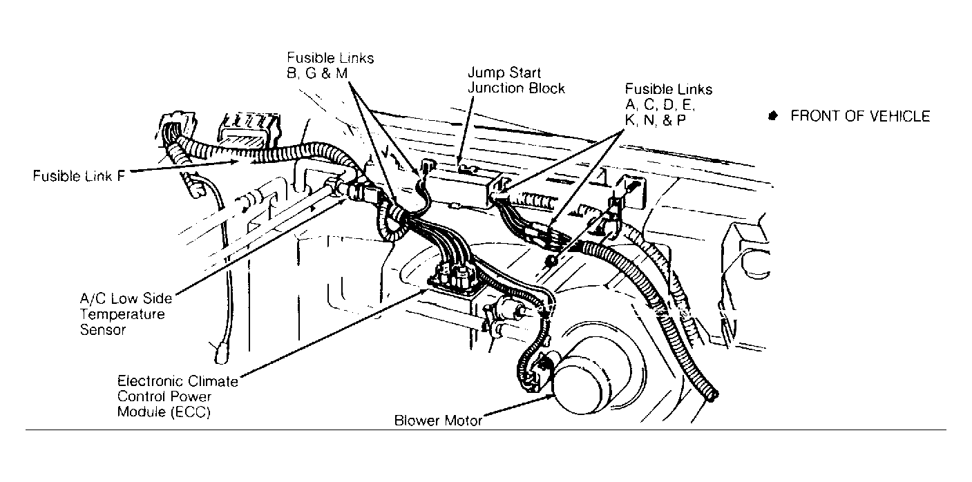

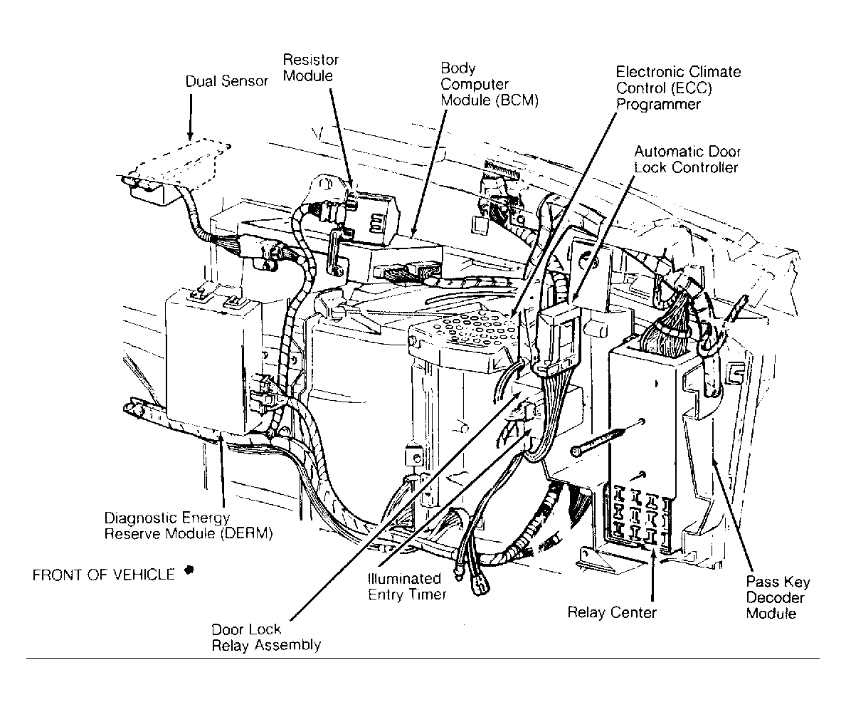

RIVERMIKERAT
  • 6,110 POSTS
There's a relay block behind the far right side of the dash to the right of the glovebox. Also look at the images I have attached.
