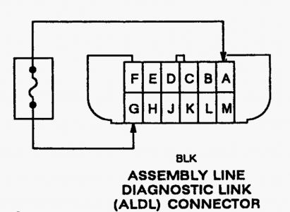

FACTORYJACK
  • 4,159 POSTS
Possibility hat the ignition cylinder wiring for the theft system has opened, and a valid key value is not being received. Proper repair is replacement of the cylinder with new keys, but there are other options available. Try this guide to reset it

FACTORYJACK
  • 4,159 POSTS
I would first check all DTC's by pressing off and warmer on the climate panel. Record and report all DTC's shown. Another check would be the resistance value of the ignition cylinder with the key installed. This would be done at the electrical connector at the base of the column, the two white wires that come out of an orange conduit are the ignition cylinder VATS wires. Check with an ohmmeter, while rotating the cylinder in all positions. It should display the same value as the key pellet, in all positions. Never should it read open circuit, if so you have a break.

WRENCHTECH
  • 20,758 POSTS
You can't bypass the entire system. It has to remain operational, however you can bypass the most common failure item.
The most common failure in these is the sensor in the ignition lock that reads the key pellet. That would mean replacing the ignition lock with a sensor included.
That sensor can be bypassed. You would need a digital ohmeter to measure the resistance of the pellet in the key. Now go to Radio Shack and buy a resister of the exact same value as the key pellet. Go to the base of the steering column and locate the two thin white wires that go up to the sensor. Cut the two wires and solder the resister between the two ends coming from the harness. This will permanently bypass the sensor but not the rest of the system.

FACTORYJACK
  • 4,159 POSTS
You can either buy a new lock cylinder, place a good key in it, and plug it in to the harness leaving it under the dash until it can be installed. Or if you know the resistance value of the key pellet, obtain some resistors of the same value and bridge the harness side of the connector simulating a good key. Then any key with the correct cut would start it.
