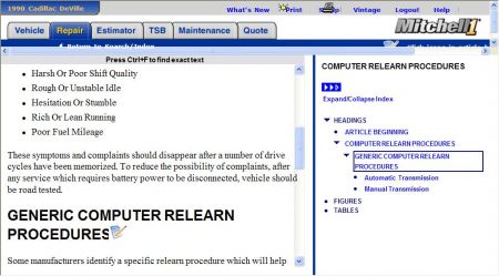

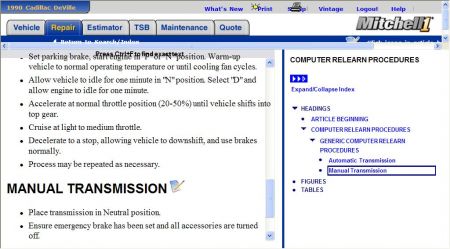

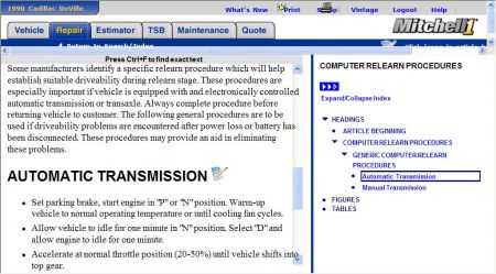

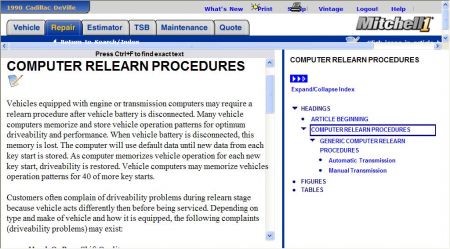

Try relearning procedures below
https://images.2carpros.com/forum/automotive_pictures/12900_c1_2.jpg
https://images.2carpros.com/forum/automotive_pictures/12900_c2_2.jpg
https://images.2carpros.com/forum/automotive_pictures/12900_c3_2.jpg
https://images.2carpros.com/forum/automotive_pictures/12900_c4_1.jpg
