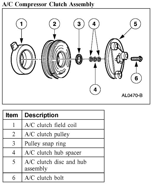

Just want to bypass it because I do not want to spend any money on this vehicle. I just want to see if I can keep it running. Compressor has been replaced twice before I got it. It is making a lot of noise and I think starts seizing up after driving for a while. It could be something else causing the problem, but it sounds like the A/C compressor area.

Unplug the electrical connector to the clutch. Then see if it acts better. That would let the pulley act as just an idler and the pump won't try to run. If the clutch bearing is bad you can usually tell easy, Take a long stick and put it on the pump with the engine running. Put your thumb over the end and put it in your ear. A bad bearing will sound like dragging a metal pan on gravel, a good one sounds like wind through a hole.

If the clutch bearing is bad, then I would still need to fix it or bypass it, right?

If the clutch bearing is bad then yes, you would want to remove it in order to have room for the belt. Or replace the bearing. National 5106WCC looks to be the number, runs about 20 bucks. Not hard to replace either. Remove the front hub, dig out the snap ring, press out the bearing and press in the new one. Reinstall and put the snap ring in place. You wouldn't need to install the hub if you don't want to use the AC.
