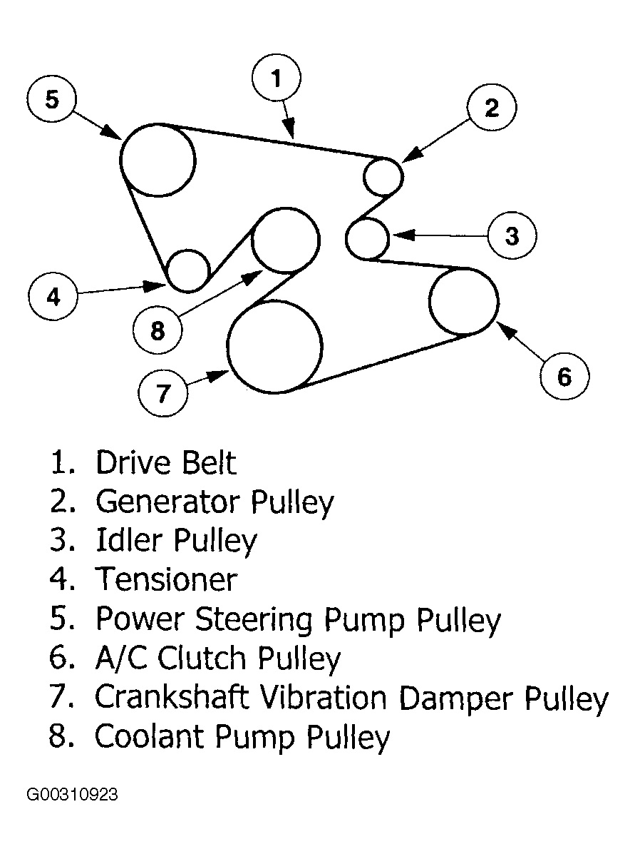

I desperately need a diagram for the serpentine belt as quick as possible

Here you go! Thank you for using our site!
Image (Click to make bigger)
