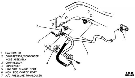

i need help in locating the low pressure valve on my buick. It needs to be recharged.

Service Port HVAC
A/C Hose Routing And Service Port Locations - 2.4L
https://www.2carpros.com/kpages/auto_repair_manuals_alldata.htm
